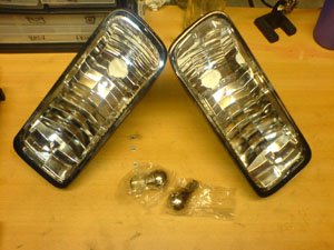

Got some new pictures from my install of clearglass

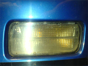

Old one, seems little "used"

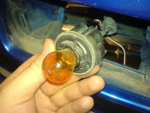

Old buld

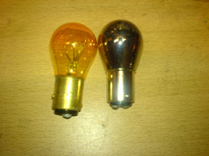

New buld to the right (chromeplated)
