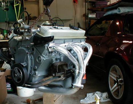

Jeff is right about the fabrications. The included instructions are breif but explain it all. You can also use pipe from a hardware store for the spacers. DO NOT use the supplied gaskets, they're about as usefull as a 5" tip on a civic. Mine are the ceramic coated ones, here's a pic:

Originally posted by Gunny Highway
I don't get itwhat's the deal with modifying the AC?? Why?
Gunny, While in the process of an engine tear down on my '86 T/A I noticed that part of the a/c bracket is mounted out away from the head on a exhaust manifold bolt. Those manifold bolts have to be replaced with header installations it appears, because the header flanges are much thinner. Therefore to retain the spacing for the a/c bracket, one can take note of the distance, and fabricate a spacer to use with that original exhaust manifold bolt when switching to headers
Old Jul 8, 2002 | 09:44 PM
RICHRAD's Avatar
Posts: 675
From: kentucky
Dustin, what kind of headers and y pipe are those.....I like the shine!. Also , will you have to remove those ,then reinstall to get the motor back in?
Those are the Ceramic Flowtech headers. Those are the same as what I have on my IROC. It's definitely a lot easier to install engines without the headers on them.

iroc22 is correct, they are the flowtech ceramics.
The pic was taken right before my engine was dropped in. I had them on just to make sure they fit and to get a shot of them outside of the engine bay. We didn't have either side on when the engine actually went in.
Don't worry about the fabrication needed to install these guys, it's nothing that you couldn't do with a hacksaw; and the bracket will still work on a stock application.
I got them from nextgen for $369, but chances are you can find them for cheaper now (this was over a year ago).

My Y pipe was black when I got it. Did you sand it or something?

nope, that is what it looked like right out of the box.

Oh well, its not a big deal to be painted anyway, since it went like yours in a matter of days.

Tell me more about the Flowtech Header.Is the primary pipes size 1 5/8 or 1.5.I have a new 350 in a 84-Z with a 700r tran.These header look good in the pictures but are to small for a 350?Or do thay come in diffrent sizes?The 350 has a Edelbrock intake,Holley 650 carb.Comp cam 262,Accel Dist and some head work.Runing the stock exhust now.Diffrent camaro with 350 in.Had LG4.
Old Jul 15, 2002 | 08:50 PM
  #43
ShiftyCapone's Avatar
Supporter/Moderator
Posts: 13,778
Likes: 567
From: Cincinnati, OH
Car: '90 RS
Engine: 377 LSX
Transmission: Magnum T56
they are 1.5 primaries. For your motor I would at least go with 1 5/8". You could get by with 1.5" but you would lose a lot of upper end power I would imajine. You would have killer low end though.
Old Jul 16, 2002 | 03:07 PM
  #44
RFCamaro28H's Avatar
Joined: Mar 2000
Posts: 49
From: Smithfield RI
Many Thirdgen use Hooker 2055.Can you get a Y pipe for those headers?And plan to run 3in all the way out.
Old Jul 16, 2002 | 03:54 PM
  #45
iroc22's Avatar
Posts: 4,415
From: Surrey, BC
PN 2055 comes with a Y pipe.
Old Jul 17, 2002 | 02:57 PM
  #46
Joined: Mar 2000
Posts: 49
From: Smithfield RI
I haven taken a ride to the speed shop to see about the Hooker header #2055.But that number is the header and Y pipe?As you know I"m looking for 1 5/8 with 3 in Y.
Old Jul 17, 2002 | 05:55 PM
  #47
gmgod's Avatar
Posts: 1,176
From: Springfield, MO
Car: 92 T/A VERT
Engine: LB9
Transmission: AUTO
Axle/Gears: 7.5 / 3.42's
Yes that is the number for headers and y-pipe (1 5/8 and 3 inch Y) but they are not available without AIR.
Old Jul 17, 2002 | 06:21 PM
  #48
Joined: Mar 2000
Posts: 49
From: Smithfield RI
Dose Hooker make header with out air and a Y pipe?Need header with 1 5/8 and 3in Y.350 I have now not doing to good with stock exhaust.
Old Jul 17, 2002 | 06:35 PM
  #49
iroc22's Avatar
Posts: 4,415
From: Surrey, BC
PN 2460 has no AIR. But it doesnt come with a Y-pipe and you have to use a reducer with a 02 sensor bung.
