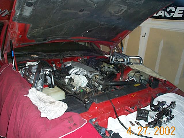

i also forgot to ask, how is this kit for your money? is that nickel plating any good? better than paint? Also what are these lines that go into the exhaust manifolds, are they the 'emissions'?

Yes, those are the AIR lines that run out of the manifold/headers. That is part of the emissions system.
