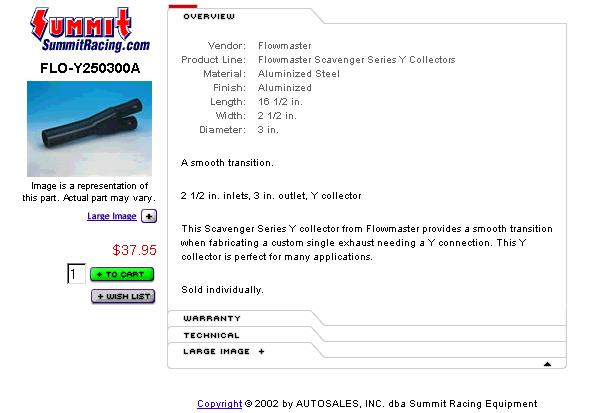

I do not have a pic of it yet, but it basically looks like this:
Old Apr 20, 2003 | 07:11 PM
Mike89GTA's Avatar
Posts: 1,702
I ordered this one, there was no backorder.
I also ordered these two parts from jcwhitney.com
81ZX2937T (2 45* pipes with 2.5" inside diameter ends)
21ZX3254N - straight section of 2.5" outside diameter pipe.
The flowmaster y-pipe/collector above has and inside diameter of 2.5" so once I get my pipe from jcwhitney it should be easy to just pop them all together.. Then I just have to take it to get it welded.

It basically that collector with the two pipes extented and bent to go in to the converters smoothly.
Car Craft did a test on this part few years ago and found 10 RWHP and 8 RWTQ by swapping it for the factory tee'd "F" design.
