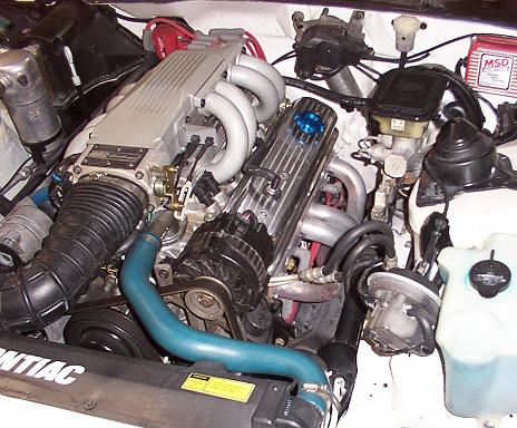

You wil have to have some form of coating weather you like it or not on mild steel headers otherwise, after the 1st run, they will start to rust.
As far as seeing them, take a realistic angle shot and yes, they are plainly visable......
