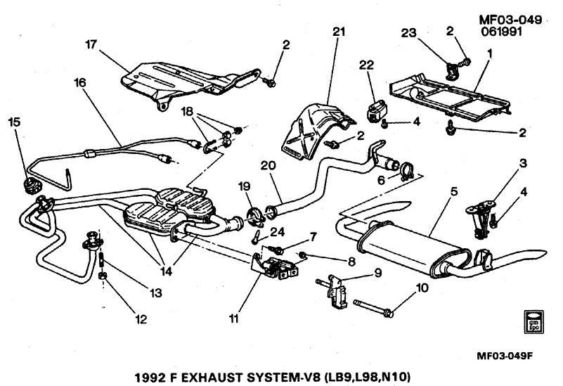

Your stock AIR pipes that run to the cat have a "Y" split before they reached the cats. It is a single pipe before this. See attached picture. To change to single cat you would need to fabricate a single pipe extension to the new cat.

Here's a better illustration of your dual-cat system.

Ok i see what you mean now, i didnt know they were together at any point i thought they were seperate the whole time. Does anyone know if the single cat vehicles air lines would work in this case? or would it be easier to have someone fab something like this up?
