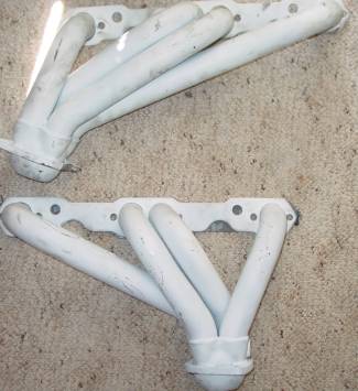

They are Hugger Headers but they are $55. Doesn't look the same as the other headers available so I'm curious if they are any good. I run 2.5" catback and a flowmaster muffler and I'd like to decrease some restriction before the cat.

You won't be able to run those on a 3rd gen. The collectors would run right smack into the motor mounts and frame rails.

Yea, look where our shorties have to exit.... backwards and down, not just straight down. Here is a pic for reference:Hooker 2055.
Attached Thumbnails Whats up with this?-c-documents-settings-owner

Shifty's right. Listen to him.

Thanks, made perfect sense when I took a peek under the hood.
