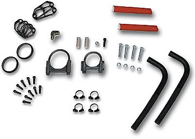

Here is a set Hooker 2210's I found on ebay. Pretty good price since it includes all of the extras.
Headers
