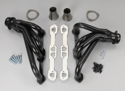

Well how about these thier from summit.
Brand:
Hedman HeddersProduct Line:Hedman Street HeddersPart Type:HeadersPart Number:HED-68479Header Material:SteelHeader Finish:PaintedHeader Style:ShortyPrimary Tube Diameter (in):1 5/8 in.Collector Attachment:Ball and socket flangeCollector Diameter (in):3.000 in.Tuned:NoPrimary Tube Gauge:18-gaugeFlange Style:StandardFlange Thickness (in):1/4 in.Bolts/Studs Included:YesGaskets Included:YesReducers Included:YesY-Pipe Included:NoQuantity:Sold as a pair.
Headers, Street, Shorty, Steel, Painted, Chevy/Pontiac, Camaro/Firebird, 5.0/5.7L, Pair
Hedman Street Hedders are one of the best buys in bolt-on performance.
For the price, no other part can give you the horsepower and fuel-economy improvements of Hedman headers. They make their Hedman Street Hedders so well that they guarantee them to be free from defects--including cracks in the tubes and welds--for the life of the headers. Hedman Street Hedders are available in black painted or ceramic coated finishes, and, as an added bonus, they also come with all necessary gaskets and mounting hardware.
or these
Brand:Hooker HeadersProduct Line:Hooker Competition HeadersPart Type:HeadersPart Number:HOK-2460HKRHeader Material:SteelHeader Finish:PaintedHeader Style:ShortyPrimary Tube Diameter (in):1 5/8 in.Collector Attachment:3-bolt flangeCollector Diameter (in):3.000 in.Tuned:NoPrimary Tube Gauge:16-gaugeCylinder Head Port Shape:OvalFlange Style:StandardFlange Thickness (in):5/16 in.Bolts/Studs Included:YesGaskets Included:YesReducers Included:NoY-Pipe Included:NoQuantity:Sold as a pair.
Headers, Competition, Shorty, Steel, Painted, Chevy/Pontiac, Camaro/Firebird, 5.0/5.7L, Pair
Hooker Competition headers are the best headers for your money.
If you're looking for headers designed for maximum street performance, look no further than Hooker Competition headers. Hooker Competition headers are designed for stock or mildly modified engines for the value-conscious buyer. Made from durable 16-gauge steel, Hooker Competition headers feature 5/16 in. thick flanges that are heavy enough to maintain header integrity, yet pliable enough to seal each exhaust port.
These look nice.

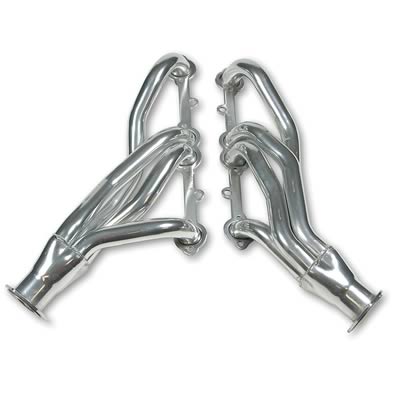

Brand:
FlowtechProduct Line:FlowTech HeadersPart Type:HeadersPart Number:BIG-31108FLTHeader Material:SteelHeader Finish:Ceramic coatedHeader Style:ShortyPrimary Tube Diameter (in):1 1/2 in.Collector Attachment:3-bolt flangeCollector Diameter (in):2.500 in.Tuned:NoPrimary Tube Gauge:18-gaugeFlange Style:StandardFlange Thickness (in):5/16 in.Bolts/Studs Included:YesGaskets Included:YesReducers Included:YesY-Pipe Included:NoQuantity:Sold as a pair.
Headers, Shorty, Steel, Ceramic Coated, Chevy/Oldsmobile, with Chevy, Small Block, Pair
Maximum performance with FlowTech headers.
These precision-engineered FlowTech headers are leak-tested to get maximum performance and fuel economy from your engine. They're made from .049 in. cold roll, flash-controlled tubing, and feature FlowTech's mandrel-formed Power Plenum collector. All ports are precisely fitted and finished with durable, leak-proof, O-ringed port seals. The headers are available with either a high-quality, electrostatically applied, satin black painted finish, or with a silver luster ceramic coating for rust and corrosion resistance. In addition, they come with all mounting hardware, including bolts, nuts, and premium gaskets.
