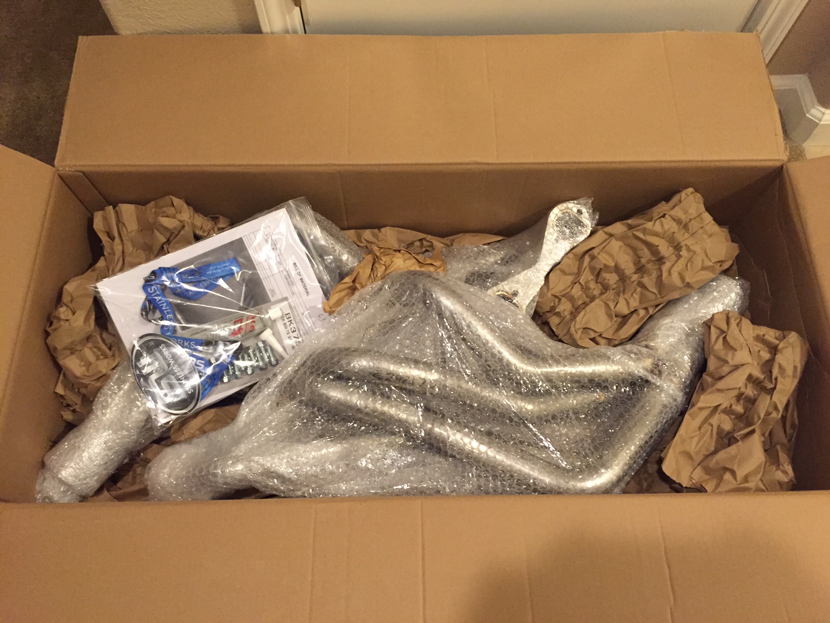

So I ordered the SW headers. I received them today and I must say NICE! I'm very happy with my decision. They are beautiful. The only complaint I have (and maybe it's because I'm not and engineer) is the collector. They are perfect in every way except they use the 1.75"-2.5" collector and just expand the 2.5" to 3" I don't know maybe it makes a "high velocity merge" type of effect but it seems kinda cheap/lazy to me, the consumer, not to use a true 1.75"-3" collector. They did it right. They did a good job doing what they did, I'm just not sure if I agree with that method. On the plus side they expand them to 3" OD so it's easy to adapt any type of slip on muffler/extension/insert/etc.

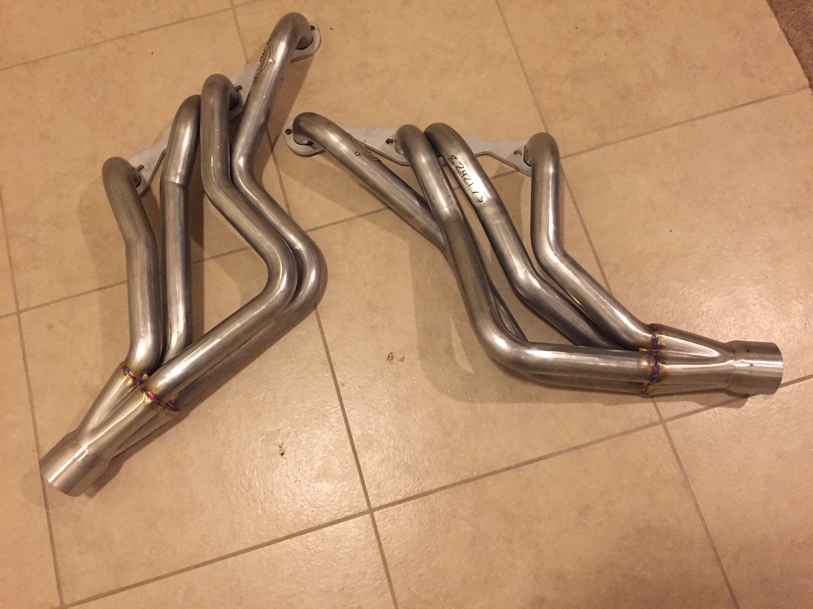

These are the pictures of them. That's what I was thinking about doing. But that's more $$$....maybe worth it. I think I'll run them how they are first.

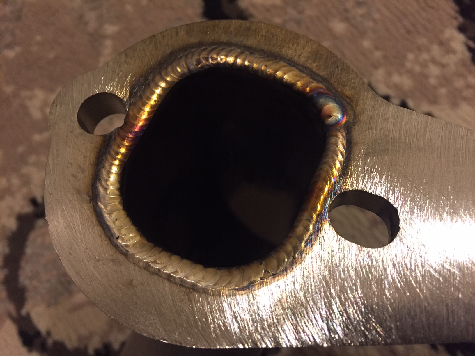

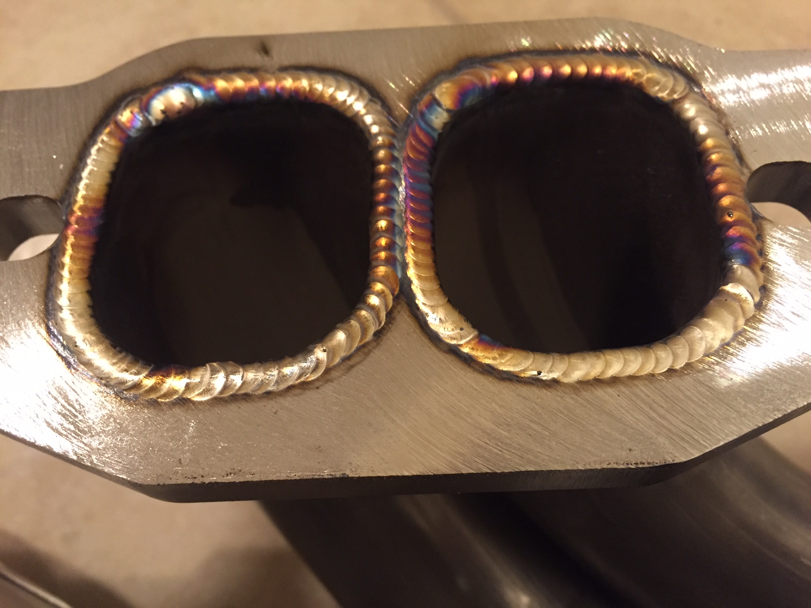

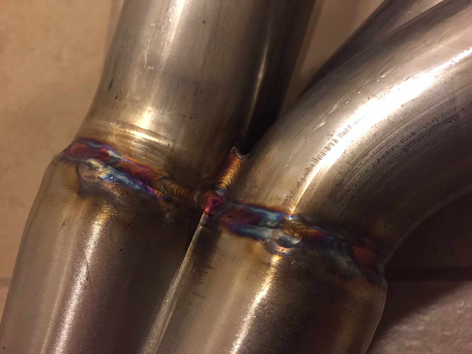

trying to post the pics again. I got a really good price because i'm a dealer but they retail at summit for $927 to your door. again, they are so nice. i did notice they have changed their flanges as well as the location for the O2 bung. i guess they got enough feed back about the sensor hitting the floor with some guys.

Re: Help deciding which long tubes...
that's a beautiful merge collector. Leave as is. You can really see the price difference with the chinese copies here

I meant in workmanship. I decrapified the collector.
