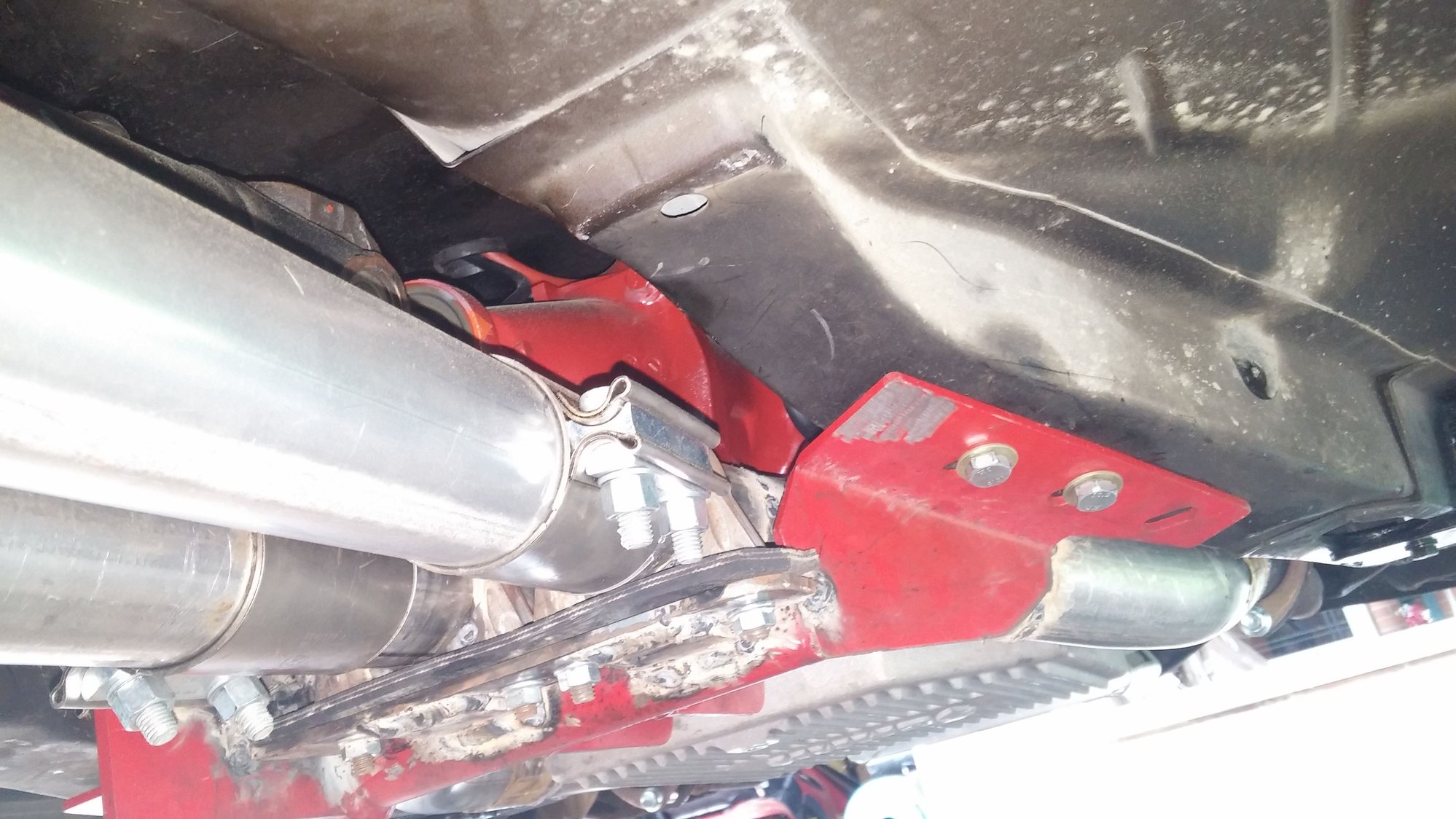

First I want to thank Hooker for developing products for this car! I am currently fitting up the T56 version of the Blackheart system to my IROC with 406 SBC with TKO trans with the Hawks headers and home made cross member. If it were not for the collectors size on my headers I believe the Blackheart system would bolt up with "no" modifications. Now perhaps some optional rolled or double wall tips and the system would be perfect. I just wish the system came out a couple years ago so I would not have spent so much time building my own system.
Thanks Again!

I'm glad to hear your install went so well, thanks for sharing your experience.

I just finished helping 86base install the Blackheart system on his car. While the back half of the kit fit like a glove and was excellent quality, because he runs a sbc and th350 we had to fab everything forward of the over the axle pipes. Running the shorter th350 allowed us to make the pipes off the headers run along side the trans and then OVER the BMR x-member. The mid pipes were made from straight sections of 2.5" pipe and tucked up real nice after some massaging of the right side rear floor pan along the tunnel. The exhaust sits up higher than his sfc's.
Maybe 86base could post some picks and audio. It sounded pretty good with the big lumpy cam he is running.

Would like to see pics as I also have a T350. I'd like to install the BMR cross/t/a. Also would like to see the mods to hook up to the Long Tubes.

Sorry for the delayed response. I will get the car back up on ramps and get some pics up this weekend. I have been test driving the car the last couple days. I just broke a couple wheel studs so I will have time to get some pics. I'm not sure how I can put up a video of the exhaust but I will figure it out somehow

Do you have a tear in a frame rail by where the front of the sub frame connector attaches on the passenger side?

I think I see what your talking about. No it's a weird angle of the photo of the hole in the frame rail that's elongated. This car was totaled and put on a frame rack

Wow!!! Looks AWESOME!!! Love how it's put through the crossmember instead of around or below. Does it bang/vibrate or hit anything?

Thanks, Yeah Dave did a great job. no vibrations. I had some thick rubber belt laying around and put some piece in between the pipe and heat shield over the axle because it was really close. other than that it is great. I can now lower my car without worrying about exhaust clearance.
