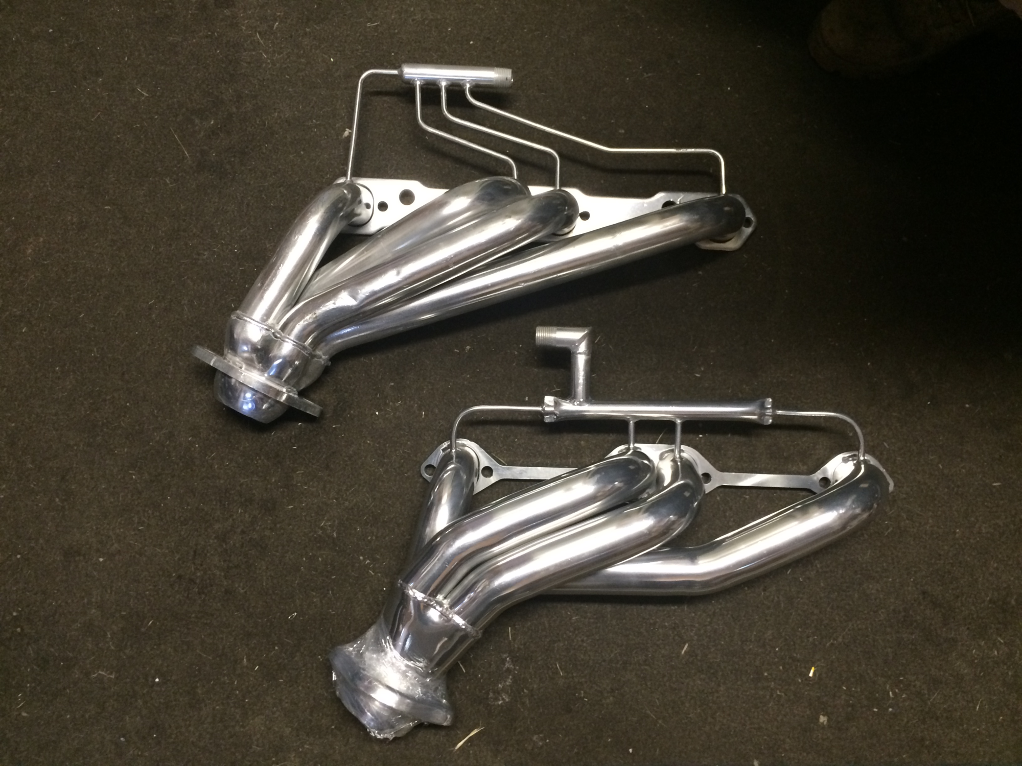

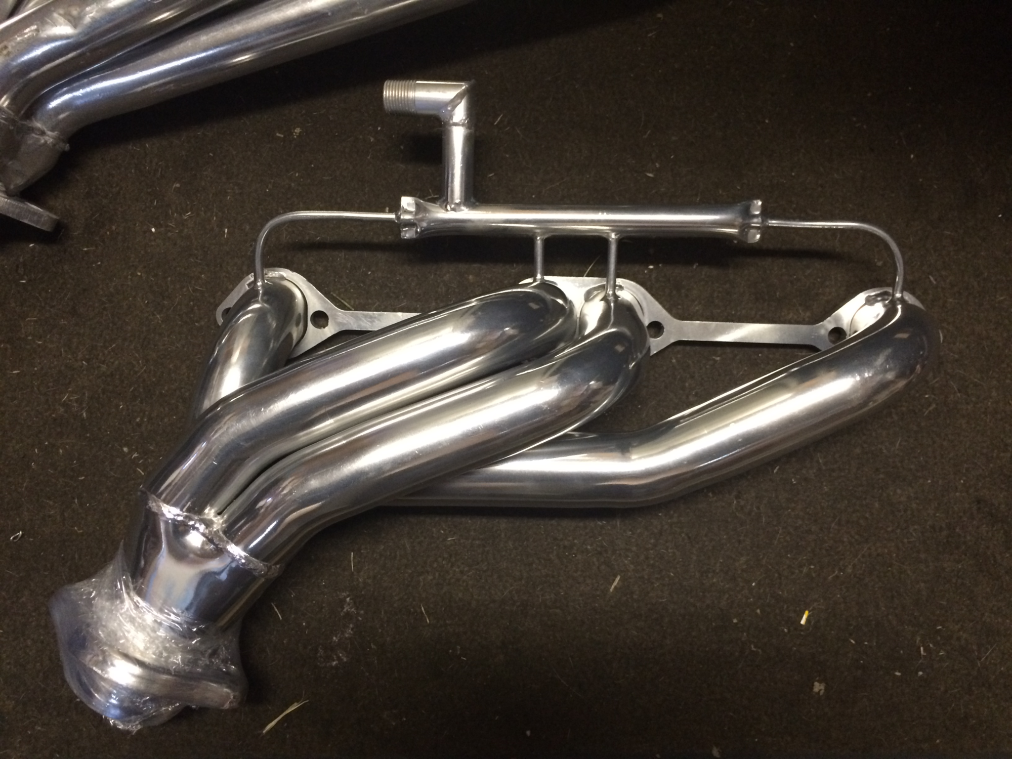

Dropped off a beautiful set of headers with the mechanic. Dyno Don made them for me last month. Due to my situation I can give everyone on here a glimpse of Don's headers side-by-side with the Hooker 2055's.
Up top is the 2055 Header and down low is Dyno Don's header. These are both silver ceramic coated with air tubes. Here are a few comparison notes.
The most obvious difference is the air tube design. Don's much closer resemble the ones on the stock manifolds so they should fit in a bit easier. Also the threads are facing rearward which is required for my 1986 TPI. After being on the phone with Holley several times, they just don't make it like that.
Next up is the flange against the block. The 2055 is larger than Don's so a bit more weight. However, the header gasket will be covered completely on the 2055.
The piping routing itself is also a bit different as well. The 2055 has straight pipe until the collector bend which could cause clearance issues. Also the second to left pipe routes to the inside on the collector on the 2055. On Don's header this pipe routes to the outside. Not sure if that affects performance but the latter offers a cleaner look IMO.
One thing that isn't visible (that I forgot to take a picture of) is the collector opening to the rest of the exhaust. The opening on Don's header is visually larger than that of the 2055. With exhaust flow being the key performer of a header, that's a big factor.
Here are some closer pictures.
Hopefully this will help answer some future questions. Both are great headers so you can't go wrong with either. Just measure twice before ordering.
