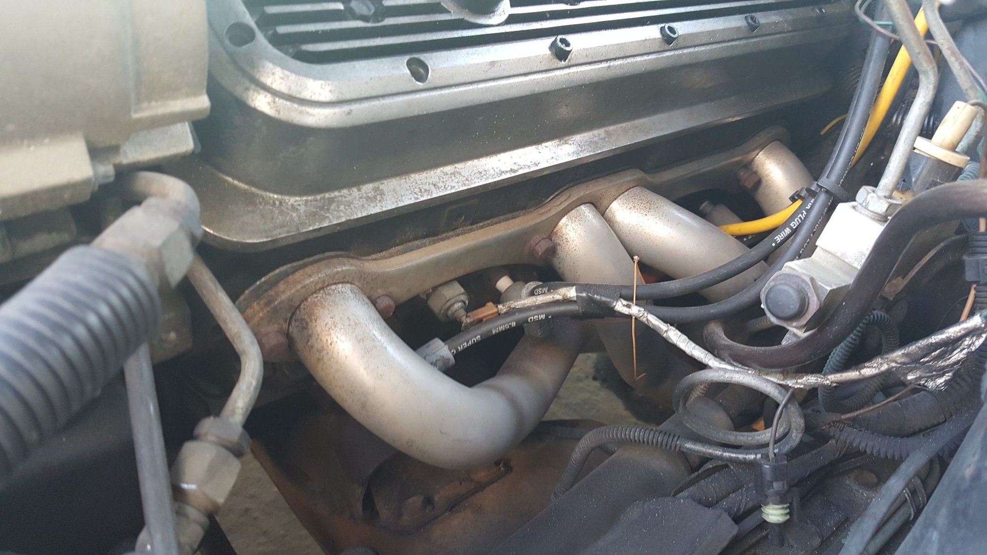

Re: Headers rubbing suspension and chassis
This are my headers...

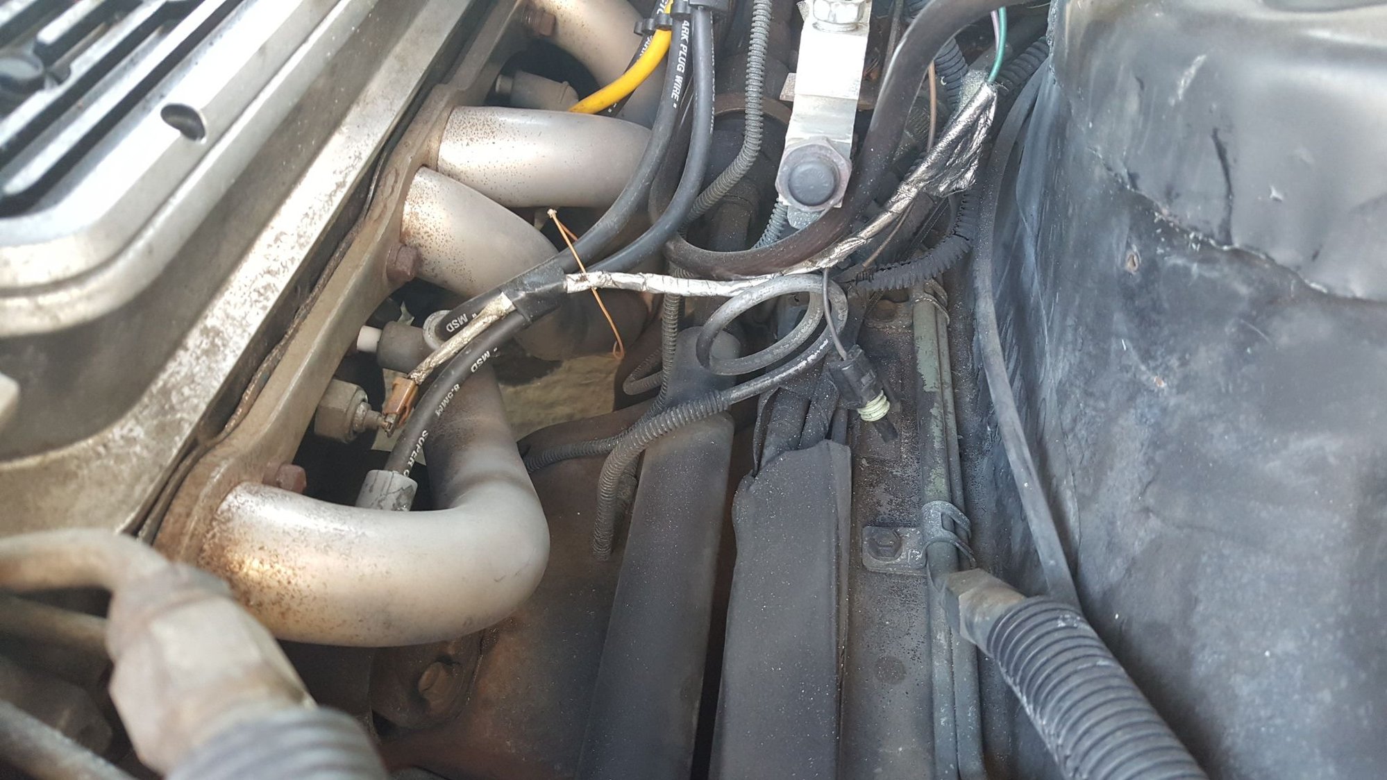

Where/what are they rubbing on?
Old Aug 4, 2016 | 01:37 PM
cheves's Avatar
Joined: Feb 2015
Posts: 90
From: N/A
Car: N/A
Engine: N/A
Transmission: N/A
Right here....

ding them- it's just what you have to do with lower end headers for American cars and David Freiberger proved that you won't kill off any power...
mark where they need clearance, pull them out, and use a chunk of round tubing to spread the blow from the hammer and make it look nicer. those headers look coated, so wrap a rag around the tubing before hitting it. you might still damage the coating, but it's probably already damaged from rubbing, anyways.
i think i had to ding one tube one each side of my Hedmans- one on the front, one on the rear- but they've been in the car since 2012 and it hasn't caused any issues.
