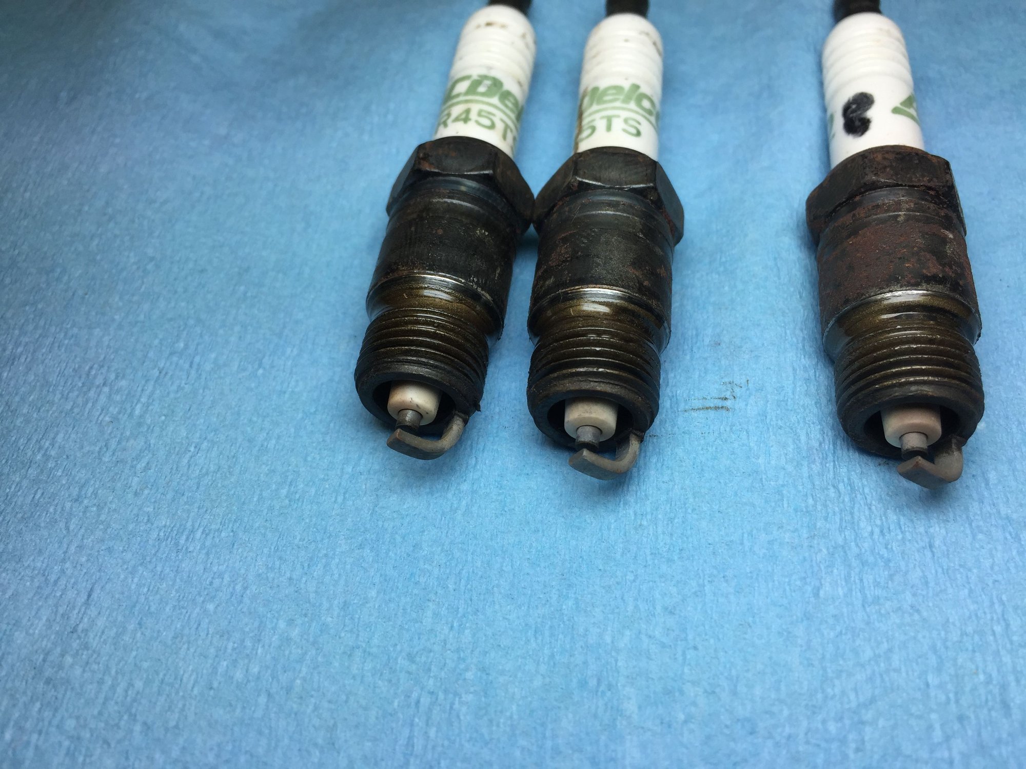

Plugs 1,3,5,7
Old Oct 18, 2016 | 07:28 PM

Plugs 2,4,8. 6 is a main PITA to remove and requires going under the car

I'm no plug reading expert for sure. But those odd numbered plugs have a nice tannish-white appearance. Not too bad. But those even numbered plugs look pure white, or, too lean.
Not my area of expertise, and working from photos, etc. Just sayin'...
Ya, I picked up on that too. I put a TPIS intake, SLP runners and took the cats and smog stuff off so I didn't really know what fuel pressure setting to go with.
1MeanZ told me to start with 50 with the vacuum line disconnected and go from there. The glowing header tube took priority over fine tuning the fuel pressure and I only put 20miles on the car since I put it back together.

Used to have these sorts of things on paper (man am I old). It also mentions hot and / or lean.
http://1.bp.blogspot.com/-BpC43BNUt1...plug_chart.jpg
