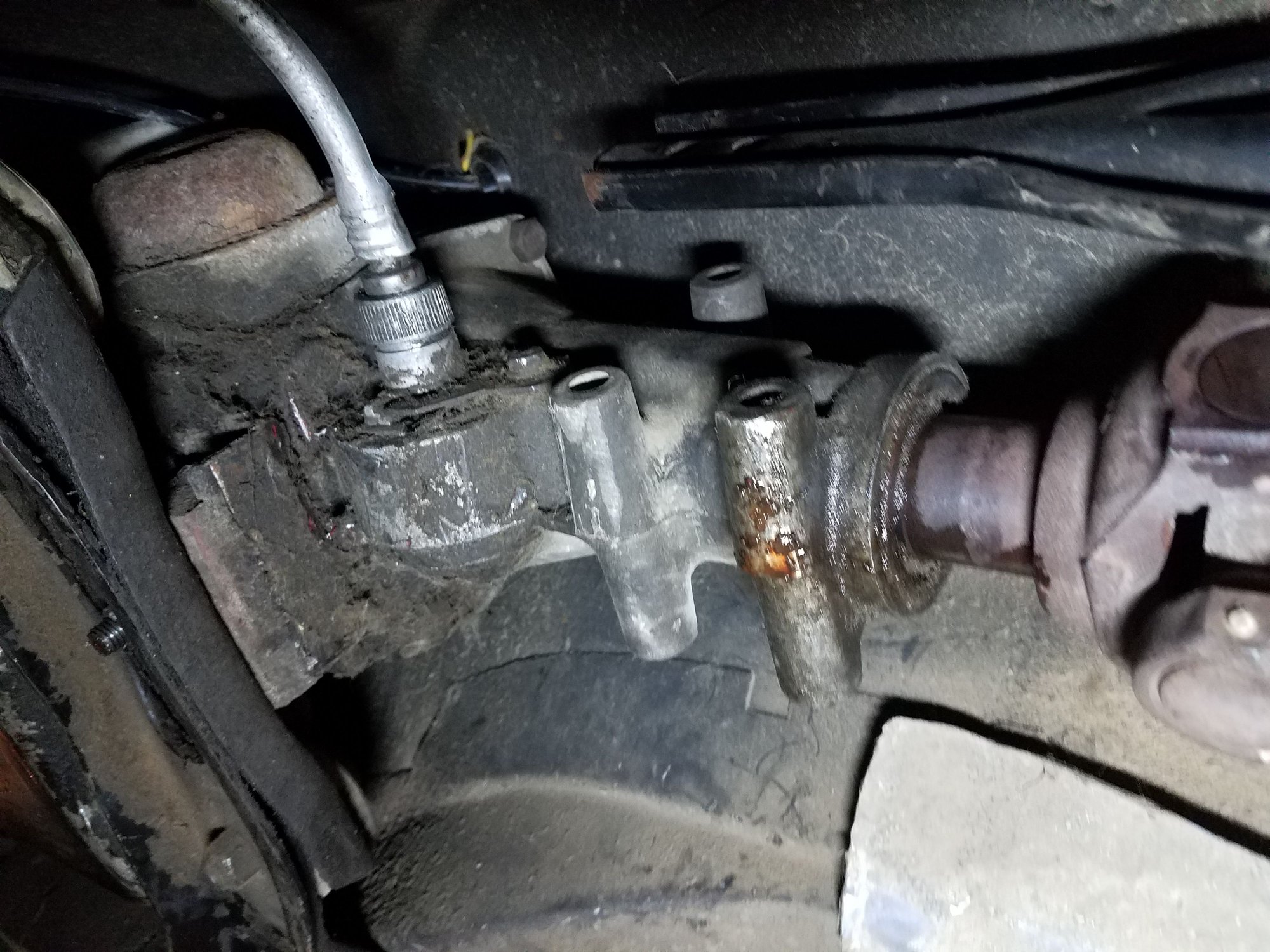

It looks like the tailshaft is correct. It matches all the pictures im finding on ebay and the front of the torque arm stops at the rear of the transmission next to those big bolt boss looking things on it. Is there a mount that i am missing then?

I didn't think the vans had the holes for the mount . I did put a third gen tranny into a g van in the mid 90s and never swapped the tail housing.
If you don't have a torque arm mount you will need one.

Is this correct?
Old Dec 17, 2016 | 03:26 PM
Tuned Performance's Avatar
Community Influencer
iTrader: (95)
Posts: 16,906
Likes: 1,014
From: Mile High Country !!!
Car: 1967 Camaro, 91 z28
Engine: Lb9
Transmission: M20
Re: Need help finding headers.. will these work?
Looks right

Thanks for the help though, this thread showed me alot because of the torque arm issue. I had no idea what the hell that chunk of metal was for nor its importance. I found the mounting hardware i need at my local salvage yard, thanks so much guys!
