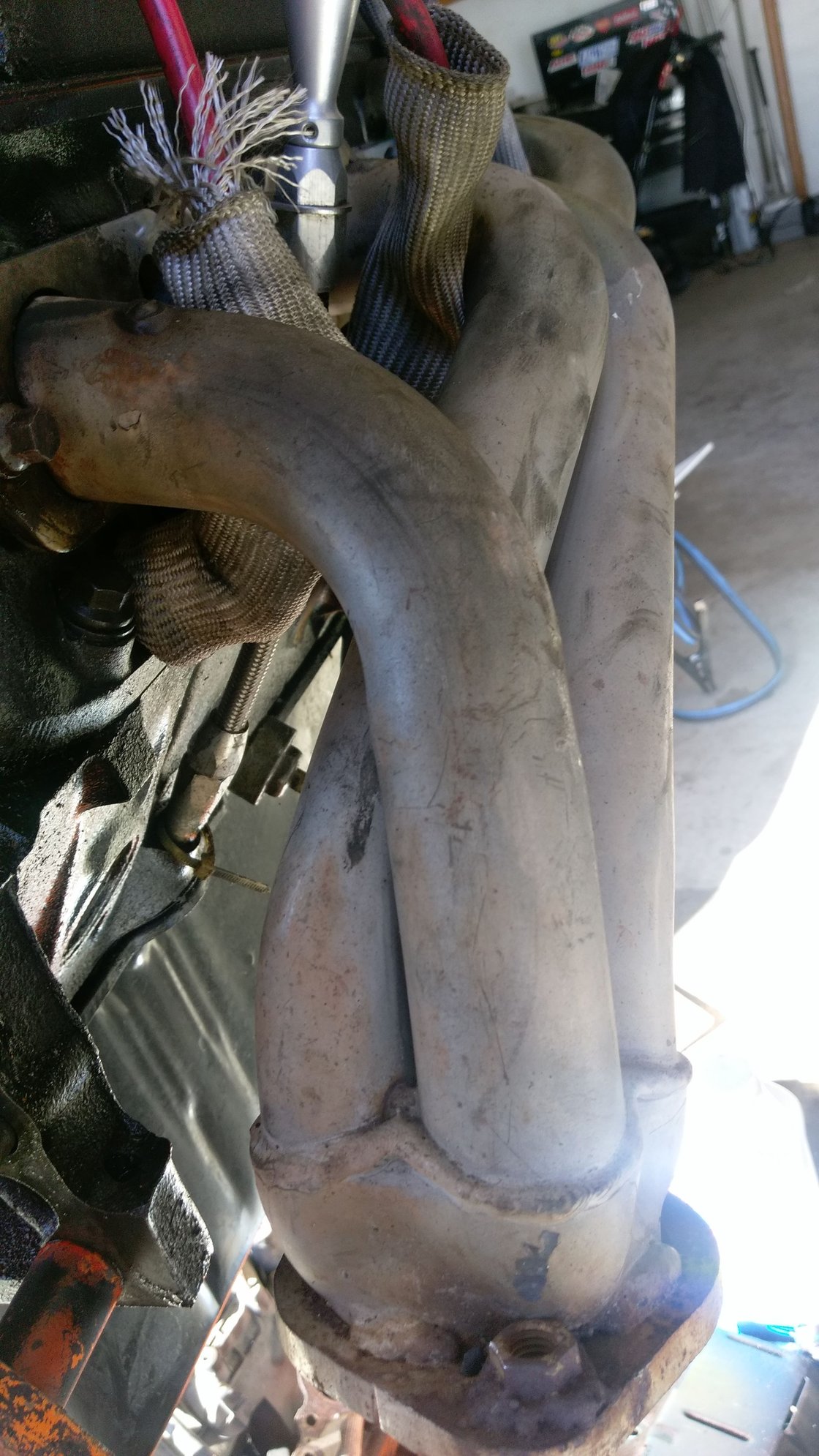

Ask anyone that has replaced a set of mild steel headers with a newer set of SS headers and they will confirm that they now have a sauna under hood. Ceramic coating both mild steel and stainless steel headers will reduce the heat transfer through the substrate and dissipate heat from its surface much faster than the raw substrate alone.....

what steps are you guys taking to coat stainless steel headers, ive been doing ceramic coatings for a while now and the coating always starts flakes off of the stainless within a couple days, most of it stays on tho. from what i've gathered its because of the smooth surface that stainless has, where as blasted steel headers give a rough texture for the coating to stick to.
the picture i attached is 2 days after curing and install, maybe about 3 hours of engine run time on them.
Attached Thumbnails Ceramic Coating Stainless Headers-17352301_1920885644849801_6879287826556733339_n.jpg

Re: Ceramic Coating Stainless Headers
Please chime in CCPcoatings.
Was your engine already broken in (not the 1st run)?
So could you sandblast the stainless part like they do the regular steel to rough up the texture and allow the coating to bond to the surface better?
its happened on multiple occasions, all engines were broken in already.
you can sandblast stainless steel, but it will still have a smooth surface, unless there is some kind of media that im not aware that would work. i typically use 70 grit black aluminum oxide for regular steel.
