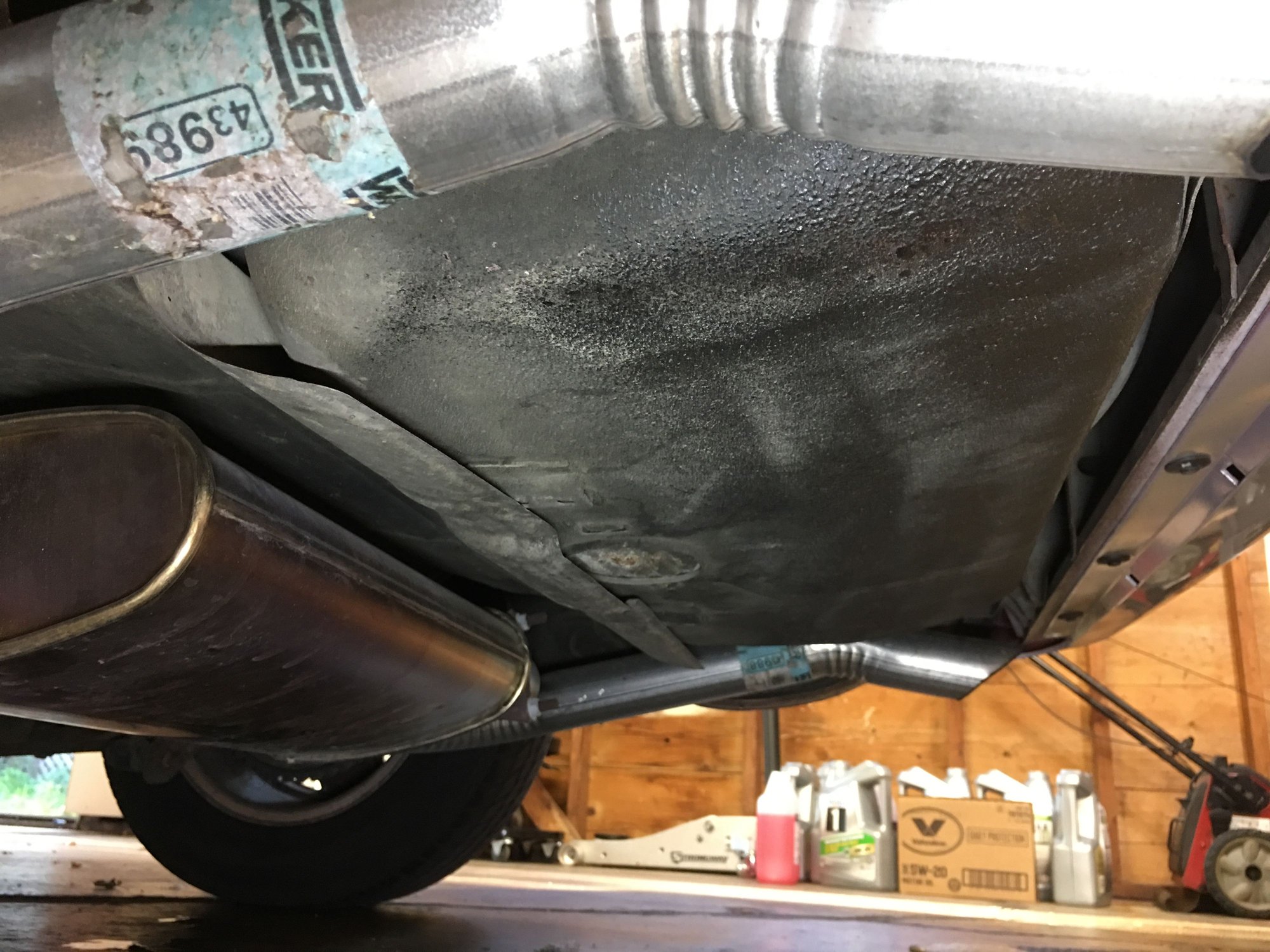

So I bought these while on a “stock appearance” kick to replace the 3.5” magnaflow 16829 howitzers currently on my car... but I still kinda like those half the time - anyone have some pics of the walkers on their ride?

I recall these Walker pipes for the Quiet Flow are the same dimemsions and diameter as the Dynomax. I replaced the Dynomax muffler and pipes with this in hope for quieter car, but nearly as boisterous as the Dynomax.
These have the crinkle bends, but same angle, length, and end-cut angle as the Dynomax that came off. They are close to stock, but I recommend cutting tips at sharper angle if you want a stock look. I did not cut mine but wish I did.
