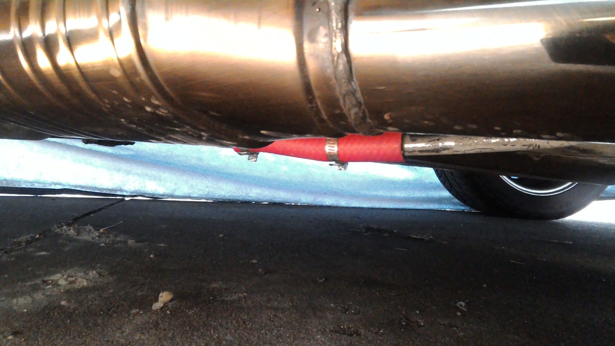

I did the same job about a month ago- I ended up using some "hi temp" rubber hose from the local parts supply- it's only a temporary fix but all seems fine so far. The appropriate fix would be to either reflare one end and braze/weld or add a coupling. There's always air pumping through this cooling it so the heat from the cat won't burn it. At any rate it will last until you can find an exhaust shop. This fix has 100~ miles or so and shows no sign of heat damage- also it doesn't hang below the cat, it's just the angle of the shot.

For what it's worth, I have the same temporary fix in place (hi temp hose with hose clamps). I've put just over 200 miles on the car with no issues. I wouldn't leave this in place permanently though.
If you don't have enough length in your existing AIR tubing to reach the new cat, I'd imagine you could get a section of steel tubing to make up the difference (rather than replacing the entire length of tubing). You could flare both ends of the steel tubing so it fits over the existing AIR tubing and the port on the cat or just use tubing with a slightly larger inner diameter than the outer diameter of the AIR tube and cat port. It wouldn't be the cleanest thing in the world.

The hose is 1/2 inch I.D. and it fit perfect. The likelihood you can find the correct size compression coupling is slim to none.
