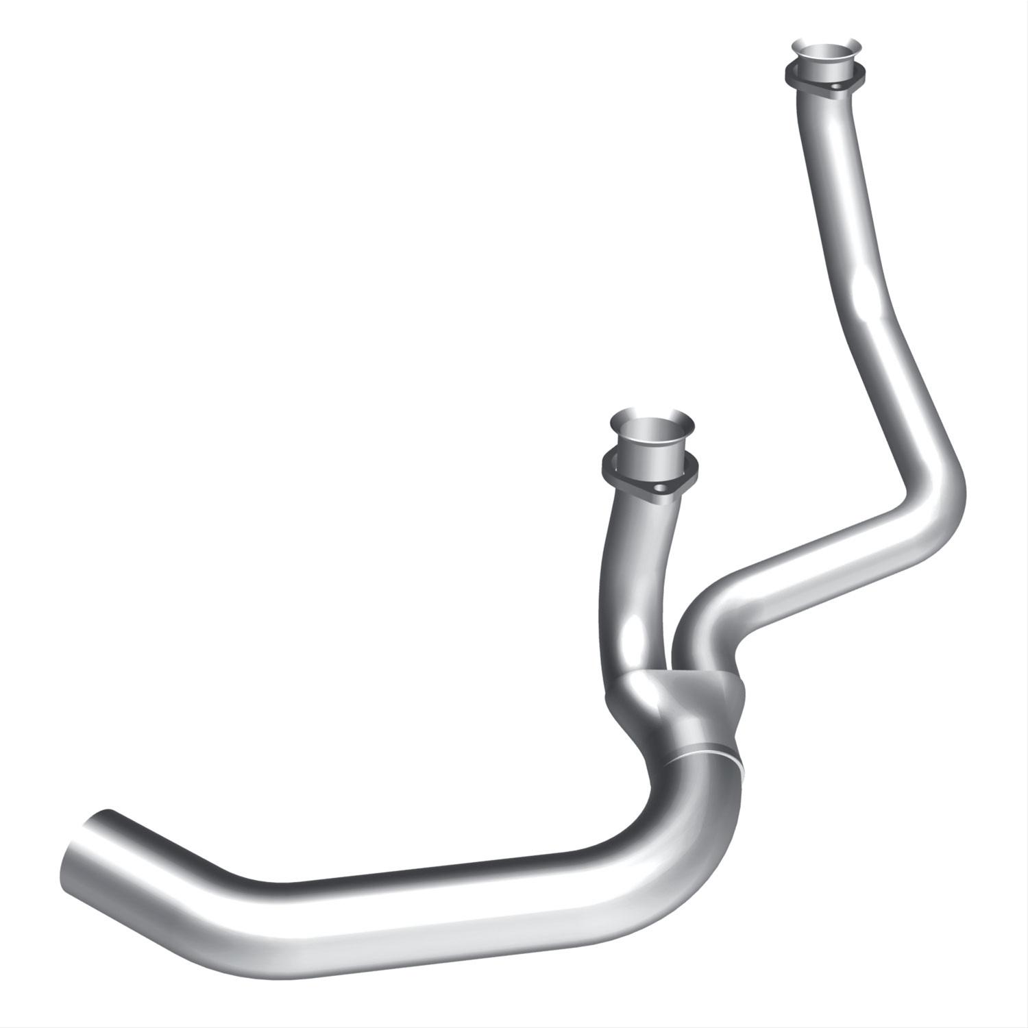

If this is the Y250300 than I would say no. Right off it looks to have a 3 bolt flange and ours are 2 bolt. The T is a little better but still a concern as you stated. It is not mandrel bent. The fitment would cause me concern just from looking at it. That black collector Y I pictured came up in a search using the above numbers so maybe that is the Y he referred to. The stuff is made by Flowmaster.

Yeah you would think Magnaflow would have a mandrel bent replacement, but that's the way it is I guess. Since my last post I called Magnaflow, and they have part number 10778, a Y pipe specific to third gens. It's a collector, not the pipe, designed for 2 1/2 into 3" exhaust pipe. About $50 delivered. My guy can fabricate the rest of the system from the engine all the way back. This brings the price to about $350 for the performance exhaust.

Yes you will for sure need the spacer to make the y-pipe fit. The spacer you will have to find through this site from one of the third gen scrapers. BethsCamaro is one of them. I list a couple others in the post above.That Magnaflow pipe is the right one as long as you have the HO manifolds and the proper spacer, Which is pictured in a above post also.
Magnaflow should probably thank this thread as it seams they have sold a few pipes from here, me being one!
