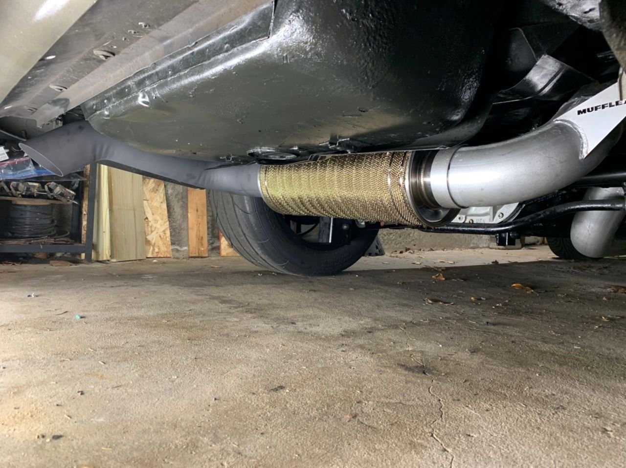

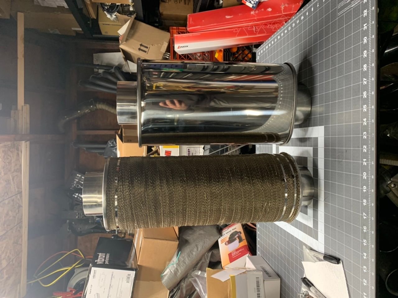

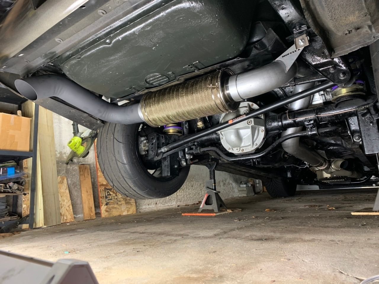

well here we go! Got it yesterday and I got a 7” round x 18” case vibrant 304 straight through perf core muffler with an overall 22” length. The muffler is big but I wanted the largest case I could fit to help with noise given my experience before. Opened the hawks box and found a mufflex over axle part... wow they are just using the mufflex parts, not that I’m upset about it. The catback fit like a glove even with the stock PHB support and has better over axle clearance and ground clearance than my summit 3” catback. I can’t believe they are able to fit the 4” pipe in the stock routing... it’s crazy. Either way I’m super happy with the fitment and the muffler fit with no trimming. I made my own bracket for the tail pipe and fit it up tight to the car to help hide it. Painted it black to help hide it. I also wrapped the muffler bc I had the wrap and I hate chrome or polished anything. If this works out and I don’t hate it I will pull it and creakote the whole exhaust like my hotside.

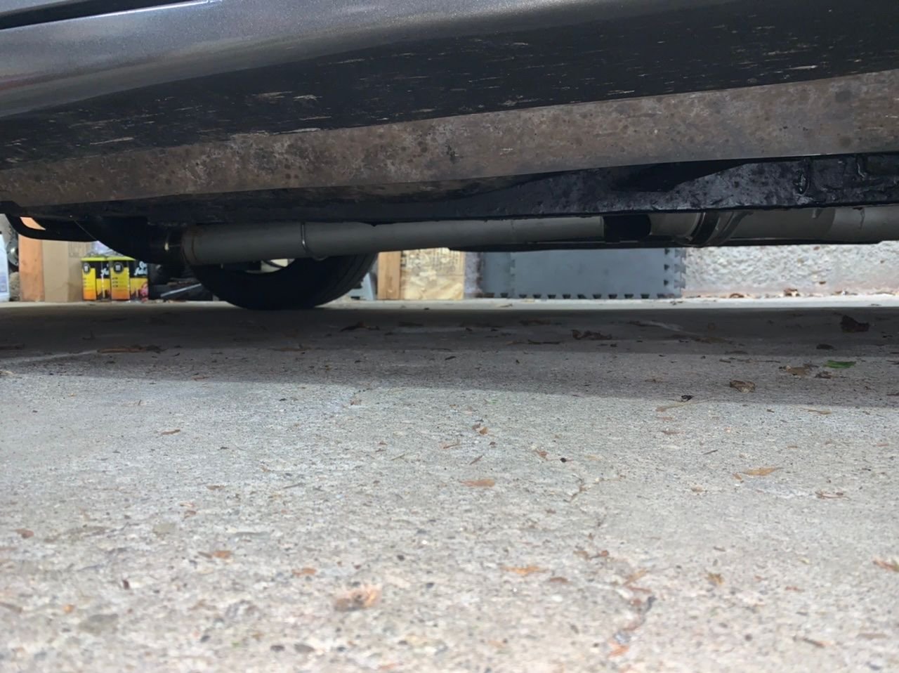

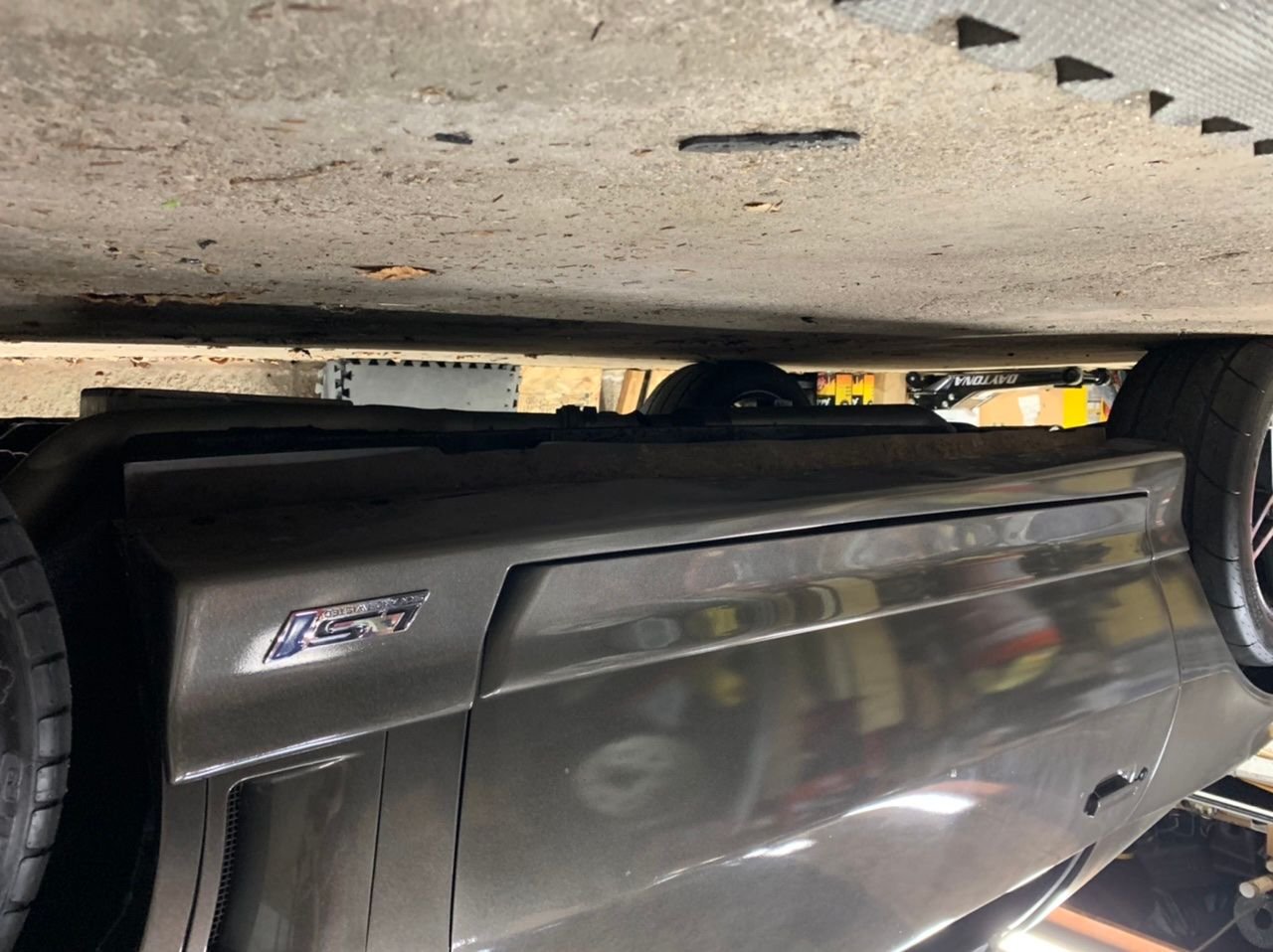

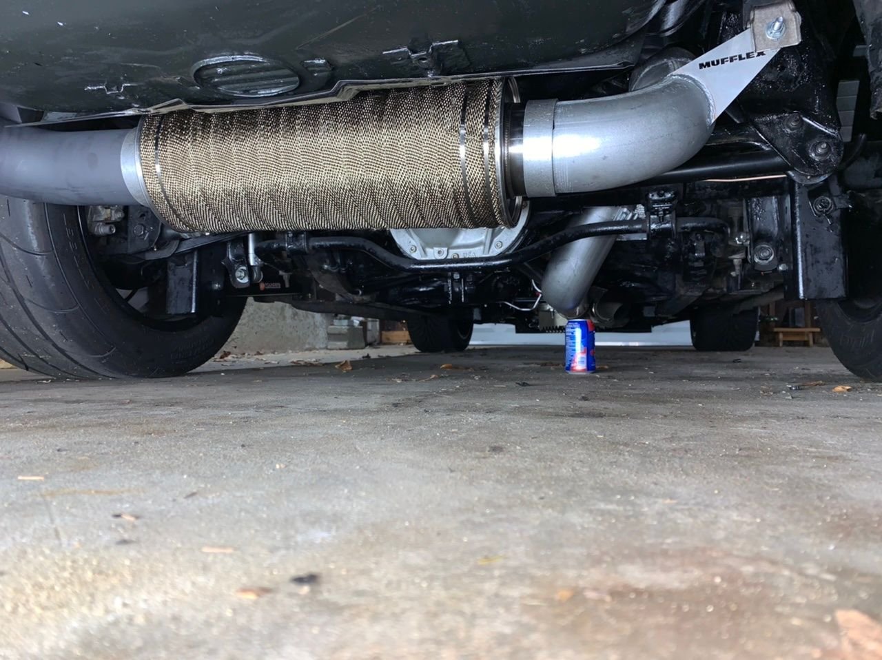

i haven’t started the car yet but ground clearance is great but my car isn’t stock. I have 18” wheels with DRs on the back and taller tires on the front. 27.7” rear tire and 26.7” front tire. Car has 29.25” rear quarter height and 27.5” front fender height But that car is lowered with weight jacks. I plan to take a video of it running and posting it with a video I took of the 3” catback to compare.
Started it up and shocked by how quiet it still is. Here are some videos. These idle shots are outside in the same spot so the sound should be close (nothing to echo off of)
here is the before video with the borla proXS muffler idling.
here is the after video with the 4” catback
Driving the car down the highway with 4” catback
honestly I took the car out for a drive and the car is much quieter than I thought. It’s louder than the borla 3” but not as loud as I was expecting. I was able to get alittle more turbo spool through the full exhaust but still nothing compared to what the cutout provides. Overall the car is still pretty quiet and I can cruise down the road with the windows down and not hear the exhaust much. Depending on how I feel I can always do a muffler delete or put something smaller in

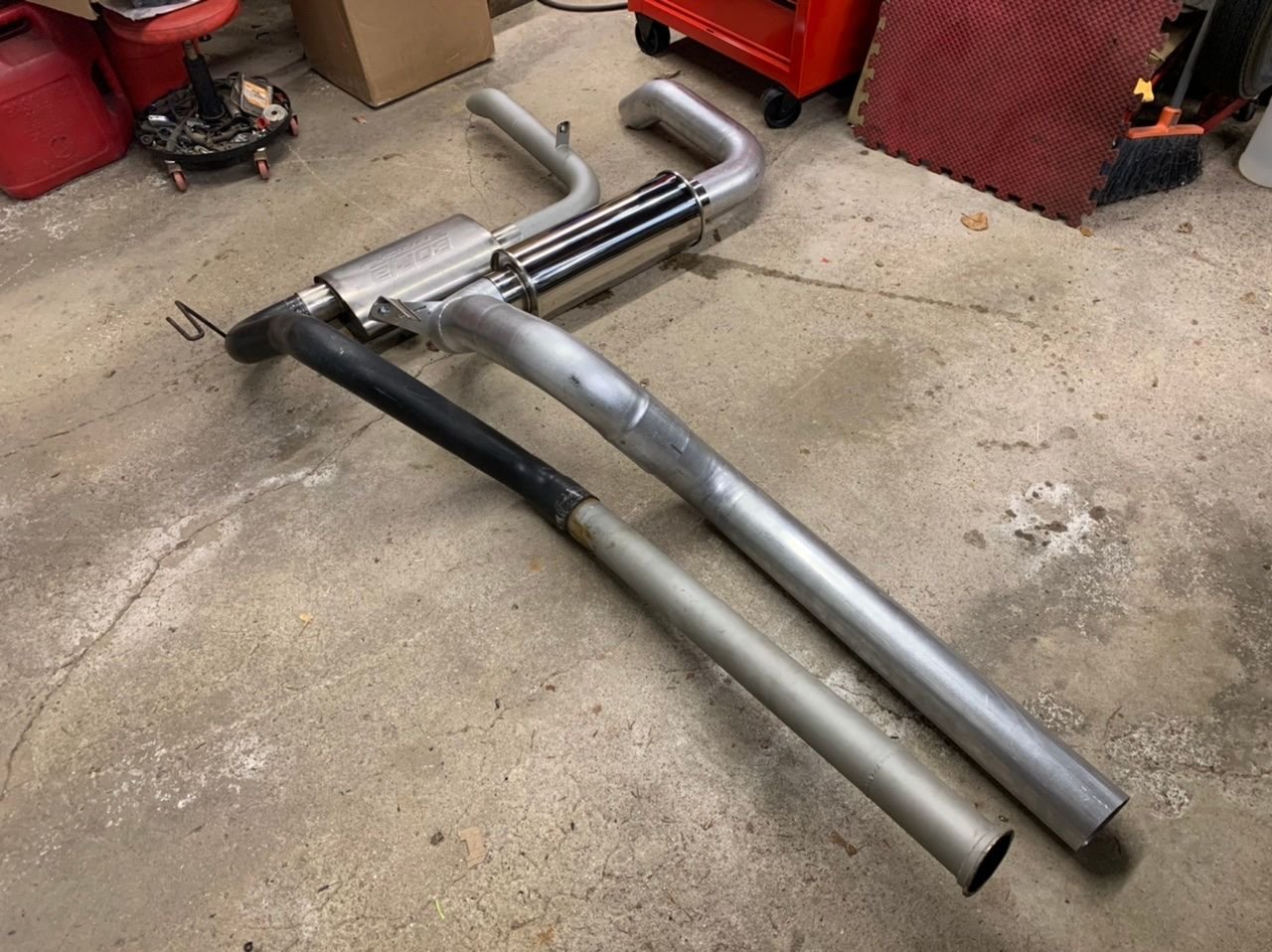

More pics comparing the 3” to the 4”.
Reply 0
May 23, 2020 | 11:48 AM
Re: 4” Hawks sinister with vibrant 7” round muffler
Quote: Looks beastly 😎
yea I forgot how big 4” really is lol.

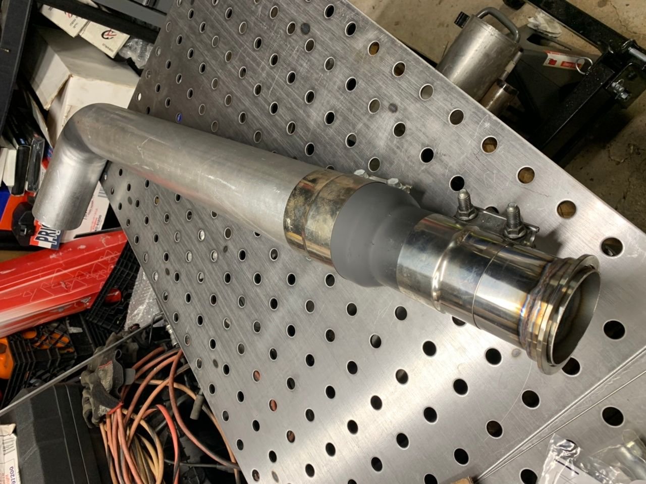

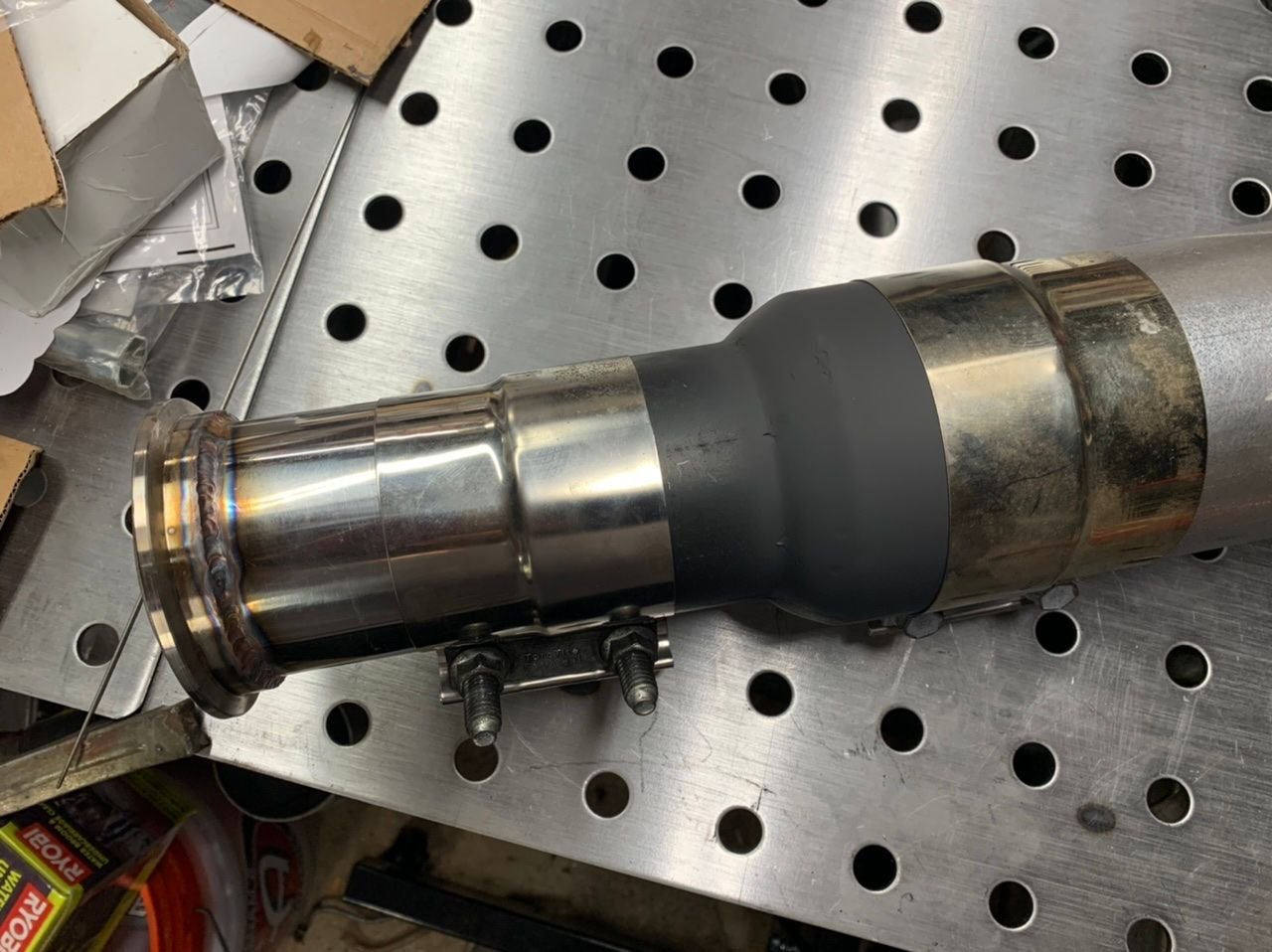

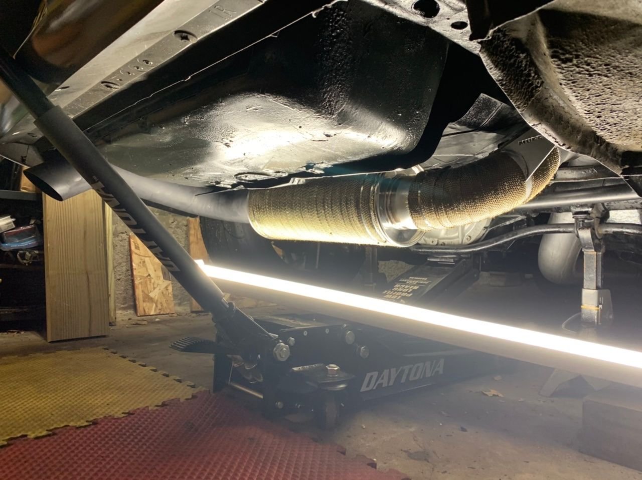

How I mated my 3” vband flexpipe after my cutout to the 4” intermediate pipe.
honeslty it was a very easy install for me. 1 vband flange, 8” of 3” exhaust pipe and 2 lap joint band clamps (4” and 3”) and it was in. Dented the floor plan a smidge and cut a small piece of the seat belt anchor bracket and it was installed. The pipe end by the axle could have tucked up higher but do to how I had my DP and cutout tucked up so well the 4” pipe was a lot more work to fit just do the DIA and proximity to the floor board (how I had it). Either way I’m happy with the ground clearance and not worse than my 3” catback.
I added some reflective adhesive heat barrier to the gas tank and behind the rear seat.

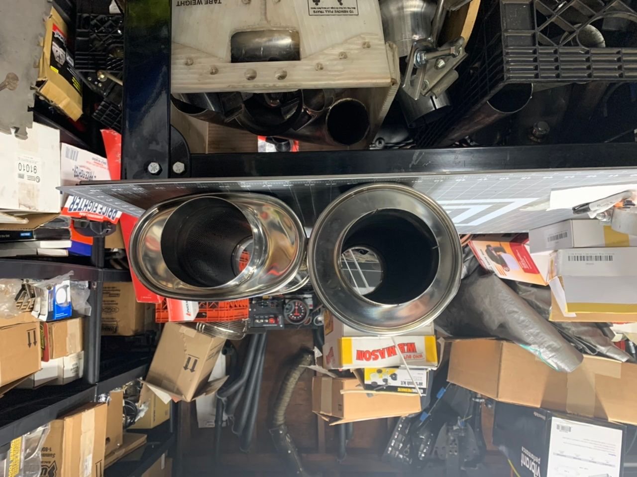

If anyone is wondering my smaller oval case vibrant randomly shipped 3 weeks early from Jegs and arrive today. It?s a 5x9x15 case with 20? tota
length however it?s really 5.5?x9?x15? and a 19?
overall length. The way I fabbed the exhaust it fits the 22? long 7? DIA round muffler better after test fitting tonight. The smaller vibrant is a direct swap for the Hawks muffler delete pipe (same 19? length) and it?s a good bit cheaper than the maggy. The 7? round only hangs .75? lower than the oval so im fine with that and its not lower than my rear. I did not like how much gap is above the oval muffler than the heat shield... almost wished I could tuck the over axle pipe up higher and if I could then I would run the oval smaller muffler. I def picked up power over the 3? catback and got alittle more turbo whine but still
nothing compared to the cutout being open. got nothing bad to say with this hawks/mufflex catback, lots of ground clearance and great fitment.

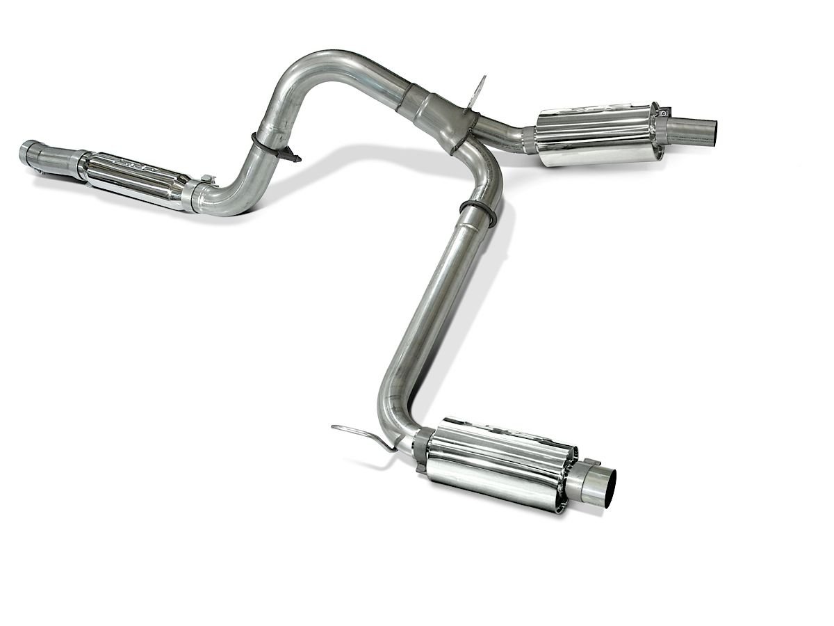

So I thought this over a bit more, and I think I'm going to cut the BMR subframe connectors out after all. I didn't realize southside machine is back in business, looks like someone re-opened with the same designs. I ordered a pair of their subframe connectors. This will let me route the downpipe in the stock location, and then I can put a race muffler where the cat's would normally be.
I have a pair of SLP powerflo mufflers. I'll probably run the 3.5" all the way to the back and then just split into the two 2.5" exits. The mufflers are fat case through design.
Basically, I'm doing the SLP "loud mouth" style exhaust, with their SS mufflers, in 3.5".
