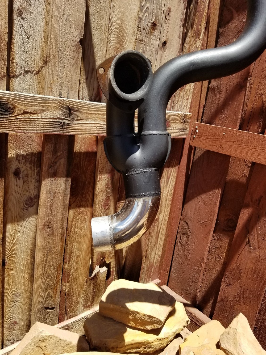

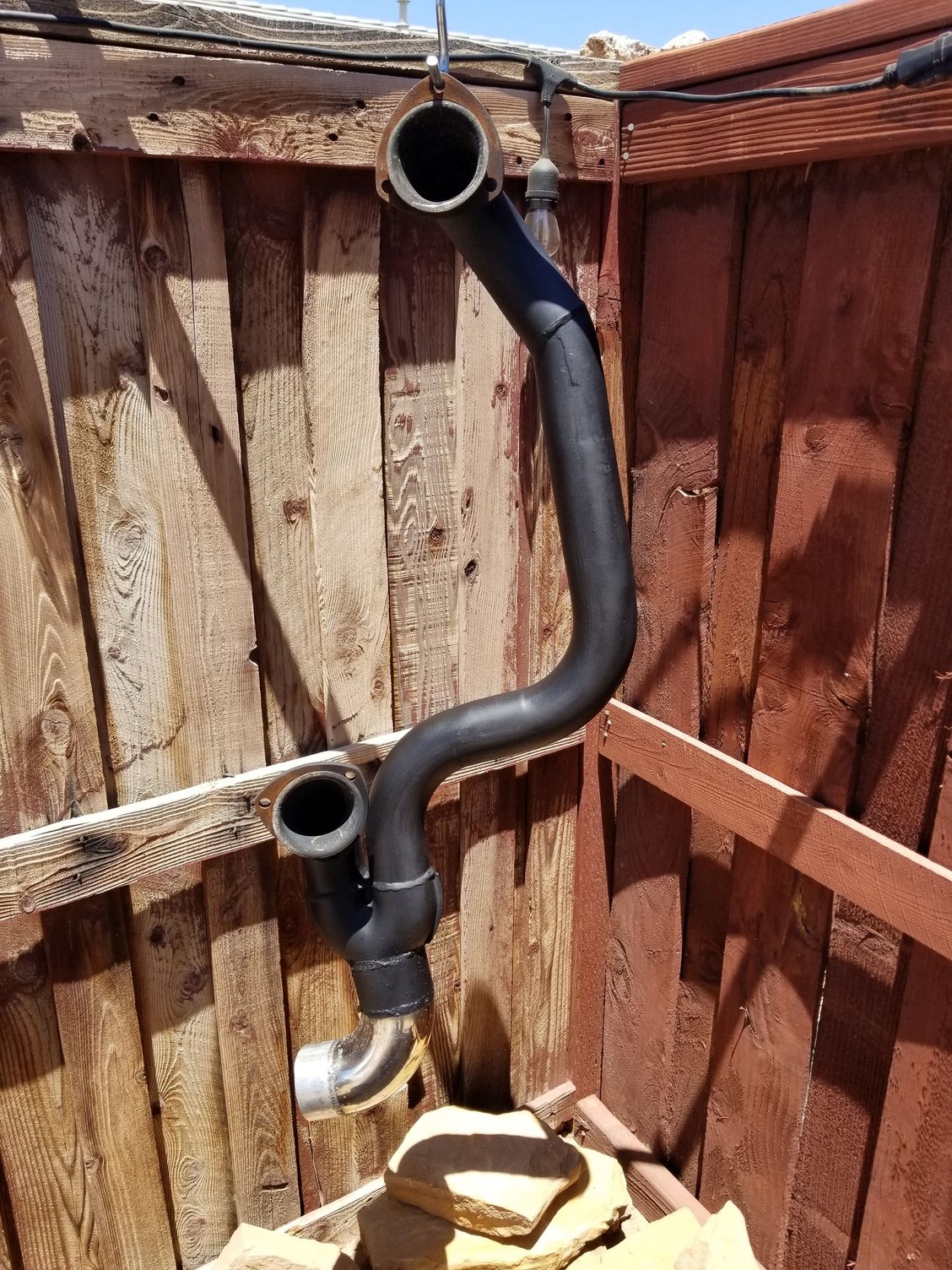

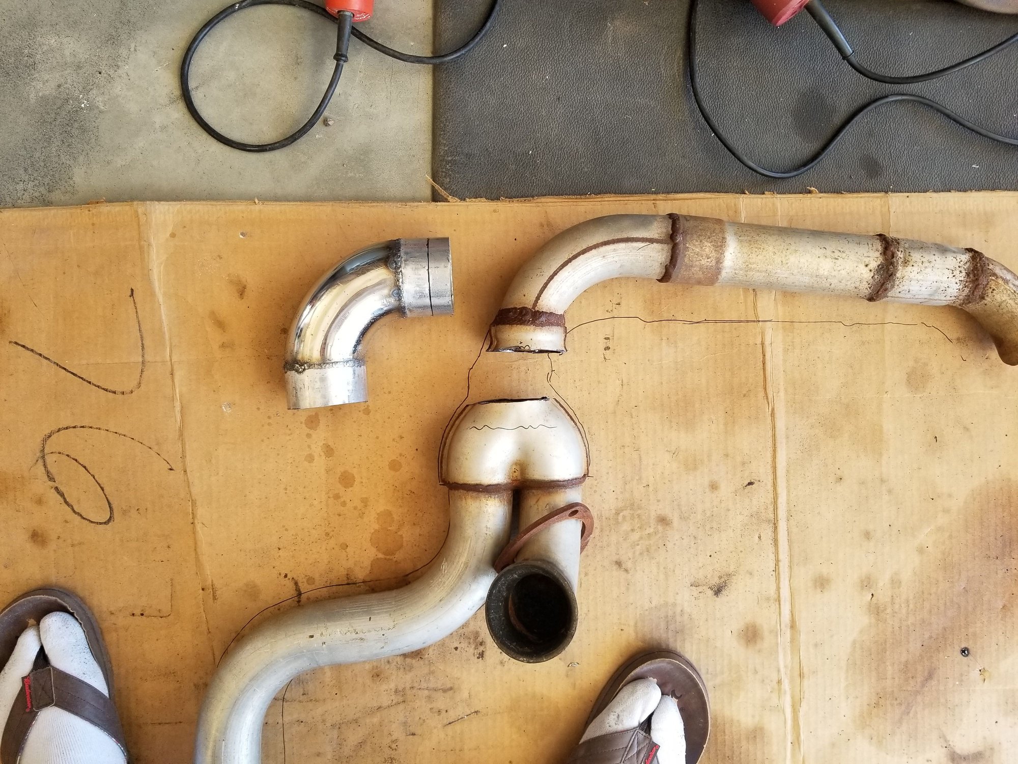

Just in case anyone else looks for similar, here's a photo of mine after modification:

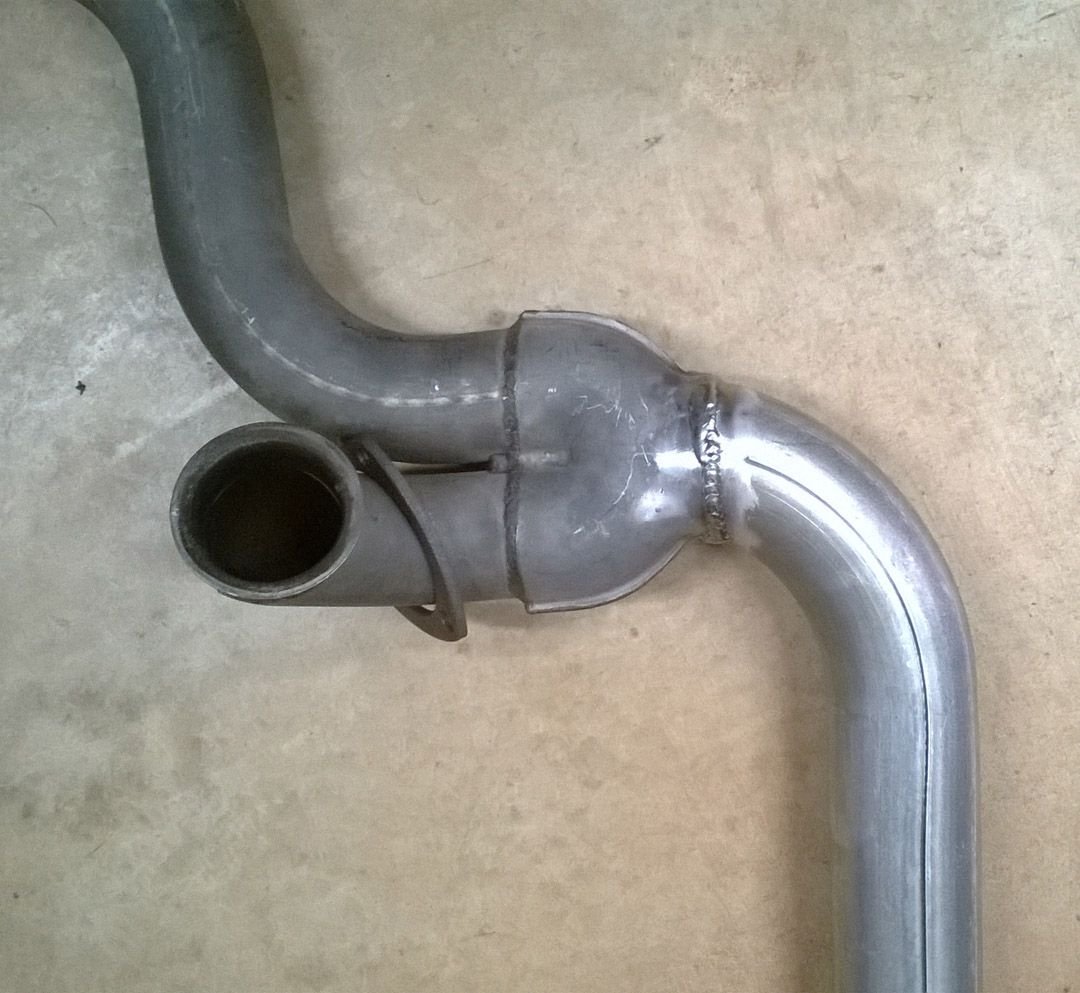

I modified mine to a 3" 2 weeks ago.
