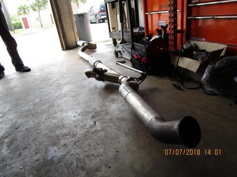

Some pics so you don't need to dig through massive build thread
This is the 3" exhaust composed of random stainless tube salvaged from various sources. Some of it was literally scrap on the floor of my friend's shop.
You want Thick walled as possible through the entire system to conserve heat energy which reflects in the exhaust gas velocity. It is ideal to dump the exhaust once it reaches approx 200-300*F because the low heat energy causes it to begin to condense, swirl (turbulence) which will hinder exhaust flow. If the system is built using the proper thick-walled exhaust tube, the exit temp at the tailpipe will be near 250*F~ or so. The muffler should boil water pretty much, thats how you know its hot enough for 'good' performance. I put a $37 cutout on it to mess around but it really isn't needed at just 500-600rwhp.
Use All V-bands on the exhaust system for easy access. I can disconnect my entire system with basically 3 V-band clamps and have the engine out quickly.
Position the turbo and exhaust with plug access priority. I can reach all 8 plugs and change them in 30 minutes- this is a necessity for performance cars.
The key to longevity, oil control, clean engine, is a fully factory PCV system like found on Toyota Supra / Nissan Skyline,
with short as possible hoses between compressor inlet and crankcase. A 1.5" Hg pressure drop post filter drives WOT pcv, using the turbo like a scavenging pump.
This is how all factory turbo cars are setup. This eliminates the intake manifold oil related issues (blow by being pushed into the intake manifold) because boost slams the PCV valve shut tightly at WOT.
Sorry to interject here I just wish you will see how easily done and the simplicity of turbocharging for reliability. I recommend aim for longevity with each component i.e. Low lift camshaft, slow ramp opening rate for valves, maintain low engine RPM redline, stock unmodified bottom end, high quality air filter, full PCV system, and the engine will last like stock 200k 300k miles or whatever, leak free. Then provided you have the right fuel system (I used $99 in tank fuel pump and 5/16" Hard lines support 600rwhp) just turn up the boost until target power goal. Once you wish to pass 600rwhp into the 800rwhp range there are several important details to reconsider but for just 500-600rwhp it is very simple setup and affordable.

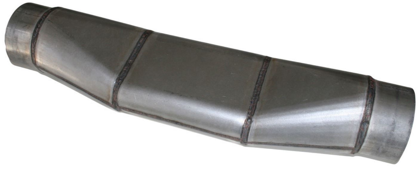

That said, there is one interesting approach. However, due to the packaging, it's not entirely fit-able under a third gen. That would be to work with the values calculated with a suitable software program (or trial and error like in the old days...does anyone remember painting the collector extensions?) and once a length has been established, somewhere along the 2nd order harmonics (~50" for the OP's car) you hang the right kind of muffler there. A glasspack style muffler would compliment the length of pipe for the overall dimension whereas a Flowmaster muffler would hang off of that 50" as it represents the open air reflective quality we're looking for.
Something you can fit on a vehicle with sufficient ride height but very difficult in a lowered 3rd gen. That would be known as dumps before the axle. Sort of like my old 68 Beaumont (Chevelle). Plenty of room there. Problem was I didn't know the science when that car was active.
One option I explored with the Camaro when I was at the chassis shop regularly was to cut out the rear seat pockets and flatten the floor in that area. Then the mufflers tuck up in there. A kind of thanks but no thanks for me.

Your 3-in single is really quiet compared to what you're about to get into. Anything you do to make the exhaust system naturally support a lot of horsepower is going to result in the exhaust system being very loud. My 3.5-in single has caused me hearing damage.
The way around that is large dual pipes with S-tube mufflers. Basically the exhaust system is so big that the restrictive mufflers aren't actually a restriction for your setup. But we don't have the real estate for that under our cars.
So that leads back to the cutouts. It pretty much always leads back to cut outs because we don't have the real estate for better things.
If you want duals then you could retrofit a 4th Gen dual exhaust into your third gen. At least the hard part of the bends over the axle will be done for you. Texas Speed, Kooks, Speed Engineering all have dual 3-in for the 4th gen. And they're all loud as heck... I mean super freaking loud.
The other way around the noise issue is 100 lb of sound dampening in the interior. You make the noise, but less of it gets to you.
The conversation always starts out with which exhaust system makes the most power and eventually ends with damn my car is too loud. You don't have a race car, you have a street car that makes a lot of power and you want to be able to enjoy driving it. Your ears can only take so much and that has to be considered.

https://www.g8board.com › threadsMid-Mufflers Delete - 36” Long Terminator Box | Pontiac G8 Forum
It takes a lot more work than most people would be willing to do to fit a terminator box, or boxes, under many cars. While I will always run one when I can, I’ve come within 0.14-seconds of uncapped with tuned torque tube (about the same or better than just uncapping) compared to a relatively straight 3” dual exhaust system with turndowns before the rear axle on my G-body car. I later swapped to a dual 3.5” exhaust due to the amount of nitrous I was running and while it only dropped a little less than a tenth without the nitrous, if you do the math, it put me within about 0.05-seconds of uncapped with the 3” torque tubes.

Best 4” stuff i found were the dynomax ultraflo rounds. They had two versions a 6” round case and a 9” round case i think it was at that time. Def much quieter than a bullet. But still loud on a high compression engine.
probably would try a bullet upstream in driveshaft tunnel area then a big ultraflow in stock location.
other better idea is 4” down the tunnel then split into dual tips out back along the frame rails, use ultraflo round 3” mufflers with 6” case. They fit but its tight

Spintech has some nice specialty pipes - oval with transitions that might come in handy.
https://spintechmufflers.com/oval-ro...t-tubing/oval/
Before I sold the IROC and was looking at running dual 3", I was looking at buying a couple of these and possibly cutting and extending the center oval section and/or putting in the bent oval tubing if/where needed. I never got any deeper than just an initial look under the car before I got an offer for it that I couldn't refuse.
https://spintechmufflers.com/frame-clearance-tube/

There may be more scavenging when exhaust is flowing undisturbed for greater lengths of a system than when it is cut short, as the still-hot exhaust is leaving the system before it can perform flow work on the exhaust valve
I've seen it in turbo cars, 2L engines with open downpipes vs the well designed Greddy style systems 3.15" full length exhaust,
the full length has been noted to improve spool character and increase top end breathing ability (higher compressor wheel speed, reduced exhaust gas pressure), which is strange since its usually one or the other

Exactly. Just think if the turbo application can take advantage of a full length system, what such a system could do for an NA engine. That was kinda my point.
Although it may have more to do with exhaust gas velocity and flow work than individual pulse tuning.
Both gas velocity AND harmonic play a role in scavenging and pressure drop signal presented at the ends of a tube where there is some flow.
It surprised me because I used to think that all turbos would prefer a drop in backpressure over any kind of lengthy system- but no. There is definitely a spool and subtle onset of increased torque with a cutout partially closed on my system for example (I tried with 2L and 5.3L same results), and less tire spin because the slight restriction keeps boost from suddenly increasing as fast as well. There is probably a bonus to pressure drop at the turbine because of exhaust gas velocity is good and pressure is lower due to low mass flow rate- remember that 400 500 600lb-ft of torque at 3200rpm where a good street turbo spools is only a few hundred horsepower or whatever worth of flow say 35lb/min, so it does well inside a limited, low flow pipe which isn't good for peak horsepower at just 35lb/min but supports incredible street midrange torque. And actually it says something for cutouts which open after a certain boost or RPM point trigger, where additional flow rate is required beyond some point, taking advantage of both low diameter and then large diameter systems. And this is exactly what the 1995-2002 Toyota 2jz-gte twin sequential turbo does, it uses 1 turbo exhaust at first and then brings the next online at some point using actuator in the exhaust, a 'cutout' except the cutout leads to another turbo.
Closed system ideal for starting from a dead stop- open system seems ideal when already highway rolling.
And it seems like the right exhaust length/design can enhance both.
IMO the harmonics are really important for headers, header length and size, collector volume. The Exhaust gas flow within individual tubes from each cylinder. The same way a TPI engine harmonics play a role- individual tubes with a collective plenum volume sort of thing. The effect is called 'water hammer' in the fluid mechanics book, and there is some great pictures of the pressure wave dispersion or disparity or whatever, it shows the low and high points, explains how it happens, and there is some math showing how it relates to a periodic function. I spent many hours trying to memorize exactly what it means but its not easy to understand from conceptualization of molecules point of view like I normally do things.
Once the exhaust hits the 'plenum' of the system the acoustics are supposed to bounce back towards the engine at that point. SO anything or any length of exhaust system downstream to that I would think will interact with the collector more than the engine in terms of downstream harmonics.
The exhaust gas velocity on the other hand- hot moving fluids can do work in the tube, even from great distance. Think siphoning energy. This is where I would concentrate my efforts if I had to run an exhaust system some great length, and especially if it was going to be changing size or shape at any point. You don't want to transition the size of an exhaust or intake pipe unless you have to, it tends to obliterate the tuning AND velocity, creates turbulence or pressure changes that have big picture impacts. It depends where we are talking also, like after an intercooler upsizing the intercooler pipe is fine becuase the intercooler is a giant turbulence factory and everything coming out of it needs to reorganize anyways.
And something else to be aware of. The speed of sound in a fluid is dependent on temperature. Any harmonic/helmholtz tuning calculations therefore must be done with some temperature in mind. Then, the system will function optimally near those temperatures, but it's character will wander as temp deviates. And exhaust tends to cool rapidly as it leaves a cylinder- there can be a large difference "differential" in the exhaust temp. Which is another reason why thermal barriers are so important- coatings, wrap, shields, blankets, etc...

BadSS: Wow, that round-oval-round pipe is super awesome. I expected it to cost WAY more than that price. If I decide to skip the cutouts, that might be the pipe I need (one each side) to get me past the trans-mount area. Awesome. thanks for sharing that. Also, I had never heard that phrase "by hook or by crook" until you mentioned it last week, and I found myself saying it just yesterday right as I was preparing to put in the fit header. I was like " well, I gotta make these fit, by hook or by crook!" and now its in my head!
