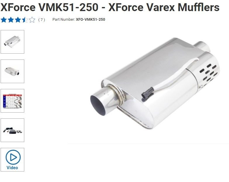

One other idea that is being used more and more by the OEMs is a progressive bypass built into the muffler. I don't remember whether the Holley Sniper has PWM output to drive a progressive valve?
I suppose you could do the same thing with the bypass mounted anywhere as long as the bypass has a pwm controller.

https://www.summitracing.com/parts/x...MaAqPuEALw_wcB
BRING THE THUNDER!

I see you guys chatting about those new style "variable" mufflers. Coincidentally, Stan just made a video only 3 days ago where he installed one of those mufflers and at the same time, got rid of his dual 2.5" exhaust pipes in favor of exactly what we are talking about here... a 4" mufflex system. What a coincidence!

That XForce is only one exit. When I mentioned a variable valve muffler I was thinking two exits so you truly get the additional bypass.
I went to the XForce website and it appears to be void of technical info. Maybe not a good sign....
