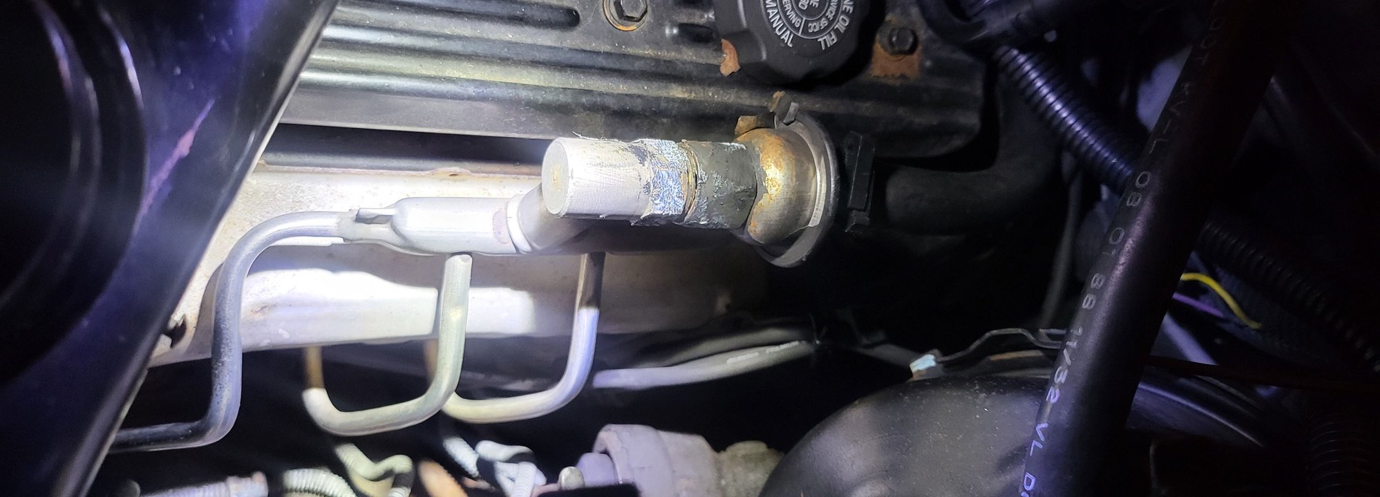

Broken exhaust
Good afternoon y'all, It's cheez it back at it.
So in the process of changing out the spark plugs we accidentally broke this piece of emissions crap on the drivers side. I think it's called the AIR bracket but I'm not sure (forgive me I'm new to all of this). I can't seem to find the bracket for sale anywhere without the manifold. Can this even be removed and if so how horrible is it. Also, where can I even buy it? Sorry for the multiple posts, I just want this car going. My friend suggests we weld it but I'm not sure. Any ideas? Car threw a 44 code as soon as the duct tape melted off of it.
my

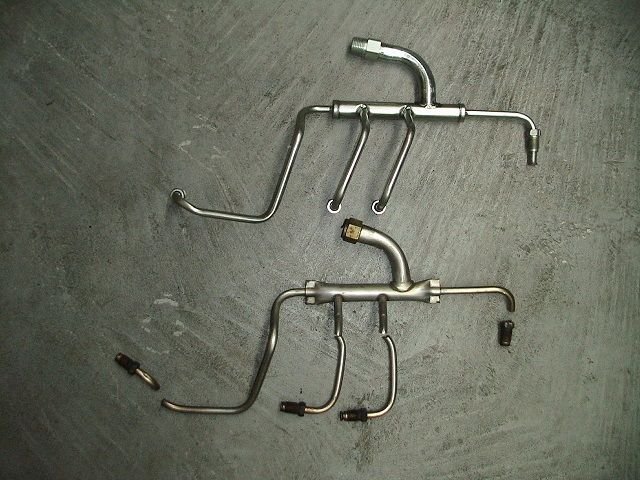

It is just an A.I.R. tube. Not too difficult to remove/install. You're lucky that it's the driver side so you have more room and accessibility. The four nuts can be reached with wrenches or a crow foot. I recommend using a line wrench or the flare nut crow foot. I've seen those nuts elongate. There are people here on TGO all the time that are removing them and tossing them. Post a thread on the Wanted section and you should be able to score some fairly cheap.
Oh, soak them in Knocker Loose or your prefered penetrant for a day or two before you try to remove them just to help them break free easier.

Is it the AIR tube or the check valve that is damaged? Hard to tell from the photo. If just the check valve, those are available new from RockAuto for $15.
Its the AIR tube, the check valve insides are all rusted out too.

Clean off the glue residue from the tape and JB weld it!
We don't talk about the glue That was from a very stupid but at the time, very improvised idea to just move it outside the garage to see if it ran right. (it did before it started farting and showing the SES). I might just end up JB welding it for the time being while we move it outside to clean up the garage.

Its looking like it won't be coming out without messing up the manifold and I'm not looking forward to the headache. We will be welding it to the valve and calling it a day.

Alright yall....I might catch some heat from this but the welding worked. We went to town on the valve and tube with a wire wheel to clean up the glue and gunk and covered everything else as to not get molten steel on it lol. For those who might read this in the future, I wouldn't recommend doing this as getting the underside of the tube wasn't fun. But if you have the skills and patience it worked for us. Thanks for the advice blacksunshine, transam and GT. I'm new to messing around with this stuff so getting to see different ways of going about fixing this helped.

What kind of welding did you try?
Typically that kind of thing doesn't hold up long term, good luck
Old Mar 29, 2024 | 12:58 AM
CheezeIt305's Avatar
Joined: Feb 2024
Posts: 41
From: Chicago area
Car: 89 Formula
Engine: 5.0 TBI
Re: Broken exhaust
We used a MIG welder on it. So far it's been holding up though. Hopefully it doesn't mess up lol
