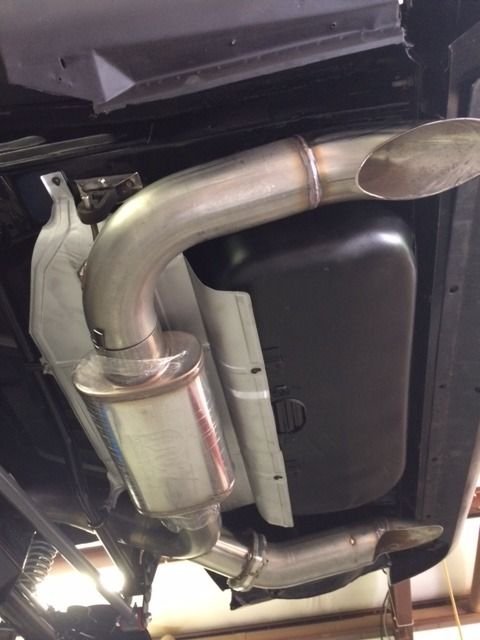

Go with the single 4". Easier fit, larger muffler, no drone. I'm running a custom fabricated 3" true dual and I hate it. The fab work is excellent and it will support any power level, but it's loud. I have cats, bullet resonator and spin tech mufflers. The worst part is the heat transfer into the floor and the drone at steady state cruising. With a dual setup you take up any free real estate which limits muffler size. I wanted the perfect setup and paid dearly for it. I underestimated the drone. It's beautiful, but painful to drive. I could have had a fully optioned fabricated 9" rear end for the price I paid for this exhaust.
I appreciate that bit of honest feedback Shifty. I can't say I'm a fan of the current crop of dual exhaust although it's great that there's some interest for our models. It's more the muffler placement that bugs with them tucked up at the rear. Truth be told, I'm not really a fan of the traverse muffler either having grown up in the muscle car era and having the real estate for a couple of turbo style mufflers forward of the rear axle. But it is what it is. The single is certainly less complex.
I'm no stranger to the cost of having something custom fabbed up. I don't recall exactly being twenty years ago, but the header modifications (Hedman long tubes), stainless 2 x 2-1/2" to 3'' y-pipe and crossmember slice and dice wasn't cheap. I will say though that even after all these years and countless removal and reinstallations, that it still fits like the day it was built despite it taking a couple of hefty hits. If and when I ever upgrade, I'll remove the entire system, headers to tailpipe, and save it as a complete assembly. I'm sure I could get some ROI selling it too.
You mention volume. As in loud. That's something that I think would be more of a problem with one muffler. It has to have sufficient capacity so as not to limit output. Like 900 CFM worth of capacity in my case. In the single muffler world that equates to LOUD. Or at least the research shows.
As for your drone, wouldn't a change in muffler architecture alter that?
As for Mr. Q and his results. I'll bet he's down 10% or more with that arrangement. Take 570 RWHP, factor in the drivetrain loss and at a minimum that's 650+ at the crank. 1200+ plus worth of system airflow before it starts to cork things up. I'm not sure that one 3.5" pipe and whatever muffler is in there is capable. That said though, we all know that his 570 at the tire is more than a handful on the street. Where would another 80 HP get him? (If it was me, I'd have a track specific deal and, as the saying goes, let it eat.)
Speaking of which, as an alternative to a bigger pipe for me, I do have plans to cut into my fancy y-pipe and place cutouts in an appropriate place. The I can tune the secondary length and have open headers on track days. I'd still have a crippling exhaust for street duty but then again, I can't say I'm much of a street racer anymore.

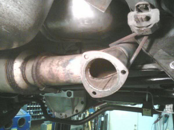

I always figured that 2 x 2.5" would more than satisfy my output. Something that could be an everyday thing and not track specific.
Looking at the single, and the muffler volume notwithstanding, a 3.5" might get it done too.
Just have to look deeper into what muffler spec is available. I've seen Mufflex, Spintech, Flowmaster, Borla and Magnaflow all in this size range. Race duty rated as well (and that probably = LOUD).
I'm running a single 3" now and into a Flowmaster low series muffler. I'll bet the CFM is 300 at best. IIRC, it's an American Thunder series from 1998. Who knows what muffler that really is.
I put in a cutout right at the bend after the axle and before the muffler. Taking off the 3" cap on track days yielded a gain of 1.5 MPH in the 1/8th. One glory run with no tuning. Just point and shoot.
That says a lot to how crippling the current arrangement was, and still is. And that was with about 100 HP less that I have now.

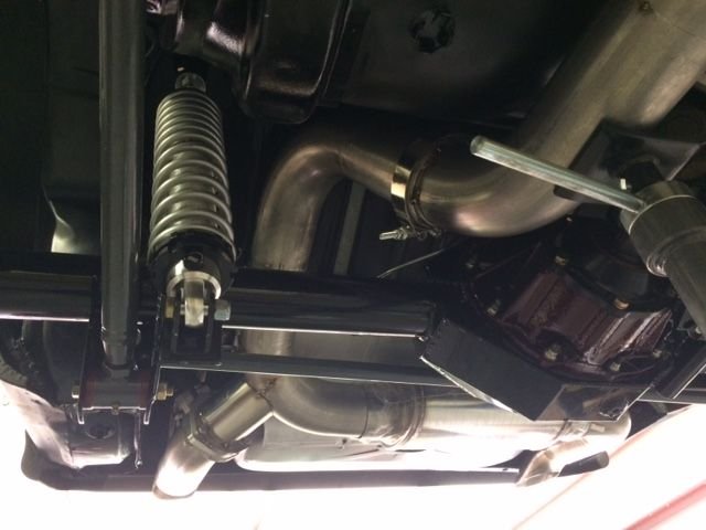

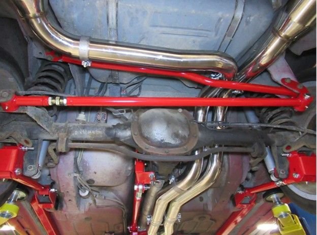

I've had this 3" Flowmaster cat back for decades and it was direct and easy swap. That what's in the picture above along with the 3" cutout I described.
For the 4" or duals over the axle, the panhard bar relocation kit is required so as to open up that area.
Just another piece of the puzzle!

My 3.5" fits with stock panhard.

That's another pro in the pro/con process. One less part to buy (panhard bar) and from own bit of research, 3.5" would be enough pipe for this engine (although because of the length and bends involved the actual flow capability is difficult to calculate). The muffler would be the key though. And that's a volume vs flow thing.

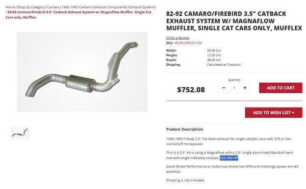

Over at Mufflex, anything listed at 3.5" is capped at 400 HP. Even their 4" offerings state 400 HP. Some of that though appears to be muffler dependent.
https://mufflex-performance.com/16-1...gle-cat-system
https://mufflex-performance.com/18-1...gle-cat-system
Those listings are all single cat versions. The dual cats don't indicate an HP threshold. Maybe there's something to that?

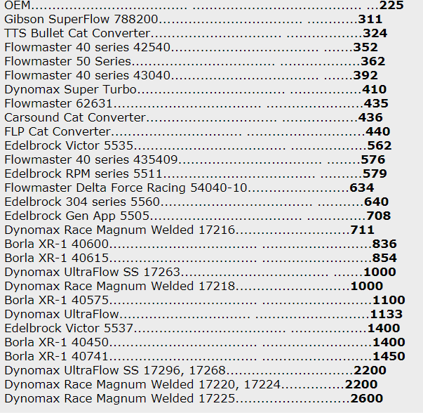

Then there's this bit of internet data I gathered twenty years ago.

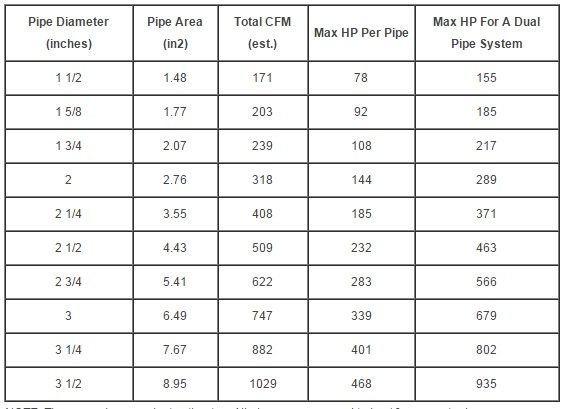

And this:

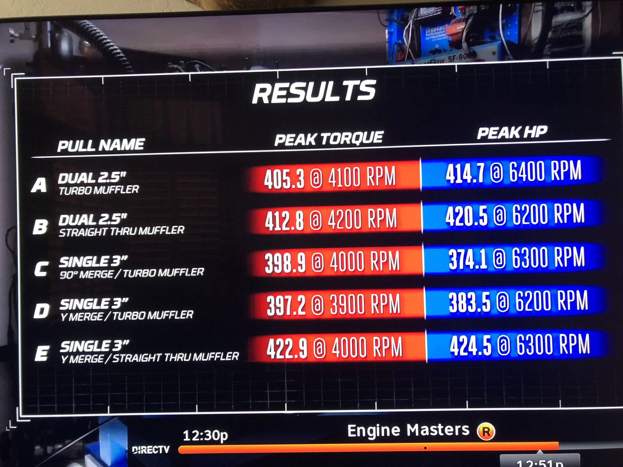

Something to consider for context is since an engine is an air pump, if your exhaust size at least equals your intake diameter you should be fine. The intake is at ambient pressure and the exhaust is pressurized so there is savaging. Adding boost only helps. No one would run stock exhaust manifolds, but with boost physics takes over.
Those sizing charts are probably just for reference. The greater the compression the greater the delta between intake and exhaust. Those charts likely don't take that into account.

What I'm seeing there is a 10% swing in output based on the muffler alone. I'll take 40 HP's any day of the week.
Which is something I've mentioned here more than once.
I do wish though that Engine Masters was somewhat more scientific. At least comparatively speaking. Where are the merge collectors on the dual exhaust? (I suppose being able to watch the video might answer some of that).
To give a sort of comparison, these are the results from the capped/uncapped back to back tests I did during an 1/8 mile afternoon of racing. (Single cutout picture posted above)
Not quite as pronounced as the video's results but certainly the performance gain was there. The muffler was still in play but part of the exhaust exited before it got there.
The engine in that car would produce about the same results as EM in dyno trim.
While the air pump analogy has it's merit I don't think it's entirely accurate. At least not in the sense of air in and air out being equal. Think of the two air streams. Cool air coming in moved by the difference in atmospheric pressure against whatever suction is created with piston moving down (as well as whatever scavenging is produced by the open exhaust valve at overlap) mixed with the further cooling effects of the fuel (carbed NA) vs the blisteringly hot and very high velocity air leaving the engine exiting under the residual combustion pressure and the piston moving up the bore.
Makes you understand why you can feed an engine to 500 HP with 4 x 1-3/4" butterflies, yet it takes 8 x 1-7/8" exhaust tubes to get it out. Not to mention the dynamics of rapidly cooling exhaust gases and how that has to be accommodated in exhaust design. Witness stepped headers.
PipeMax can give some great insights into how the induction side in terms of CFM differs from the exhaust side. Of course there are many dynamics to consider but in my thinking, it's not exactly air in = air out when you factor in temperature, density and velocity.
But like the induction side, you don't want any restrictions to airflow in the exhaust (although the intake port itself is somewhat complex in terms of shape and cross section). That can be seen in the Engine Masters results posted above. The straight through muffler wins.

My car is twin turbo, so the power numbers aren't apples to apples, but I have two three inch down pipes into a single four inch and Magnaflow muffler. I added a cutout to control the sound. It’s not loud at all (again, because if the turbos).
I had to use oval sections for my downpipes, as they ended up being the lowest part. No ground clearance issues for the 4” section.

That's a very nice setup. What muffler are you running and is that a Midwest chassis rear?
Magnaflow 14153
Yes, it’s a Midwest Chassis Rear

Here's mine. Although not as nice as tomsaddy's
https://www.thirdgen.org/forums/exha...de-4-inch.html
Dynatech split flow. Ive never heard it outside at wot, but im told its quite loud. I love it. Idle sound burbles like a through hull boat exhaust. In the cabin wide open sounds like a cross between a vette and a asphalt late model. High pitched but not raspy if that makes sense

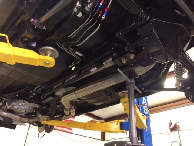

I also went with a single 4" over the axle.
https://www.thirdgen.org/forums/exha...e-exhaust.html
I went 128 mph NA , thru the exhaust, and 147mph with nitrous, also thru the exhaust.
So 4" can handle big power.
3.5" collectors, merged to a single 4".
I also used oval pipe after the collector to save some ground clearance.
