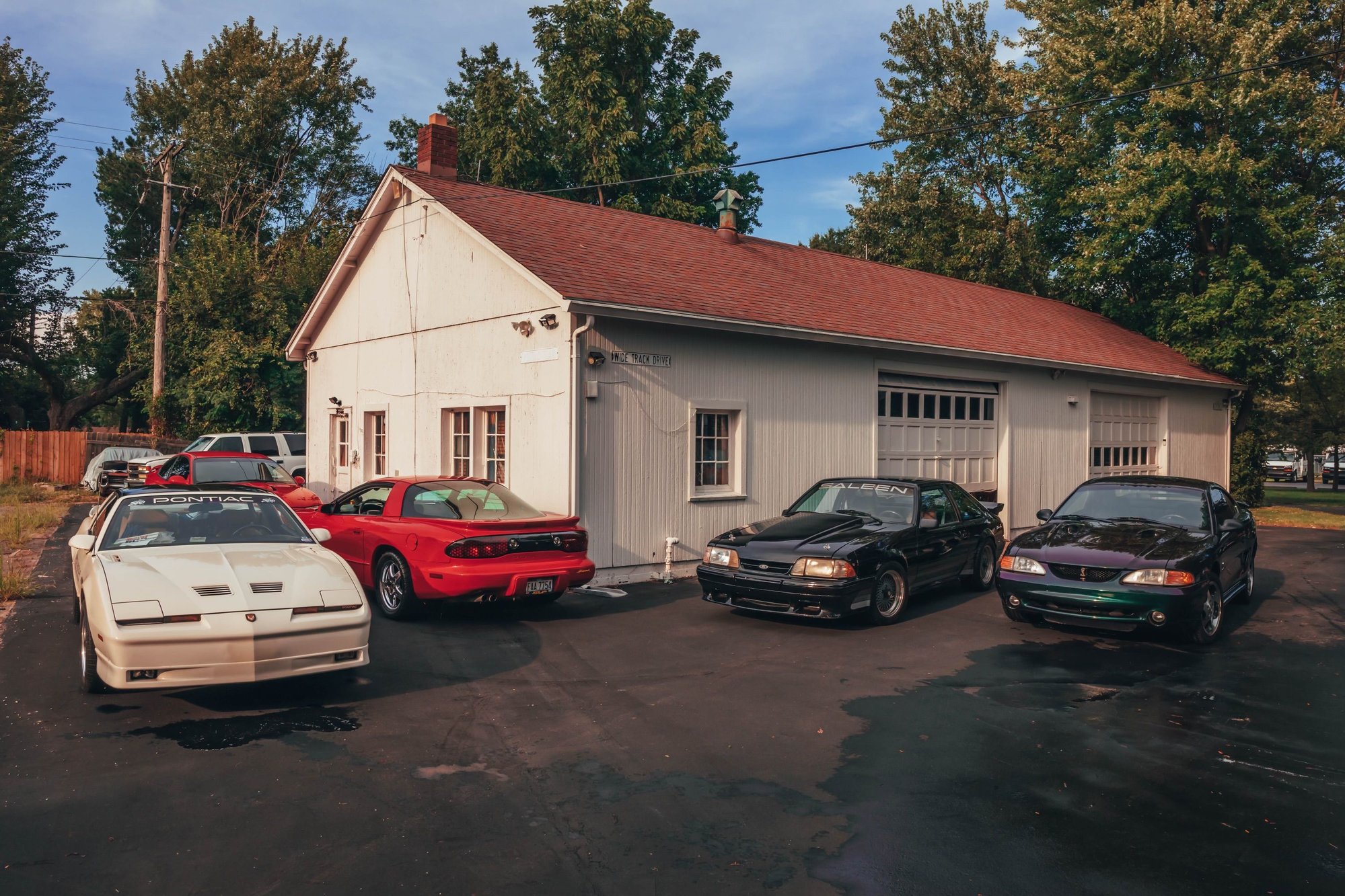

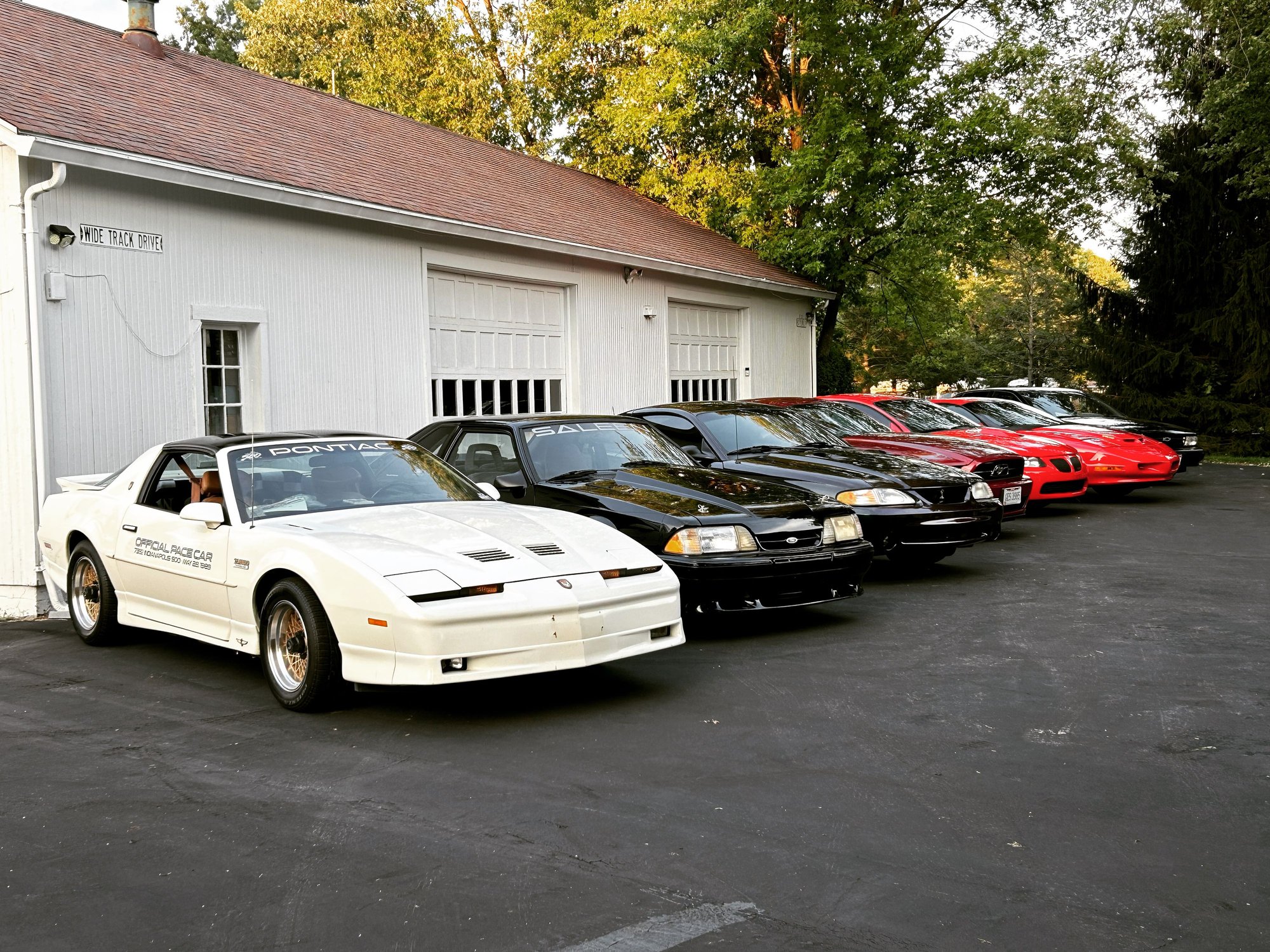

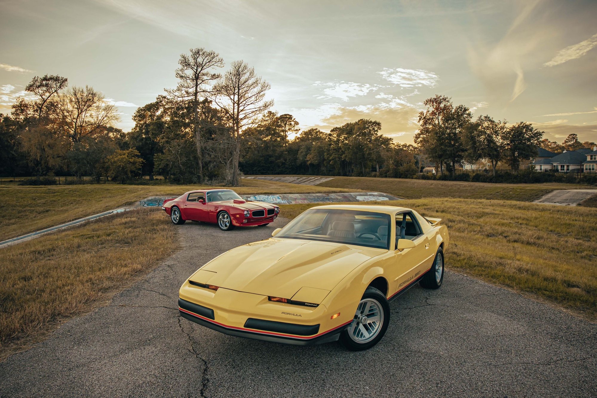

Thank you for the comments on the Formula! I’ve wanted that car since I bought my 87 GTA in 1994. There just aren’t many yellow 350’s… I think like 100 in 87 and a few in 88? Several more with the T tops and 305 but I like the look of the hard top and of course the bigger motor.
as far as the Magnaflow goes it’s the tips- makes the car look like a farm truck to me. They are hard to even look at. the sound is actually fine, although I do prefer the flowmaster sound. Everytime I buy something besides Flowmaster I regret it. Dynomax, Spin Tech, Pypes…. Always regret it.
Great call on the y-pipe. I will order that.
the TOTL is an extra original one I bought (when no one wanted one) for my 95 Firehawk. It still has the original tail pipes on it.
the Magnafow should be complete with the muffler and the god awful tips.

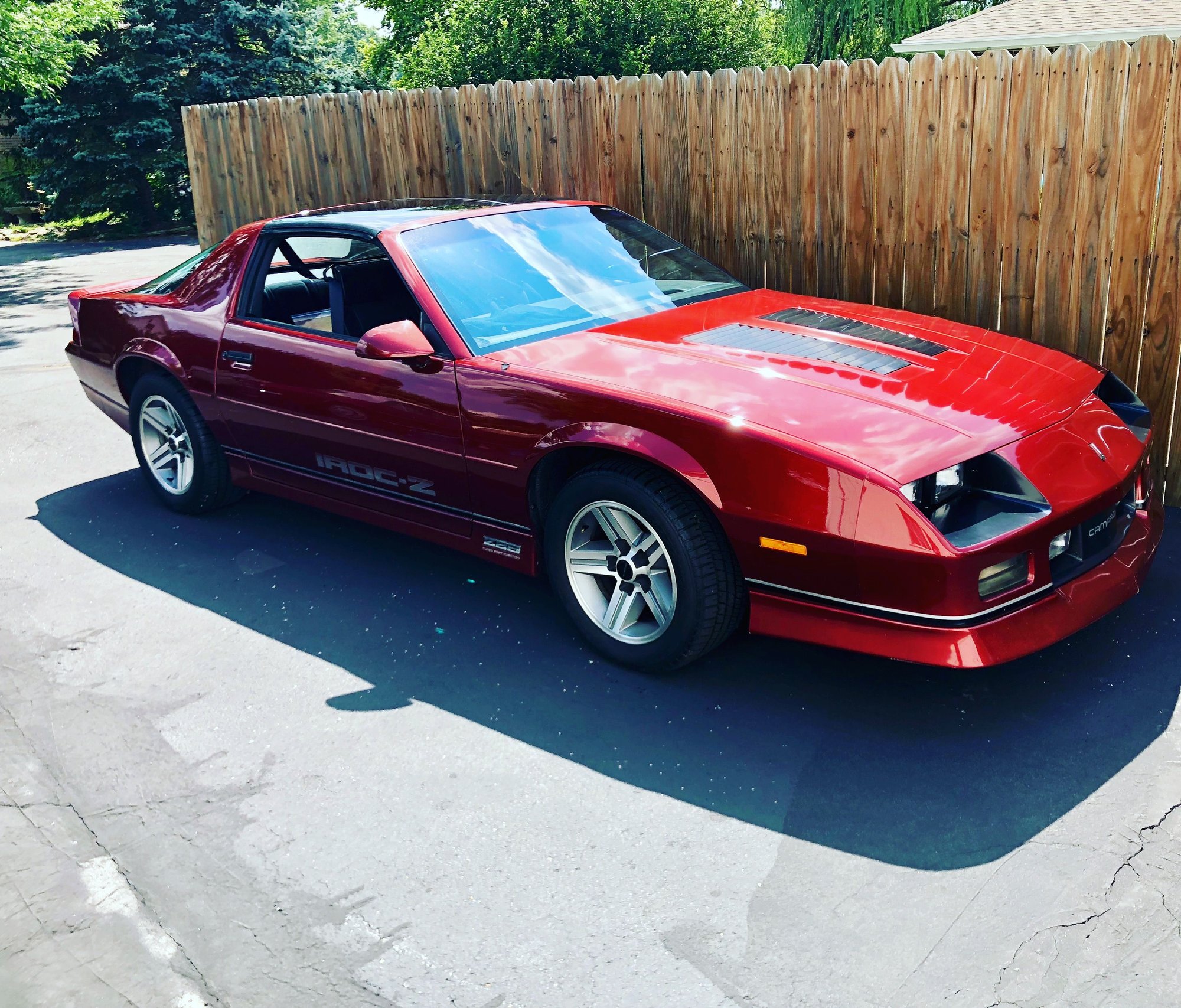

the Iroc I’m working on is my dads. We are the second owner and I think it has 60k miles. The old exhaust just rusted out internally in the muffler.
here are some pics of those two and a couple others we have.
