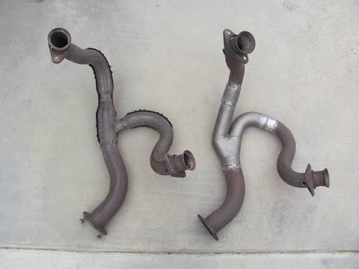

I saw the video clip on Youtube last night, then this thread today. The old exhaust was absolutely the cause of the wavy power curve. Just had an exhaust that was overly restrictive at the muffler doing the same thing. Even the raw mass air flow sensor data was wavy and it sounded like an old Hoover with a full bag at WOT. That exhaust is definitely visually impressive and sounds great. I like that it is valved as well. That being said a dual 3" to single 4" merge Y system likely would have made even more power than the dual 3" system. The old Y-merge was horrendously bad and the 3" single pipe was choking that 6.2L much the same as a dual 3" inlet Walker Quiet Flow was choking my 383. I went right up against the outlet of my 3" high flow cats, added this Howe Y-pipe behind it and immediately into a 4" core 30" long AP truck muffler and 4" tailpipe. Runs far better and sounds better as well. I knocked over a full second of my 0-60 in an undergeared, 7,000 lbs brick before even touching the PCM tune.
I have also seen the results of changing out only the Y-pipe on a Ford V10. The factory Y-pipe dyno curve looks like a 8.0 earthquake. After the Y-pipe is replaced it is far smoother, the power is significantly increased across the whole RPM range and the weird dips and valleys are eliminated from the curve. If you are going to run a single exhaust it better have a nice smooth transition, an adequately sized pipe and a muffler that flows enough CFM for the power being made.
