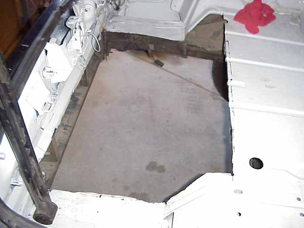

yeah , yeah im a hack, but it makes more sense to me to install an access panel that i can use anytime i need to work on the fuel pump or change it, than to drop my axle, cut my exhaust, etc etc......in a 91 bird is it smack dab in the center on the flat hump in back where i want to cut?i noticed some wires going into a plate on the up slope , is this the pump power wires? btw i have no back seat so id should be relatively easy.........

check out the fabrication thread, there was a long debate on that. personally I think it is a great idea, just be careful. next time I have to do my fuel pump thats how I'm going to do it. come to think of it if you do that why not write a tech article of some sort.

For what it's worth, as someone who's had to drop the tank twice already, and will have to drop it a third time (next pump will definately be a GM- borg warner pumps suck!), it's really not that bad. You shouldn't have to cut your exhaust; just undo the bolts that hold the intermediate pipe to the catalytic convertor. When you lower the axle all the way down, the whole exhaust system can be pulled out from the back of the car.
That's actually how I tell guys to install their aftermarket cat-backs if the systems come with a one piece I-pipe. Takes a little bit of time to lower the axle down to the ground so you can slide the new i-pipe under. Takes about a day to mess around with jacking the car super-high using jackstands and wood and an unstable car just so you can try to "hang" the i-pipe over the axle. It's so much faster to just lower the axle down to the ground. But anyway, I'm rambling...

I don't know why this door wasn't there from the factory. I had an escort that had a fuel pump door under the seat. Easy access. It took me less time to install the engine and get it running than it did to remove the gas tank.
I feel this is a worthy "mod" to the car. If I had known how big of a pain in the rear it would be to drop the tank I would have. The only problem i can see with this mod is the fuel lines coming out of the tank. It may be difficult to get the pickup out of the tank.

so is everyone pretty much agreed that, if done right, it isn't a hack job and can be a decent mod. (only if nessacary of course)
how would it be done w/o being a hack job?

I think it also can be a worthwhile mod if its done right. But my opinion is if you have to ask about how to do it, you shouldnt try it. I also think that I would do it if the tank was out. That way you can see what your are up against, and not cut into the tank. An aluminum door would be trick.

GM only didn't do it originally because they were unconcerned about having warranty problems with fuel pumps. To be cheap, honestly. GM also makes some cars where you have to hack the casing (literally, with a hacksaw) to replace the heater blower motor. It's in the factory service manual, and that is somewhere that you will see every time you open the hood.
I would go to the junkyard and make a cardboard pattern on one that is already disassembled. An access plate that attaches solidly to the body with screws and is sealed with silicone would be fine. Nobody would ever know it was under the carpet except the guy sitting in his living room with his family instead of thrashing around under the car for hours with rear axles and exhaust systems while getting rust and dirt in his face for a 15 minute job otherwise. One mans hack is another man's improvement.

ok man, heres how it goes. I've dropped the tank before, it isnt that bad. If you want to spend all the extra time to do it your way then fine, but dont ask for opinions and then be a ******* about it when you dont here what you want to.

is this what you guys call fabrication...LMAO....gotta love your good ideas to make things easier..LOL
Attached Thumbnails installing access door for fuel pump-fuel-pump-trapdoor.jpeg
