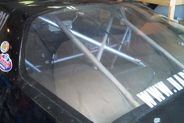

More pics.
The windshield is out. Here's a bunch of pics looking in through the windshield.

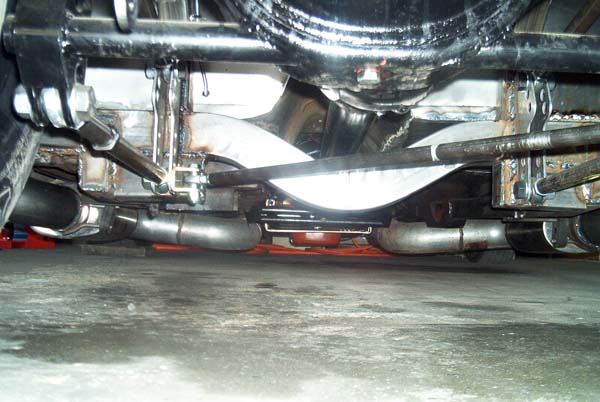

Here's what the exhaust turnouts now look like. 4" outlets coming out just below the rockers. The passenger side looks the same but there's isn't enough room for me to get a good picture of the side.

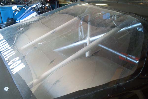

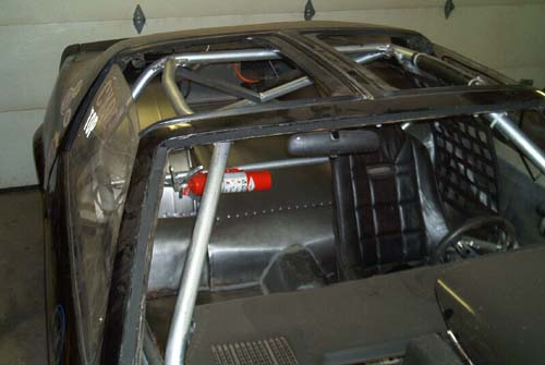

I got some new pics!
First 2 are looking in through the back window. There a bit of glare off the Lexan but you at least see the tin work.
The third picture has the camera almost sitting on the floor at the rear looking forward. There's a flash glare off the crossmember that I can't edit out.

OK, Now this doesn't look great but should still work. I only took pictures of the passenger side tire because the driver's side would have been in shadow. The driver side wheel opening looks much better than the passenger side. The factory body is not symmetrical from side to side.
Although the opening looks tight, it's an illusion. The tire is actually inside the rear part of the opening. The ground effects make it look like the tire is closer to the fender than it really is. There's actually 1 to 1-1/2" between the tire and the closest piece of fender. Behind the ground effects, the metal part of the fender has been trimmed back. A wheel opening that's been properly opened up would look better. That requires more sheet metal work than I want to tackle.
The last picture is just another shot of the passenger floor.

A pic showing ground clearance. The camera is sitting right on the floor. 4" exhaust outlets. On the right side of the picture you can see my SFC welded to the underside of 4-link crossmember.
Last pic just showing the rear. You can see the pipe coming out the back for a future parachute mount. I don't need it yet but during construction, it didn't take much to add it in. The battery master switch mounted to the right of the license plate. Skull and crossbones license plate to match the car theme. Boost posts to easily boost the battery without having to take the deck lid and battery box top off. The factory lettering on the left side still says "5.7L Tuned Port Injection". On the underside of the bumper cover you can just barely see the air ports when I ran air bags in the springs years ago. I just never took them out of the cover.
