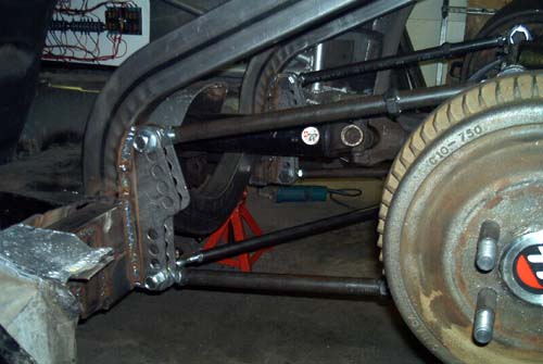

After a lot of measuring, using a level and plumb bob to find centerlines, the frame rails were trimmed to length then welded in.
I wanted the front brackets lower than what would be considered normal looking. The goal is to have the bottom mount hole 6-8" from the ground. To do this I needed to run the brackets below the crossmember. An extra piece of crossmember was welded underneath to provide extra support. The front mount brackets were then welded on and all the bars installed.
Attached Thumbnails Back Half Project-front-mount.jpg   Back Half Project-bars-installed.jpg

The rear frame rail mounts didn't turn out exactly the way I wanted. The plates were welded to the rear of the car. AFTER both frame rails were welded to the plates I discovered my rear centerline was off. There was no way I could cut the rails right at the plates so I just cut them back about 6 inches, repositioned them off the proper centerline then welded a section back in. I would have liked to have them lower, more inline with the bumper height but they're not weight supporting at the rear. They hold the rear sheetmetal up. The roll cage tubes (still to go in) support the frame rails.
Attached Thumbnails Back Half Project-cardboard-tub.jpg   Back Half Project-rear-frame-rail-1.jpg   Back Half Project-rear-frame-rail-2.jpg

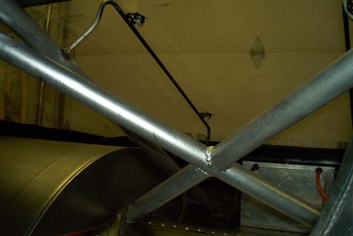

One last pic showing the the rear tubes right at the rear of the frame rails. I was considering installing a battery tray between the frame rails but decided to make a parachute mount in there instead even though I don't need it yet. The battery tray will mount off the outside of the passenger frame rail.
EDIT
Here's the parachute mount. I need the clevis for the end to make it complete plus a support to hold the chute. I'm a long way from needing a chute but it wasn't hard to install the mount at this time. The floor tin will go across the top of the frame rails and with some battery supports under the tin, the battery box will be mounted on top of the floor in the center.
Attached Thumbnails Back Half Project-tubes2.jpg   Back Half Project-chute-mount.jpg

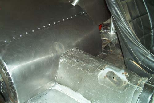

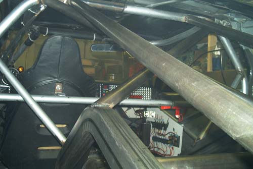

The main part of the tin work is done and the tubs are in. The front and rear part of the tubs still need to be sealed off. That's going to require more tin work.
Don't expect to have a back seat in a third gen with a 4-link.
I was thinking about the 31 spline question again today. Another thing to consider is that even though Comp788 and I both use 32 x 14 tires, he has a 4 speed with a deep first gear to increase the torque multiplication to the tires. I only use a 1.76 powerglide so I'm not putting as much torque to the wheels. If I had a low first gear, I probably would have upgraded to 33 or 35 spline axles. If these 31 spline axles get damaged, 33 spline is the easiest upgrade.
Attached Thumbnails Back Half Project-tin1.jpg   Back Half Project-tin2.jpg   Back Half Project-tin3.jpg

Finished the tin work behind the tubs today. Under the battery box between the frame rails is some 1" angle iron that supports the battery box. The battery still needs to be installed and cables routed. All the tin has been sealed with caulking. The tin work at the front of the tubs is going to be a little more difficult because of the multiple angles and the required access to the front 4-link mounts for adjustments. I'm still pondering the best course of action for this. In the first pic, you can see the aluminum channel I use to hold the Lexan rear window. Yes I'm doing this back half with the window still attached to the car. It's a lot of work to remove it.
Attached Thumbnails Back Half Project-reartin1.jpg   Back Half Project-reartin2.jpg   Back Half Project-reartin3.jpg
Stephen,
Nice job and looking good. Is this the first car that you have balk halfed? I have done a few and it is a LOT of work. The pictures might give some of the poeple a false idea and think it is a weekend project!
One thing is I was not using a 32' x 14" tire in my Dart. I was using a 28" x 10"
BTW the tin looks really nice. You had said that your doing this at home in a two car garage or car port. What do you have for tools??
Old Jan 1, 2007 | 11:25 PM
AlkyIROC's Avatar
Posts: 17,274
Likes: 171
From: 51°N 114°W, 3500'
Car: 87 IROC L98
Engine: 588 Alcohol BBC
Transmission: Powerglide
Ahh. I was under the impression you were using the bigger tires.
This is my first and hopefully last back half project. After consulting on other forums, to have a chassis shop do this, expect to pay $5000-$10,000 to have something like this done not including the narrowed diff.
The tin work isn't show car quality but still looks good. It sure looks better than the aluminum on the inside of my doors. The "between the frame rails" tin should have be rolled over the edges and welded along the frame rails to be hidden by the tubs etc. So I have a lot of pop rivets holding all the tin together. It still works. The tin also doesn't have the pretty bead rolls.
Inside a cramped 2 car garage big enough to hold one car. My Harley takes up part of the other bay and tools and parts take up the rest of the available space. I use a 110v MIG for the welding. The high setting can run a nice bead with good penetration on 1/4" steel. Other than that, a bunch of power tools such as a reciprocating saw, 4" disk grinder and a couple of drills. I have a jig saw but never had to use it. All the roll cage tube notching was done with the disk grinder. It just takes a little longer with lots of trial fits. The sheet metal is all cut with tin snips. Power shears would be much nicer.
It's definitely not a weekend project. During the holiday weekends, I've been at it on and off for 7 days now. I figure I have another 2 or 3 weekends before I can consider it finished. Looks like the wheel openings only need to be trimmed slightly so major exterior body work isn't required to open up the wheel openings. It would look more factory if the rolled lip extended all the way to the bottom of the openings. I still need to run brake lines to the diff. That could take a while to figure out the best way to do it.

I did a little more tonight but no new pics. I welded bolts to the underside of the frame and on the roll cage tube to provide a place to mount battery ground cables. I then installed and wired up the battery but still need to secure the wiring that goes up to the front. I welded 1/4" rods near the bottom of the quarter panels behind the tubs up to the frame rails to provide support so the fenders won't vibrate. I also added a small section of sheet metal at the front of the drivers side tub to seal it to the quarter panel and right down to the rocker panel.
Tip on installing tubs. The tub needs to extend down as far as possible in the front to reach the rocker panel. Any excess around the 4-link mount can easily be trimmed. The rear of the tub only needs to go just below the bottom of the frame rail. It doesn't need to extend down to the bottom of the quarter panel. The rear floor, installed above or below the frame rail, will seal up the back.

I wasn't as productive this weekend but still got some stuff done.
These picture show the backside of the tin work at the front of the tubs. You need to have enough room to access the front links for adjustment. Because the crossmember is forward to my main hoop, I wanted more bracing for the plate that the hoop is welded to. This became a simple fix by welding a piece of crossmember tubing from the crossmember to the rocker panel then welding the plate to the brace. Unless I go with some stupidly tall tires, there will never be a clearance problem. You can also see how much I trimmed off the front of the wheel openings to allow the taller tires. All the seams have been filled with a caulking. One, to seal up the gaps between the tin and two, to help hold the tin in place. Unless it's all welded up solid, there's only so many places that it can be attached with pop rivets. This isn't a show car. Just make it functional.
Attached Thumbnails Back Half Project-front-tin1.jpg   Back Half Project-front-tin2.jpg

Here's what the front tin looks like from the top. I had all week to decide the best way to do this. Finally I decided to make a rounded 3 sided box. Typically, the roll cage main hoop is forward or on the crossmember and these front pieces go right out to the quarter panels.
Attached Thumbnails Back Half Project-front-tin3.jpg   Back Half Project-front-tin4.jpg

I'd like to see a picture basically from the driverside mirror view, if possible. Most of your pictures are pretty close range, so i'm not always sure what i'm looking at, perhaps a "whole picture view"?

The tubs were a kit. That part I didn't want to fabricate. Once you cut the tub to the cardboard pattern, it's attached to the inner part with what's called a Pittsburgh seam.
I didn't have to bend any tubing. The roll cage was originally a Jegs kit. I just needed to redo the rear bars. Those are all straight. Notching with a 4" grinder isn't hard. Takes about 5 minutes to notch a tube. The tubing I did have to cut, I cut with a reciprocating saw (Sawzall). Accuracy doesn't need to be 100%. It's easy to mark a circle around a tube. Wrap a piece of paper around the tube and square up the ends. Draw a line around the edge. The frame rails are generic prebent frame rails. The majority of the rear chassis is Competition Engineering parts. Every time I bought something else, I got another set of decals. I could cover the rear quarter fenders with CE decals I have so many of them.
Until the car becomes mobile and I can get it out of the garage, those are the best pictures I can get. Driver side mirror view? You mean with the camera sitting where the mirror is or from way behind the car looking forward? You can see the door to my garage right at the back of the car. I scoot between the car and the door to get from side to side. With the door open, you won't get much to see as it currently sits. Once the tires are mounted and the car is outside, I'll have more and clearer pictures under natural light.
If you want a larger version of any picture to see more detail, I can send you the raw, unedited pictures through E-mail. The raw pictures are 1792 x 1200 pixels and 700-800 KB each.
I don't have any of these pictures on my web site yet.

oh yea, sure thing. I mean basically set the camera on the drivers side mirror, and snap a picture of the interior of the car, just so you can see the whole interior.
Once it's outside and in some light, no rush, I was just curious.
ah, prebent frame rails, cool. It's interesting seeing what's available on the market, when you know where to look.

As for the mirror picture, I don't have mirrors They were removed and the holes filled in many years ago. I plan on replacing the Plexiglass windshield with a Lexan one within a few weeks. The Plexiglass developed some cracks last year. When the windshield is out, I could take a picture looking in from the front. I don't think you'll see as much though.
