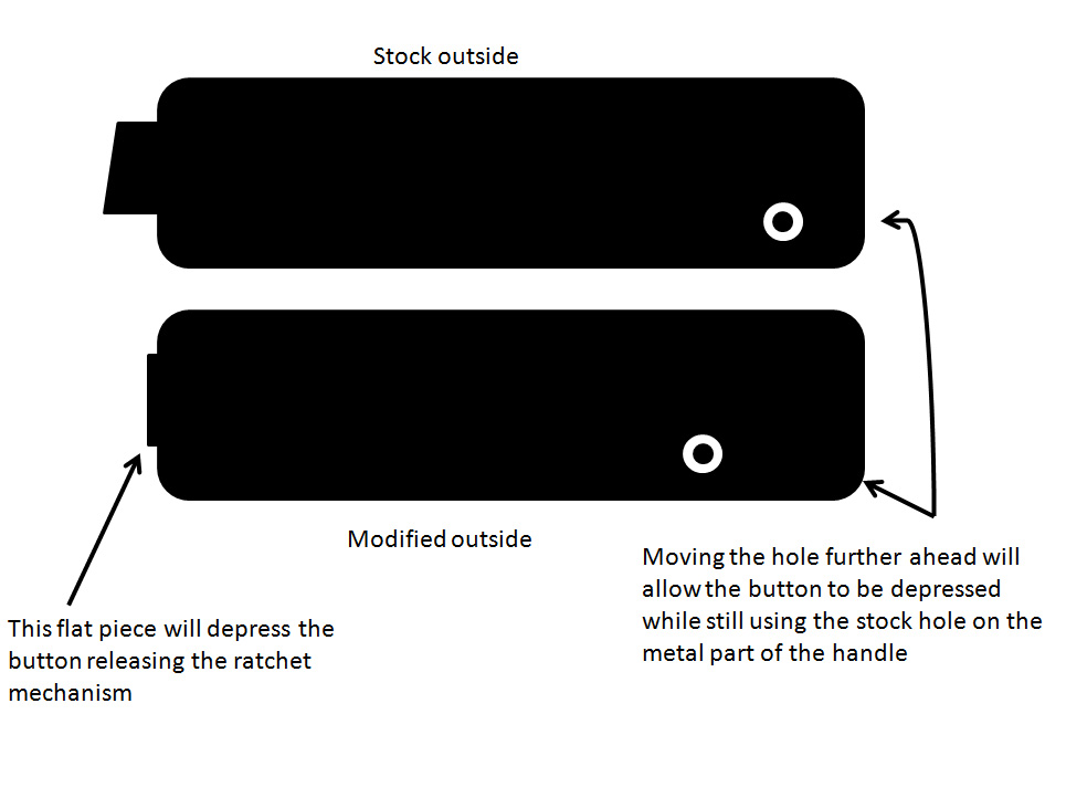

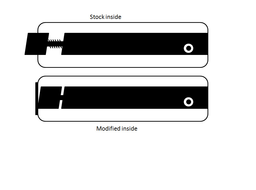

I was thinking about this. What I came up with is if you have any metal working skills you could build a handle that slips over with a pint to hold it in place and a cap so it hold the button down without the chance of it letting go. Another reason this would be good is that you can make the handle go anywhere that is comfortable for you to grab fast. Can't remember his name, but the guy that drives the Viper Drift Car, if you have ever seen the inside he has a fabricated handle along with the stock. It is located and shaped so he can comfortably grab it quick.

i agree, in vw bugs, they do this all the time in the sand. They typically have two handles up to three. they are remotely connected to the brake line itself i think. When one pulls up on the right handle the right side of the car slows down only, vice versa with the left handle. I work on a bug all the time and i come across these mods, www.CBperformance.com has them to check out based on the engineering design of it. i would be surprised if theres a company who makes these specific brake levers for circle tracks

the cover is a great idea! i wouldve never thought of that. im no expert in metal working. but i can give it a shot

I put in a pic of the handle idea. I got mad powerpoint skills.

nice work! haha mad powerpoint skills.....
but yeah this is a great idea for now

i just though of an even better idea IMO. not that had a bad idea...
im thinking i can just go to a junkyard and buy the stock piece that comes off of the ebrake handle. take the leather off and attach a flat piece to the button end of it that will depress the button when slid over the handle. but then i will have to move the hole forward towards the button end to allow for the distance on the buttons travel... right?
like this...
