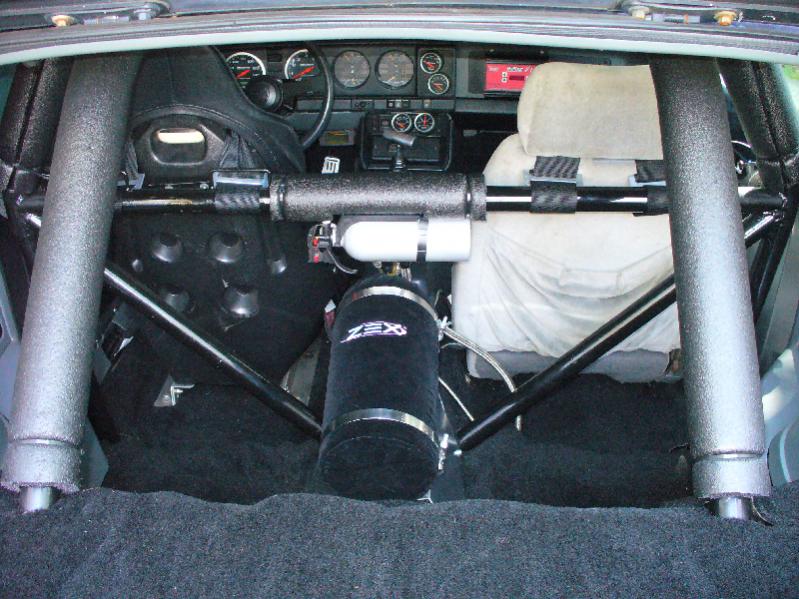

Once I put my nitrous gauge on there too, I'm going to trim it some more.
Under your center air vents with a individual pod is what I did.

pic through the hatch you can see a little better. All gauges use an angle ring to face all the gauges at me. Through the dial lighting at night makes it look sick!
haha! yess! thats awesome man! looks well organized with some bad assness!what is that big red box onyours used for? with the silver tubes coming out?(sorry,im just starting to get into working on these things)
how hard was it to swap the shifter in and are you running the stock automatic transmission?
Quote:
Thanks, its great looking at night and easy to read. The red box is my mallory 685 ignition box. Its in the cabin bc its not weather proof and It has pushbutton controls that allow me to change the start retard, Rev limiter, aux (NOS) rev limiter, RPM window switch (NOS and meth/water injection), High speed retard and has a boost reference port, also allows me to test my tach for accuracy. Everything with a push of 2 buttons and has a LED readout.Originally Posted by napalm368
haha! yess! thats awesome man! looks well organized with some bad assness!what is that big red box onyours used for? with the silver tubes coming out?(sorry,im just starting to get into working on these things) Silver tubes are not silver tubes, they are braided wire looms to cover the wires coming out of the box that go into the dash and then to the respected devices, coil, NOS, Meth/water injection etc.
Basically allows me to make all the changes from my seat with no fuss
Quote:
It wasn't too bad, I burnt 2 of the "relays" that B&M recommends for the neutral safety switch which left me stranded. I replaced the 10AMP 15$ relay with a 40amp relay and its been great ever since. Cutting the stock firebird console wasn't to hard but the console did and will crack over time bc you have to cut so much out for the plate. But the plate holds it together for the most part.Originally Posted by impulse48
how hard was it to swap the shifter in and are you running the stock automatic transmission? It was originally installed with a nasty 700r4 that I built behind a 383HSR but The car got jacked and they took the engine/trans and ECM,radiator, radio and speakers and hacked up my harness. Now with a different trans bracket Im running a ford C6 3 speed behind my 521 BBF and ford 8.8 rear. works like a charm bc the shifter can be used with just about every automatic just need to change the trans brackets.
