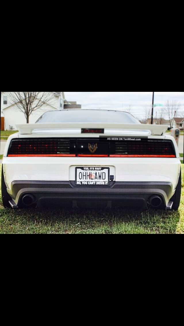

Yeah, I think it'll be cool and am strongly encouraging others to do this. I been on and off on mine and will post pics just for show/example but mine is more to fit the body stylings then just downward fins.
My only question is mounting+/gas tank?
I don't see how that is working.
I'm going to put in a strap (flat stock). Something thatll come down and across to mount the diffuser too.
But the rear exhaust....if your not running dumps. I like to see if how others incorporated the tailpipes in.
Other then wider space.

It basically channels air that would normally travel under and around the car, filling pockets and creating drag such as wheel wells and rear of chassis.
The diffuser simply diffuses the air and changes the flow under the car to allow the car to have less drag at high speeds.
Put your hand out the window at 60+ and you'll feel drag, shape your hand and you'll feels less.
Some cars use the same idea up front to channel air into intakes, inter coolers or breaks for cooling.
Simple yet effective.
You'll see it used heavy on time attack, NASCAR or top speedsters to help areo.

The only way a diffuser will work correctly and efficiently would be to relocate the muffler from the stock location to the rear of the car - which would mean cutting the storage well out, fabricating a new floor and putting the muffler right up in that space.
Then you can put aerodynamic pieces on the axles tubes, still have articulation, and have the muffler out of the air stream. It would also allow for a larger diffuser (height), which would help 2x as much as a cobbled one with stock location muffler.

I could make lots of comments here, but lets start with if you've already built it and tested it, then why do you need to find a body to build it and test it?
all that needs to be done is to get the air out from under the car. you could use a small network of square tubes placed in strategic places to do the job. of course, you would have to trumpet them at the exit to aid expansion/velocity. This picture shows the F1 double diffuser but the concept is the same.
..oi.. i wish i had the money to try all this.. id be up to my knees in CF.
and.. of course as ive said earlier.. you could in theory.. fairly easily build a poor mans blown diffuser,

If the design of the rear diffuser was designed right You would move your single muffler put a Y pipe there and run two straight mufflers where the tail pipes are.
Kind of like in the pic here, And one like this would look cool on your cars. And a properly designed rear diffuser will reduce drag and that will help with performance
and increase fuel mileage, mostly high way mileage but not by much.
Attachment 282857
Attachment 282857
