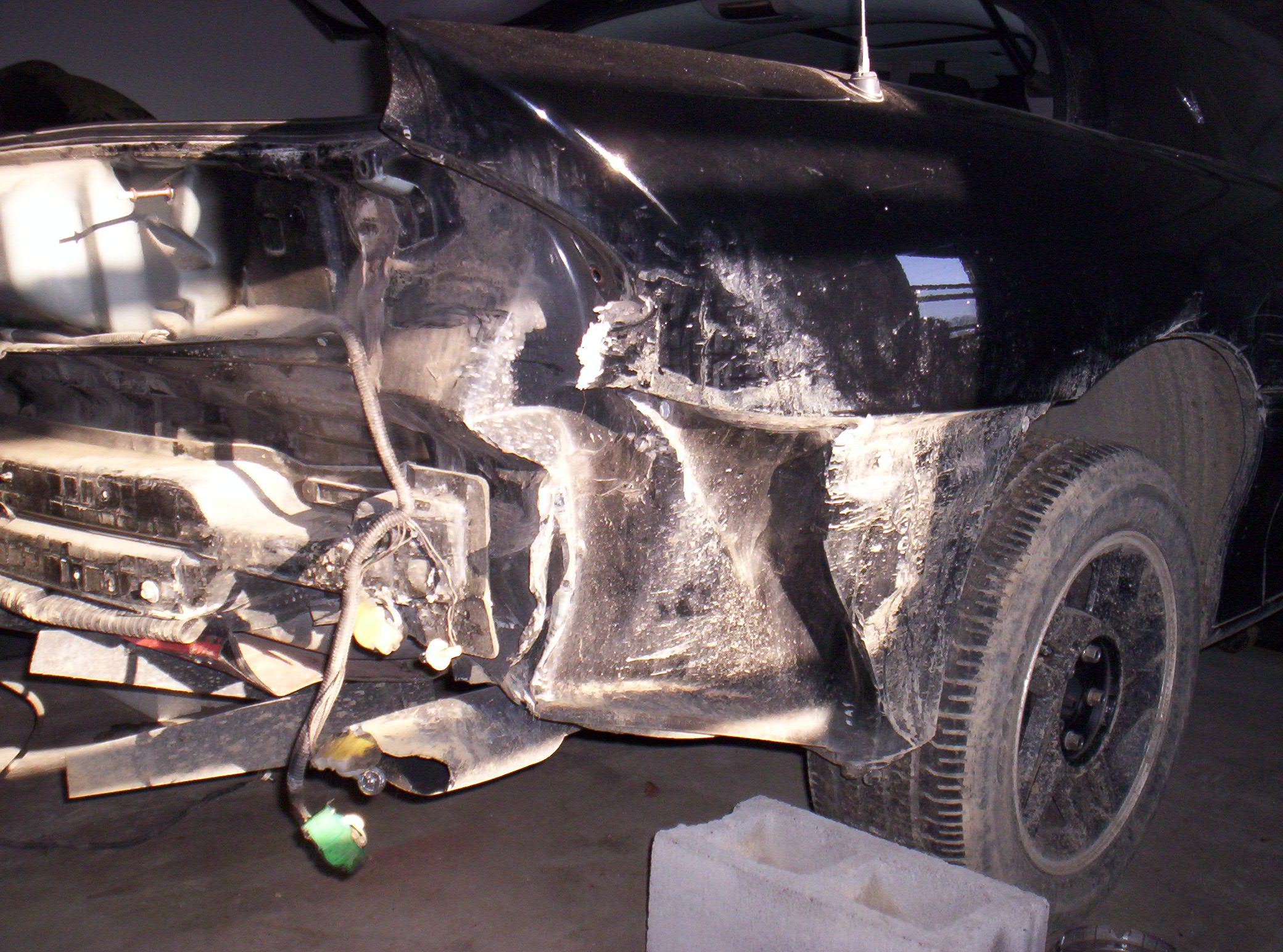

Here is the only pic I have. You can see some little fins between the exhaust pipes. Wreck was caused by a bent tie rod, not the diffuser, my mods. I'd offer a better pic, but this is all I have. So there. Pic. It happened. Blah. Leave it to you guys to take something and turn it into something bad.

Oh, and one more thing, if the car hadn't been slowed down by side to side drag, it would have killed me. So there, drag is a good thing if done correctly.
