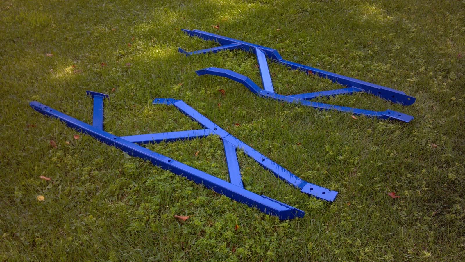

I bought another 3rdgen, so I built another set of sub-frame connectors. These are much less elaborate then the ones I built previously and where most noted on the boards. I however plan to do a full write up in the near future, illustrating the build process, dimensions, materials, cost, time and will also include tips. I feel that there are a lot of do it yourselfers in the thirdgen community and by posting a sorta "tutorial" i hope to inspire others.

Yes, This is it for this set, the car they went on is just stock nothing special.
Yes, I seen HUGE improvement in my full frame set I built Vs this set.
Originally Posted by Base91
Why did you simplify them? Ease of construction? Time? Or no added benefit from the more complex construction? What size/gauge are the tubes? If you have a pic of the first set could you post for a side by side comparison? Nice welding too.
The car is stock, I just wanted to keep them simple and basic and add some rigidity to the structure. This set doesn't even come close to stiffness or the improvements as the full frame set.
I used 2" x 2" 12ga square steel tubing.

do both use 2x2 12ga box stock? How heavy are they?
Yes.

Very nice work......I was wondering why you didn't connect the brace to the rear lower control arm , like the UMI frame connectors, that would link the front sub to the rear ?..

They are. They are welded to the part where the lower control arms bolt up to. You don't need to bolt them in place, in fact that type of bolt in bracket will allow the length of the sub frame to flex off that bracket if its not welded in. It is more or less just for ease of installation, bolt it in swing it up weld them in place, adds slightly more rigidity to where the lower control arm bolts up to. Since I'm on the topic of flex, every aftermarket (outer) sub-frame should incorporate the side rocker pinch. I have tested this out several times on several different cars going to point A to point B (front to rear sub) is not enough regardless of maternal thickness, size or shape. The length of the tube is still able to flex from point A to B. To minimize the flex and to maximize the effectiveness of the sub frame connecters you need to incorporate the side rocker pinch by welding it on to the side of the sub frame connectors tubes. It doesnt have to be welded down the entire pinch just around a 3" weld every 6" (roughly 5 to 6, 3" welds down the entire rocker pinch) depending on brand etc you might have to put peaces of metal in between the rocker pinch and sub frame connecters if the pinch is to far away. You can seriously see this for your self if you are currently running after market sub frames connecters with out the pinch welded, jack one corner of the car up watch it flex see the sub frame connectors twist.

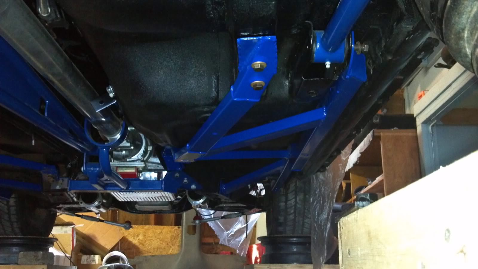

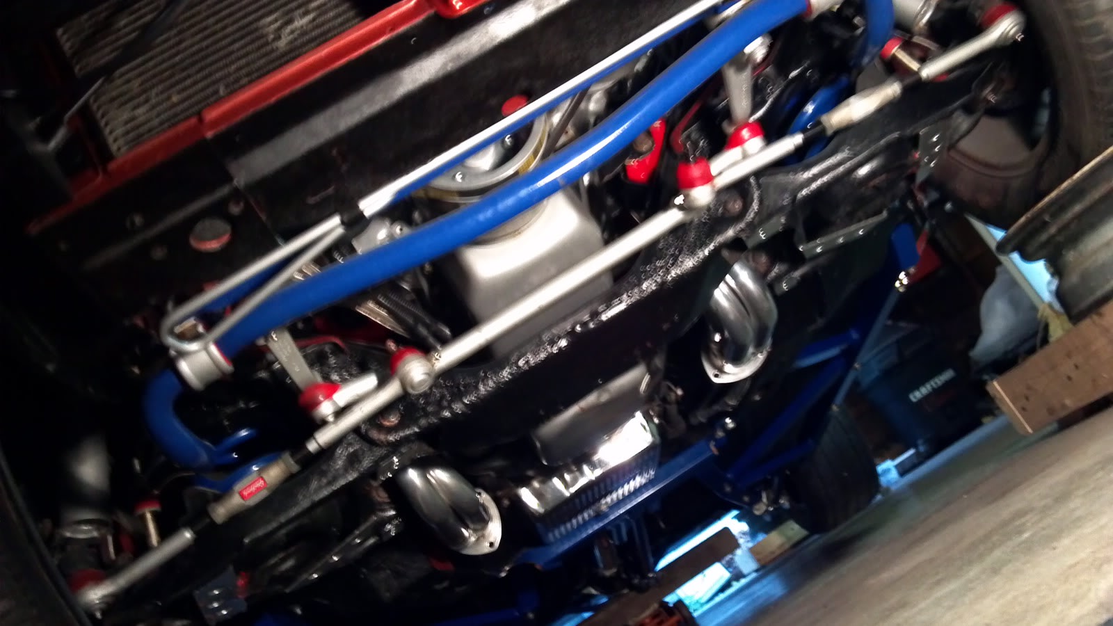

Here are my blue ones:
