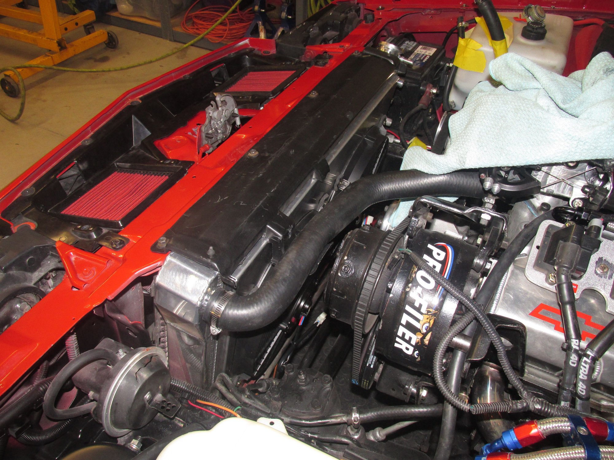

So I finally got to drive the Camaro with the new "ram air".. Key on and in this part of the country I show 91 kPa.. Went and drove it with the computer hooked up. Put my foot in it and it shows 90 kPa. MISSION ACCOMPLISHED.

I got the 2 row, 1" wide radiator in. Had to do some trimming, but fits perfectly.

Getting some miles on this now. I say it's working! I'm at 5000 DA, it was a 92º day last Saturday. Notice the kPa and what it achieved. Notice what it did to my VE table.
