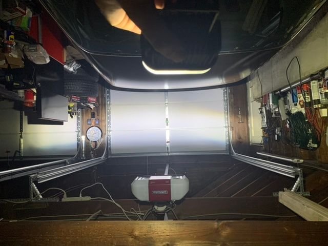

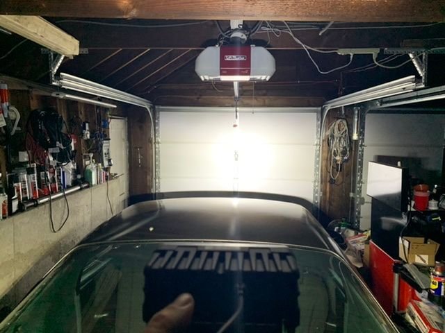

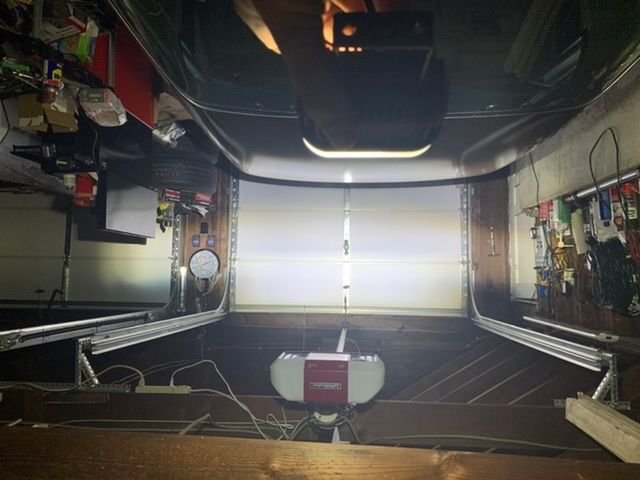

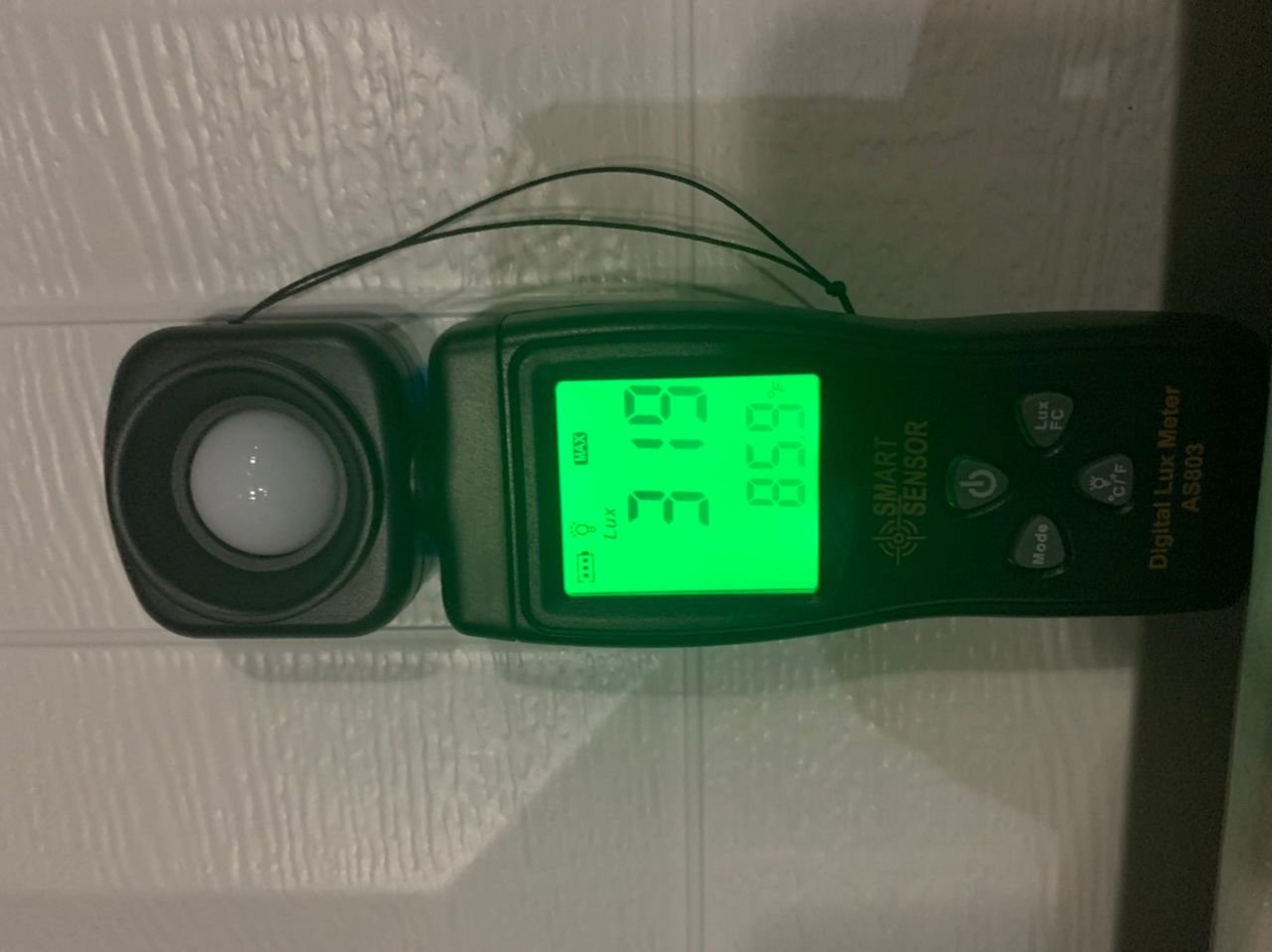

either way I wanted to share the prototype and its fitnment as well as the beam pattern. I have a LUx meter and I tested the upgraded factory fogs with LED bulbs as well as the new SAE fogs. The SAE fogs are rated at 13w and 1700 lumens and 1.02amps. My testing showed It was pretty darn close. None of the amazon Chinese stuff ever is close and usually outputs way less than rated.
Stock housing type with Led bulb lux at 17ft
New SAE fog pattern
New SAE fog lux 2x brighter than the upgraded stock housinf

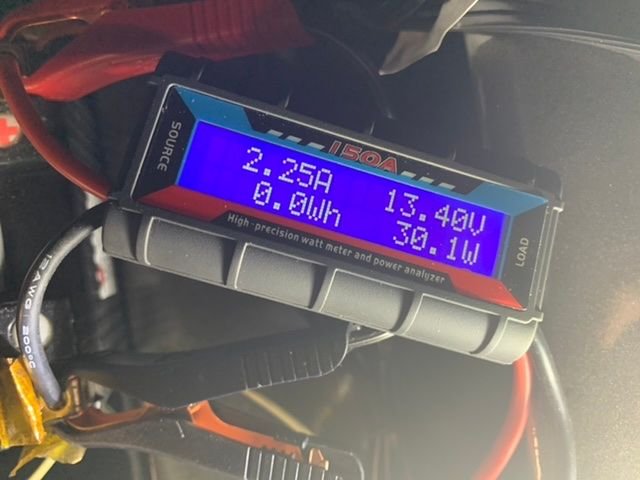

Pulling 1.13amps and 14.7watts pretty close to their rated specs

These are shots mounted in the car between the stock type fog (driver side) and the new SAE fog I the pass side. The stock fog is not as bright in the pic so I got lux ratings to prove it. The lights are about 3-4ft from the door so the lux is very high but the SAE fogs are still 2x brighter and have that long pencil beam pattern.
SAE fog 5933 lux
Stock type fog 2257lux

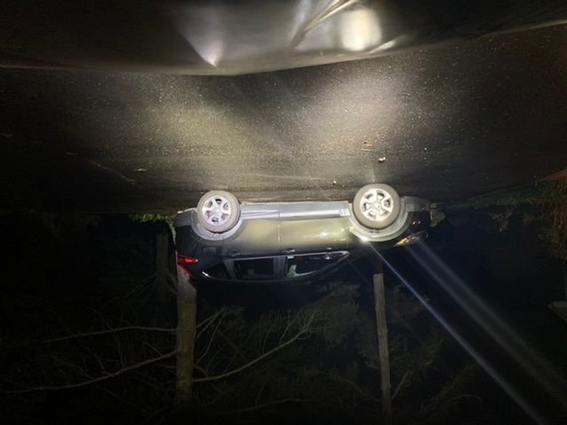

Finished them up tonight and installed. Took it out to aim it and it helps for sure. They add width which the JWs seriously lack.
Driver side, picked up wider steel and both are fully welded and painted
JWs on top and fogs on the bottom

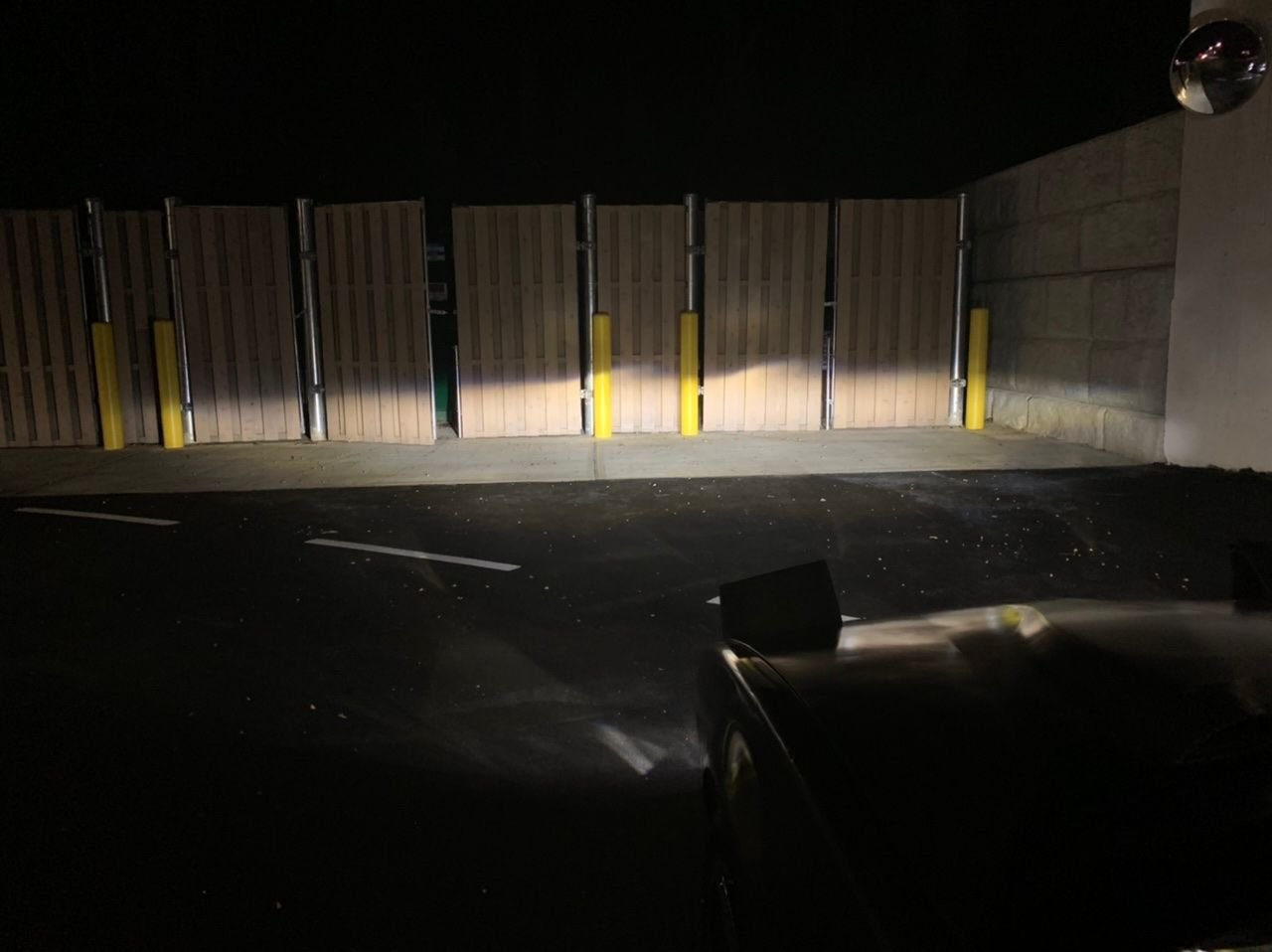

Just fogs, wall is prob 30-35ft away
JW and fogs
Photo shows more glare than there really is.

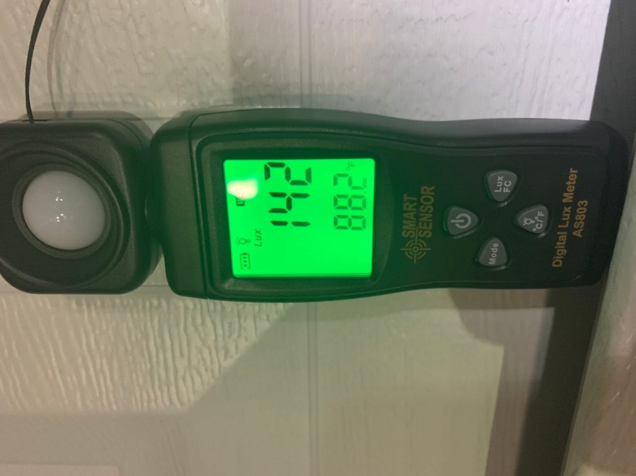

Re: New SAE fog light LED POD retrofit

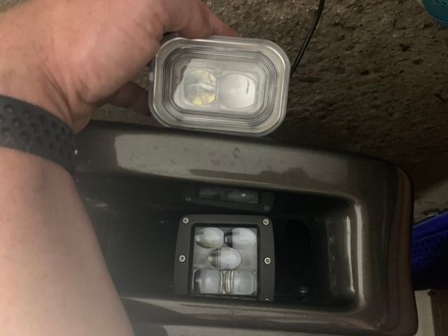

Decided to revisit this project and see if I cant improve on what I have. I decided to look and see if I could find another cheap light to fit in the space better but offer decent non blinding beam output and respectable Lux readings. I did some searched and while I found some expensive options and no real mounting ability I decided on a cheaper Amazon China LED mini headlight for a bike or motorcycle.
This little guys is roughly 2.5x4 and less deep than the 3 cube I have. My current SAE fogs are 3.25 wide and 3.125 tall and 3.25 deep. The opening in the TA bumper is 2.5x5.5 so while the new lights are a tad short in length they fit the height better and will look better in the hole I think. Best part about these new lights is they are a low beam and high beam so I can get some added distance if u need it if I wire it into the high beam or on another switch.
now to the specifics in comparison to the original photos at the top of these thread beam isnt as tight which I expected but not horrible like some of the LED headlights Ive tested. Beam is slightly less wide than the SAE but it puts out more lux at the same distance on low and on high its like double the SAE. Not that the JW speakers need help on the highs bc they dont (thats there best feature) but the lows are underwhelming when your used to HIDs and decent projectors. Good news on the new lights is they look to have mounting holes on the sides so I could easily bend some ABS and mount it to the light to fill the gap around the light in the OEM fog opening. I couldnt figure out a clean way to do it with the SAE fogs and just let it be until now.
I will be working on the retrofit and swapping these out and will snap some output pics eventually.

Im done with my 3rd iteration of these fogs!
Took a long trip at night over a month ago and the V2 fogs were ok Im still not getting the distance that I want with the JW speaker headlights without having the highs on all the time. The fogs werent giving me a noticeable distance improvement but I was def getting some additional light scatter which I could see in signs above cutoff.

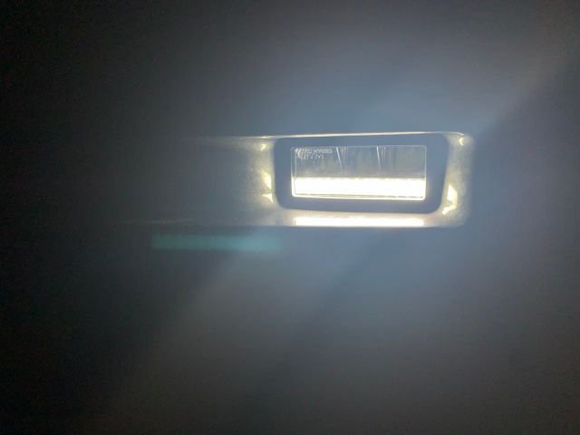

looked and looked for something to fit the bumper opening and found something! Silvania 6 and 2 LED pod with DRL. Its a 5.5 x 2.5 LED pod which is the same opening as the bumper so finally I will fill the whole space like stock and it looks like a reflector housing which resembles stock. However thats where the similarities end and its a beast little pod. 30w with a 10 degree spot pattern and uses real Osram chips and the DRL is SAE rated. Mounting was pretty straight forward and swapped them onto my brackets Ive been using this whole time. Wiring is similar but tied into the side markers for power with the running lights on for the DRLs. When the pods main beam is activated the DRLs turn off and back on when the main beam is off or if the running lights arent on the main beam turns on and off by itself. The pod is a tight fit and has very little if any adjustability but its not necessary as a 10* beam has no cutout and will give me lots of light down far away.
the pods are very nice and quality is wayyyy up there even as nice as my rigids in my truck. Only thing I did was flip the bracket and the front lense perimeter plate so the silvania logo is right way up. Otherwise the pod is actually upside down but that doesnt affect the beam pattern and it puts the DRL down lower which is better.
no road shots as I havent taken the car out at night yet but LUX and testing looks positive.

4x more lux than the previous V2 led pods which only mustered 500 lux at the same distance.
Nice 10* spot pattern
Left us V2 pods 30w low and high beam, middle are the Silvania Im using in V3 and on the right are cheapo Amazon specials I got to test and see how they would fit. Performance was dismal on the Amazon but the beam was wider and more flat than the Silvania.
