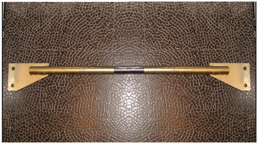

With inspiration from the Kenny Brown Lower Chassis Brace that was offered 20 years ago I've fabricated my own.
The inspiration, not sure why the opposing mounts but.....
A quick modification to the pitcure because I prefer symmetry

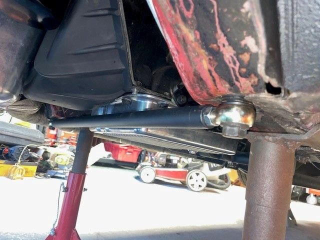

Version 1.0 I used solid rod ends with a threaded backing plate on the inside of the frame

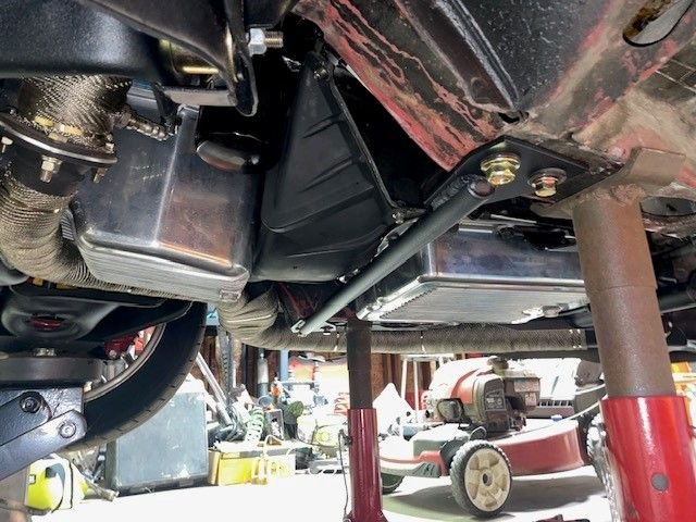

Version 2.0 I used welded plates in place of the solid rod ends.

what do the bolts attach to inside the frame area? did you put a plate inside with nuts or something?
Old Aug 14, 2023 | 01:12 PM
91banditt2's Avatar
Joined: Dec 2000
Posts: 2,341
Likes: 151
From: Cincinnati,Ohio
Car: 1991 BandittII Firebird
Engine: 5.7 HSR
Axle/Gears: 3.27 9 bolt
Re: Lower Chassis Brace
there’s a 1/2” thick threaded backing plate inside the frame
