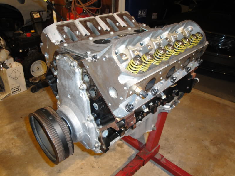

Heads are on the motor at last! I decided to go with GM MLS gaskets over cometic since I've heard from a bunch of guys on LS1tech that they will hold plenty of boost and horsepower. They were also half the price!
Something about a block with ARP head studs just looks awesome!
Almost all back together
