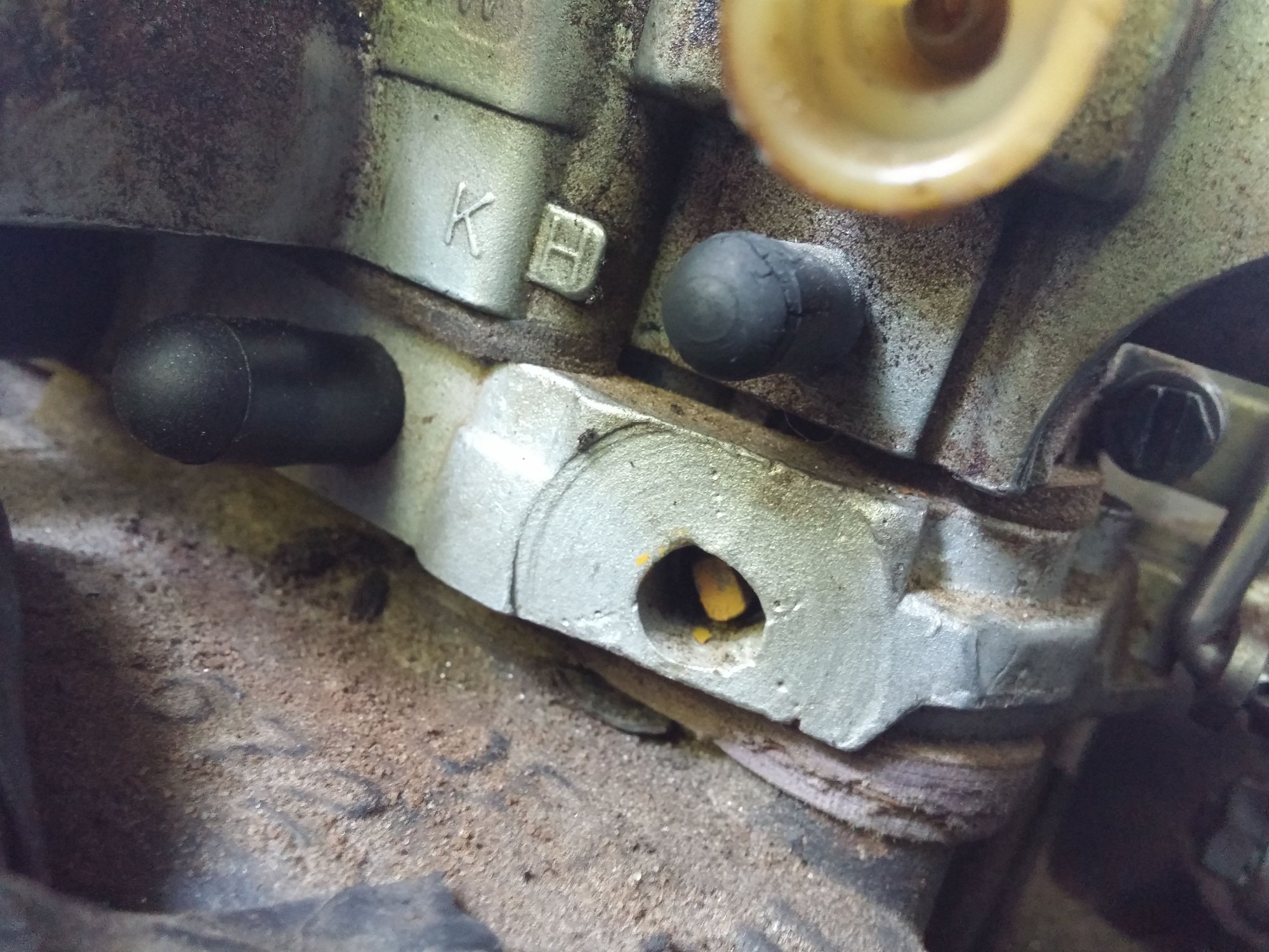

First of all, this looks awesome! Great find.
From looking at your pictures, it looks like the PO may have done an EGR delete and left some of the vacuum lines uncapped. I don't know much about the carbed cars but a vacuum leak is definitely going to cause problems regardless of the type of intake. This thread is a great resource: https://www.thirdgen.org/forums/tech...iagrams-i.html You might be able to cap off the vacuum lines, or you might have to do some custom routing.
Maybe some of the carb guys can tell you more based on that video.

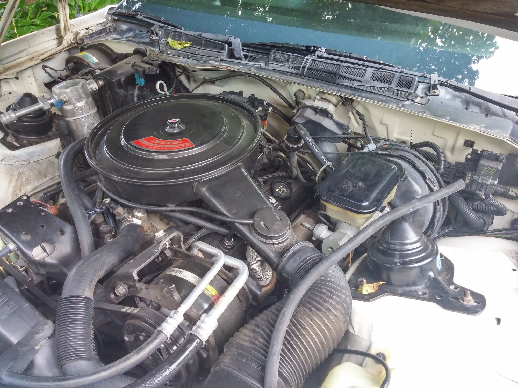

From your photos, I can see there are a few things missing under the hood. You had mentioned that there was no catalytic converter when you were under the car. Well, you are also missing the A.I.R. (Air Injection Reaction) system and all its associated plumbing. That's really no big deal. Many on this board talk about doing away with it to try and gain some horsepower. You are also missing the E.F.E. (Early Fuel Evaporation) system due to the plug in the top of the thermostat housing. The reason you may be having problems with your fuel tank is the E.E.C.S. (Evaporative Emission Control System) is not complete. There is a CCV (Cannister Control Valve) missing. It usually sits right next to the thermostat housing. When you get your factory service manual, you will be able to read about these systems. In the meantime, you can do a search on the forum. The stalling you are having could be directly related to this.
By the way, very clean looking car. The interior and paint look great! I wish mine looked that nice when I bought it.

I just did a quick search and the Cannsister Purge Valve can be found at Rock Auto. They have two manufacturers, with one priced at $12.99 and the other at $32.99. So they are still available.

Another thing I noticed from your photos is that the carburetor appears to have been rebuilt. I say that because of the surface finish being silver, which indicates it was cleaned and the factory finish is gone. Also, it looks like all the screws have been replaced as they all have a shiny, clean look to them. Perhaps the PO had it recently done and that isn't your problem at all.

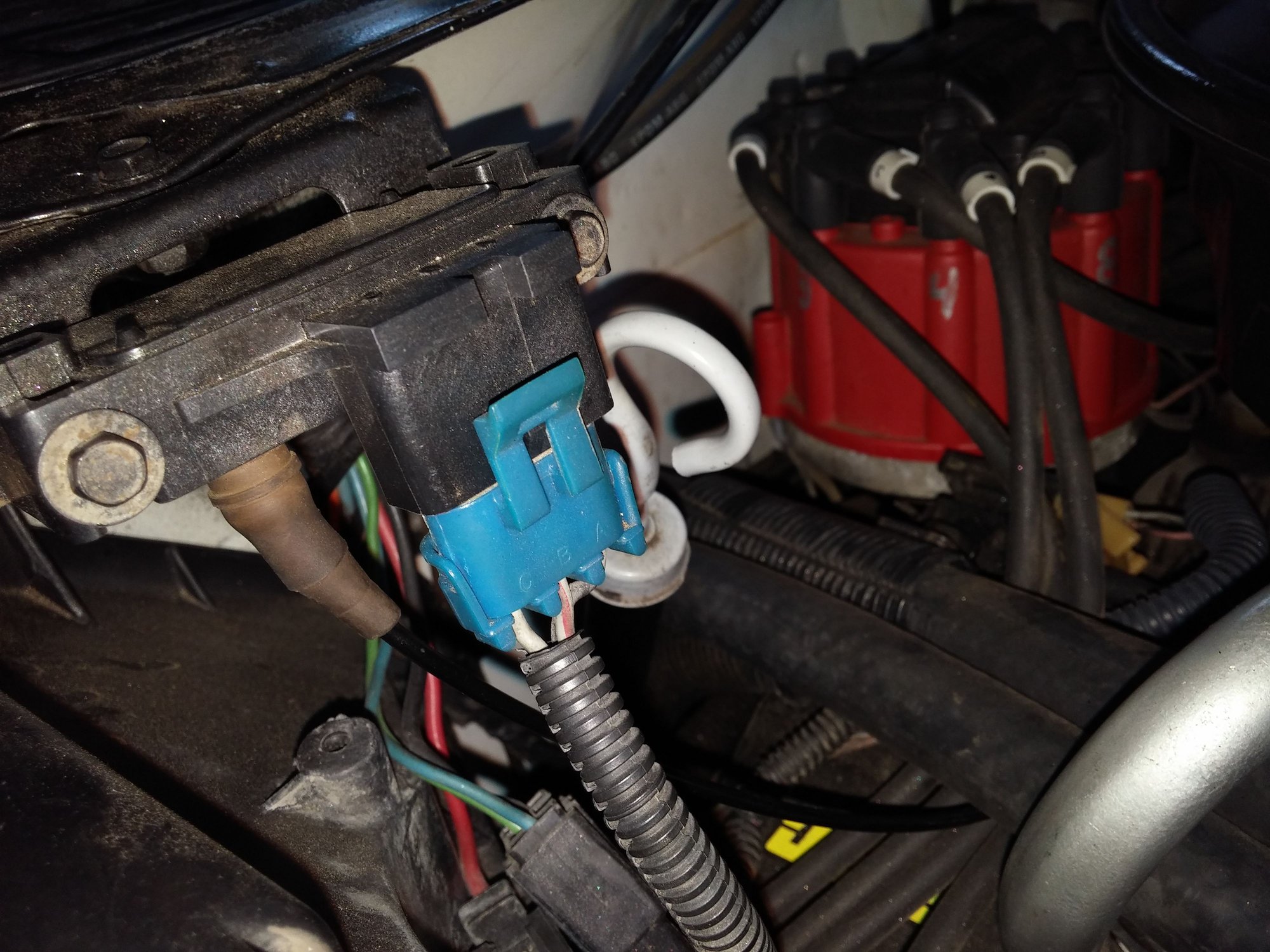

Alright so I figured out where that little line coming from the back of the carb was supposed to go:
I missed it at first because according to my vac diagram it was supposed to be going to the drivers side sensor thing, which was ready occupied by another line going to a different place in the carb. I stuck it back in and I could immediately tell my idle was much better than before. I'll drive around a while tomorrow in the heat and see if I'm still getting the acceleration stumbling.
I also noticed a strange noise coming from the drivers side of the engine:
Any clues what this could be??

nope. that vac line does not plug into the baro sensor on the right. although it looks identical to the vac sensor, it provides a reference signal for atmospheric pressure to the ecm. The vac sensor should connect to the right/rear port on the carb through a hard plactic tube within the ECM wiring harness.

So I think most of my remaining engine issues are due to the chopshop job it had of removing the emissions systems. I want to at least get my charcoal canister side of things hooked up properly again, since I've read its a separate system from the smog pump/cat. Is there a comprehensive guide anywhere to properly fixing the charcoal canister system back up without the AIR system in place? If I knew all the proper parts I need and what lines need to go where I'm sure I could fix it up myself, and maybe even fix my check engine light from coming on.

Originally Posted by turboguard
Alright so I finally took some pics of my car:
And the engine:
love it!

So I think I just fixed my engine problems. After doing some more research and looking at carb a little more carefully I discovered my vac sensor hose wasn't even going anywhere and the hose from my carb was going into the baro sensor. So I got that mix up fixed, and then I noticed one of the vac holes on the front of my carb wasn't even plugged! I'm shocked it was running as well as it was with such a huge leak. I also noticed this weird hole:
Any clue whats going on here?? I plugged it up just to be safe but it looks like something used to be there.
Pumping gas is still an issue unfortunately...I'm pretty sure it has to do with getting that new tank installed.

Your stalling problem with the A/C could be due to the "kicker" solenoid not working, or perhaps not there at all. It is supposed to kick the idle rpm up a bit with the A/C on. Your normal idle rpm should be about 600-700. The coolant temp gauge should be just past the first mark, which would be around 190-200F. If it gets into the middle, that is too hot. Your oil pressure is about 45psi or three quarter on the gauge while cruising. Once the oil has warmed up, it will drop a bit. At idle, it can be anywhere between 15-25psi, or as you mentioned, about one quarter on the gauge.
You are getting to know your car and learning the quirks.

Looking over the photos you posted of your carburetor, I see that the "kicker" solenoid is missing. As you can see in the photo of my carb, it is in the middle right of the picture. It pushes on the throttle to slightly raise the idle with A/C. This is due to the added load of the compressor.
Attached Thumbnails Looking to buy my first bird, need some advice-microtube-routing-left-side.jpg
Man your carb looks so clean compared to mine
Would replacing the solenoid be as easy as buying the part and plugging it in?

In regards to the solenoid you need, I am not sure they are easily available anymore. It's a fairly simple part which was probably used across many models of GM cars and trucks. As you can see in the photo, there is a spade connector on the solenoid. You should at least be able to find that laying in that area.
Yep...found the connector...at least now I know what it used to go to, lol. Any clue what the part number would be or what the "official" name of it is so I could try finding it online?

I found what you are looking for and it comes with the bracket and mounting hardware. The downside; "it aint cheap!". Rock Auto shows two offerings in the $60 range. And believe me, they are the most affordable parts house I've found. Your other choice is Fleabay, but in my opinion, that's a crap shoot with electrical parts.
It is called an Idle Stop Solenoid, and will be found under the "fuel and air" heading.
Attached Thumbnails Looking to buy my first bird, need some advice-idle-stop-solenoid.jpg
Thank you so much! Saved me a lot of time! I have no clue why it would have been removed and not replaced with the AC still in good condition. Oh well, these extra expenses are always expected when it comes to these old cars, and I definitely need my AC down here!
