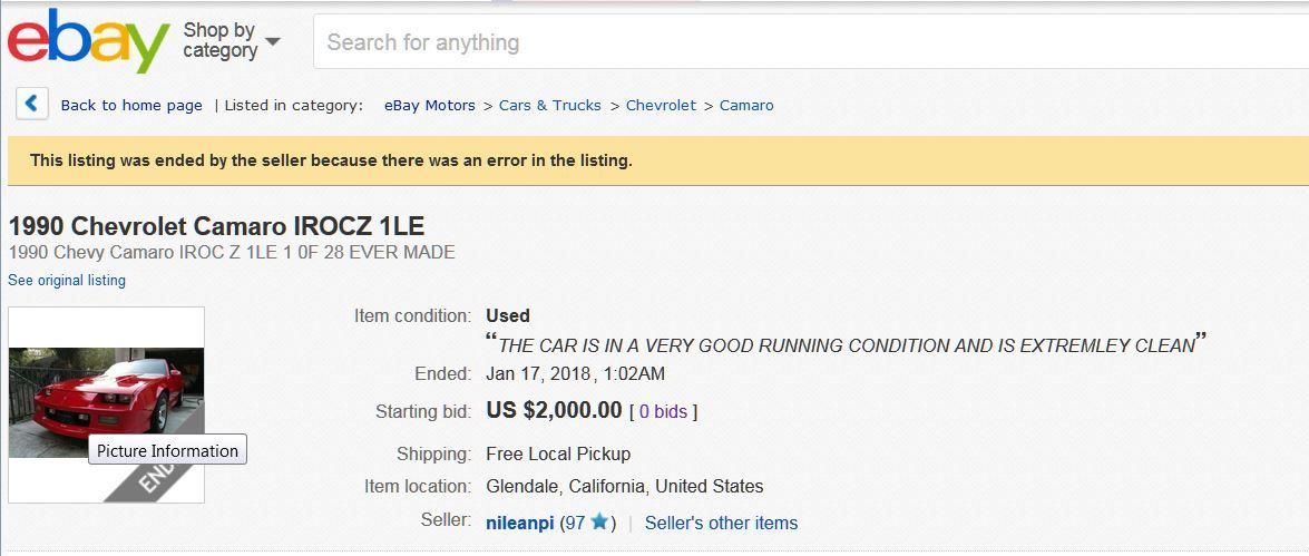

Was just bouncing around on Ebay this lunch hour and found the following listing. What's up with this?
https://www.ebay.com/itm/282811564154

Seller messaged me and told me he retracted my bid and will not allow me to bid on the car nor purchase it for any amount to prove to me that he isnt a scammer. I chuckled a little inside

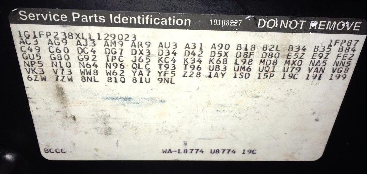

Outright fraud, fabrication, bull**** and private shill bidding. This one flips all the switches!
1G1FP238XLL129023
RPO list.
1G1FP238XLL129023
RPO list.
Where/how did you plug in that vin to generate the list? thanks
Compnine
...and this just in...

Car is a nice IROC 350, nothing more.
UB3 CLUSTER,INSTRUMENT(OIL,COOLANT TEMPERATURE,VOLTMETER,TACHOMETER,TRIP ODOMETER)(USED WITH DELUXE SPORT PKG W32) GA(UB3) 32,963
UM6 RADIO,AM/FM STEREO,CASSETTE,ETR,INCLUDES CLOCK STEREO CASSETTE(UM6) 29,468
UQ1 RADIO,PROVISIONS FOR STEREO STEREO RDO PR0VISIONS(UQ1) 32,748
U79 SPEAKER SYSTEM,4,DUAL FRONT COAX,DUAL EXTENDED RANGE PACKAGE SHELF 4 SPKR SYS(U79) 31,754
VAN Unknown 32,963
VG8 Unknown 5,651
VK3 LICENSE PLATE,FRONT MOUNTING PACKAGE FRT LIC PLT MTG PKG(VK3) 30,015
V73 VEHICLE STATEMENT - US/CANADA US/CANADA VEHICLE STATEMENT(V73) 31,763
WW8 AERO PACKAGE(BRIGHT RED)(USED WITH AERO PACKAGE W62) AERO PKG(WW8) 7,455
W62 AERO PACKAGE AERO PKG(W62) 32,963
