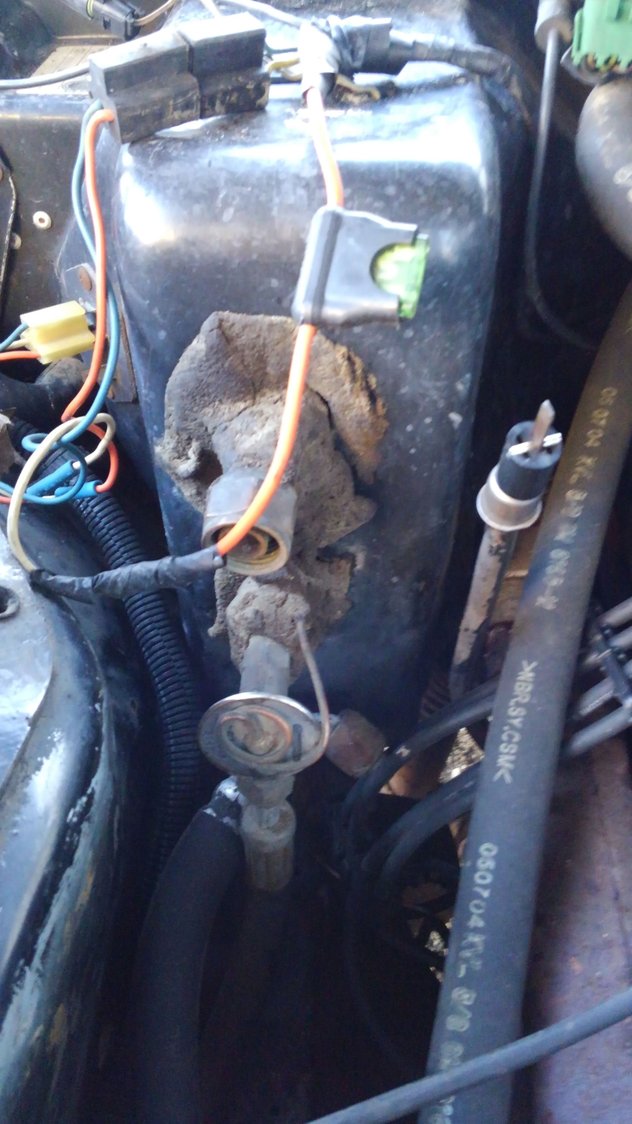

So close to exhaust manifold it melted a hole in it.

Only 39 codes. Aar,c41,d15,d60,d81,d88,e5z, e7z,e9z,gu2,j50,k99,l03,md8,mxo,na5,nk3,n90, p84,qxz,um7,uqi,u79,van,v73,ww2,w62,1ay,1sa, 16p,41u,6xu,7xu,8ux,9xu,86a,827,82b.829. best I could tell,thats what they looked like. One of the previous owner tried to fix the fan switch or something. Drilled holes in the firewall and didn't seal the hole. spliced in about 20 wires and Nd connectors
