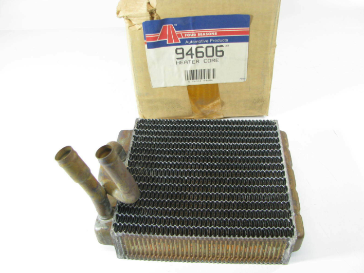

Says "exact fit". Should I believe?
https://www.summitracing.com/parts/sgt-94606/

Its worth a shot. I wish I'd stocked up on parts store brass replacements that fit perfectly back before Obama's EPA forced everyone to switch to the aluminum garbage. The $15 replacements everyone used to sell were great. Sometimes you can find old stock being liquidated.

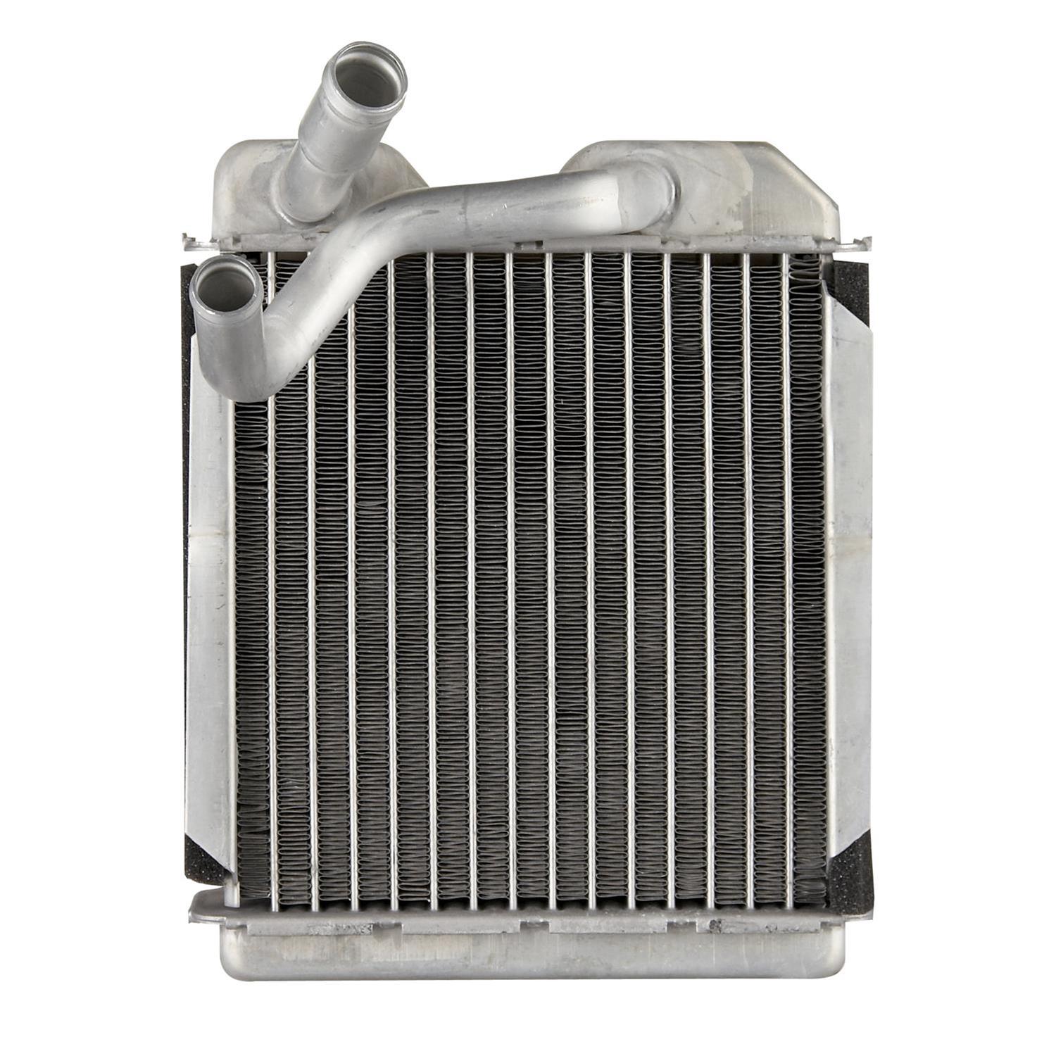

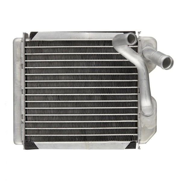

The Spectra Has The Recess In The Core Like The Factory Did To Accept The Clamp (38) To Attach It To The Shroud (40) The Other Cores Don't Seem To Have The Recess, They Would Only Be Held On With The Strap (41)

I bought the Spectra, it didn't fit very well, and the reason I will go back to re-cored factory units.

I ordered and rejected this one. No notch on the tank for the clip and the pipes swivel, which I understand is s common source of leaks. Search continues.May just go with Spectra, since no one around here recores old ones.

I was recommended a place near me by another 3rd genner, to repair the factory core. He had his done there after a couple failed aftermarket attempts and is very happy. I'm gonna check it out.
This may turn into another "why can't we get good reproduction TPI emblems" thread......

Here's a pic of his core.

Nice Job

Just scored this one!
Haven't seen one of these in awhile.
