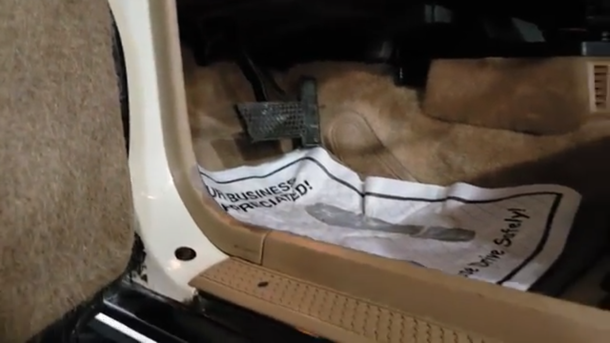

I was just watching a video on YouTube of a low mileage 1984 Berlinetta. (People seem to be fascinated with third gen berlinettas now because if the digital dash) anyway,the seller opened the doors and I noticed these black plugs covering holes in the body at the front and rear lower areas above the rockers. What the hell are those for? I’ve had many trans ams and have a 90 camaro and it doesn’t have any holes like that. What’s the story behind this?

In the door jams? Ziebarting/rust proofing?

I am talking about the round black holes in the white painted area in the door jamb. That isn’t “ziebarting” not unless they drill holes into the door jamb and put undercoating inside the car and then push plastic plugs into the body.

yep ,look like rust proofing plugs to me. If this car had been on the road it probably would have rusted clear away by now. They always seemed to rot before the ones that weren't "proofed"
Granted, somebody may know more on the subject than me.

Interesting. I live in California so people don’t undercoat cars out here much. I had a feeling that wasn’t done by GM because I have never seen those holes on any third gen I’ve ever owned and I’ve had a bunch of them.
I always assumed undercoating was just that UNDER coating. Why would they bore holes into the body and put it inside? The road salt is going to get on the outside of the car.

not a thirdgen and this one has yellow plugs but...

Wow! Thanks for the info. I learned something new today.
I never realized how “spoiled” we are to live where this isn’t done. That would bother me having holes bored into the body like that. I always assumed undercoating was what the word implied, coating applied underneath the car. I had no idea that they actually put holes in the body and filled it full of undercoating on the inside

Quote: Wow! Thanks for the info. I never realized how “spoiled” we are to live where this isn’t done. That would bother me having holes bored into the body like that. I always assumed undercoating was what the word implied, coating applied underneath the car. I had no idea that they actually put holes in the body and filled it full of undercoating on the inside
They don’t drill holes and fill it with undercoating. They use a waxy rustproofing product that is sprayed inside the enclosed panels.

Quote: They don’t drill holes and fill it with undercoating. They use a waxy rustproofing product that is sprayed inside the enclosed panels.
Correct. I used to work there back in the early 2000s and did rust proofing before graduating to window tinting/sunroofs. No, I did not install any sunroofs in a single thirdgen, so everyone pipe down.
We had cordless drills with unibits and drilled holes in specific areas of the jam, then using special guns with rods attached, sprayed the tanish colored substance inside, rotating the rod and pushing in and out (get your mind of out of the gutter). This effectively coated the inside of the rocker area. On trucks, we'd take the tailights out and run longer rods down the inside of the bedsides. We also drilled and coated the inside of the tailgates.

These holes in the door jambs are considered "structural damage" at the auctions for any newer cars. So many cars from the 80s got the Rusty Jones treatment, and these plugs are everywhere. So, you buy a brand new car and pay someone good money to cause structural damage and devalue a new car. This is how we see it today, but it's obvious it was thought of differently back then.
The door jamb is a major part of any car's structural integrity. Every hole drilled, creates a new crumple zone by weakening that area. Unfortunately, my car has them also.
