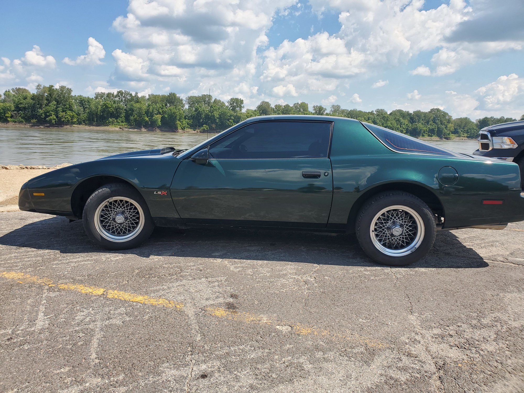

Formula without a spoiler?
I've done some research and from what I've gathered they did not make a formula without a spoiler. However, I have a very clean and complete car without one or formula decals.
My title matches my vin and I have also I have checked RPO codes and verified swaybar thickness. The car was originally 5.0l 5 speed but has been recently LS/T-56 magnum swapped. Thanks for reading let me know what you think!

I can't say if there were any made without spoilers but there shouldn't be and I'd be willing to bet yours had one at birth. In my opinion a bird without a wing doesn't fly until it gets one.

The 91/92 Formula/Trans Am/GTA cars all had the aero spoilers but there all prone to cracking and warping over time, the 91/92 spoilers were made out of heavy plastic. The repo spoilers from hawks are fiberglass and way better quality over the OEM GM ones. The original one probably cracked over time and somebody just took it off. There's a bunch of wingless 91-92 cars out there for the above reasons ive mentioned. And the car was more than likely repainted at one point they didnt bother replacing the decals.

Given your car is quite modified, and is nearly 30 years old, that is likely the reason why the car doesn't have the spoiler. But it didn't come from the factory that way.
All 1992 Formulas had the D81 rear spoiler. Since you have RPO codes, you should be able to confirm that D81 is on your list. That tells you the car had the rear spoiler.

All the modifications were done by me and the car doesn't look 30 years old. I definitely over looked the D81 thanks a lot! I definitely like the sleek look but since it was born with one I'll have to start looking.
