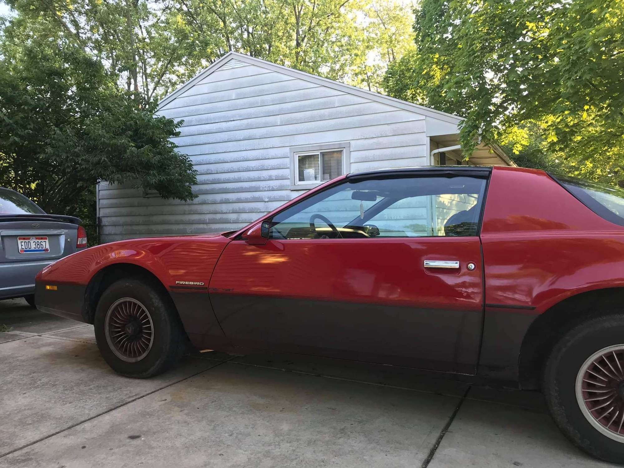

So I've got a 1984 firebird with the 305 it's automatic it's got red paint but the bottom half is a gray color and I've got red turbine wheels and leather steering wheel I've checked my vin and it just says base but some of the things it has I've read came on the s/e's
The S/E received a different VIN code from the Firebird and Trans Am. The 5th character of the VIN should be X if it were an S/E. The S character, from your example, indicates it's a base Firebird. That means that's what the car was built and came from the factory as. Keep in mind the car is nearly 40 years old and parts can be changed/swapped in that time.

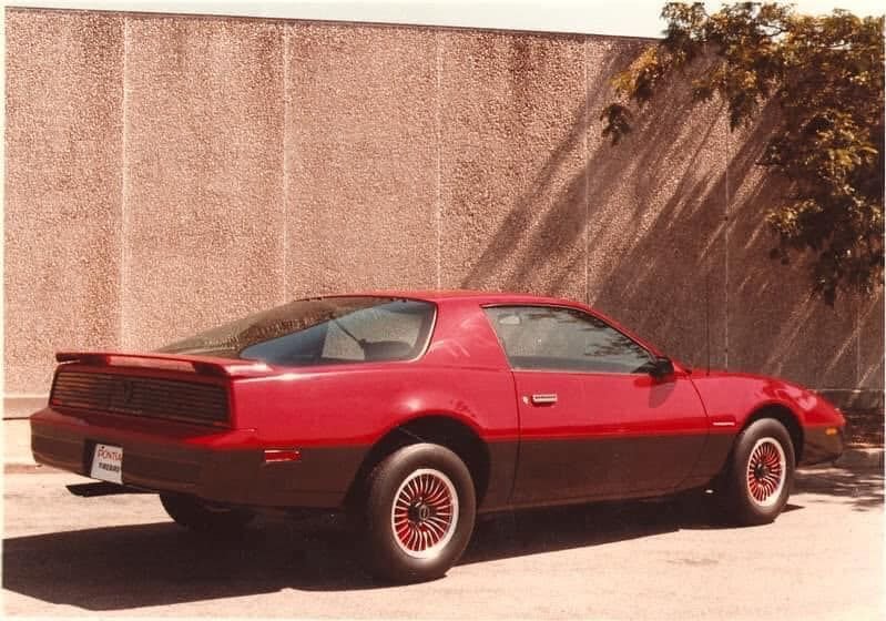

That is not a Firebird S/E.
What you have is a 1984 "Spring Marketing Package" Firebird.

@Agent13 thanks for the additional information you provided to the topic. I never heard of that promotional package and don't have that sales bulletin. Just knew the VIN didn't classify it as the S/E.
