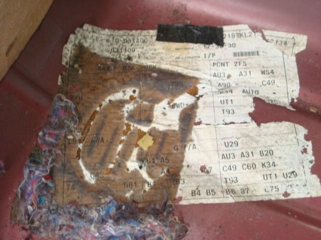

Thanks. Unfortunately the spid is gone as the console was missing when I got the car as they had started taking it apart to build a street race car out of so I had been hoping to learn more from the invoice. There is a broadcast sheet stuck to the passenger rear foot well but it looks mostly to be interior code related. It does have the vin though and in the center had a large GT/A printed .

This was stuck on the passenger rear foot well area.
