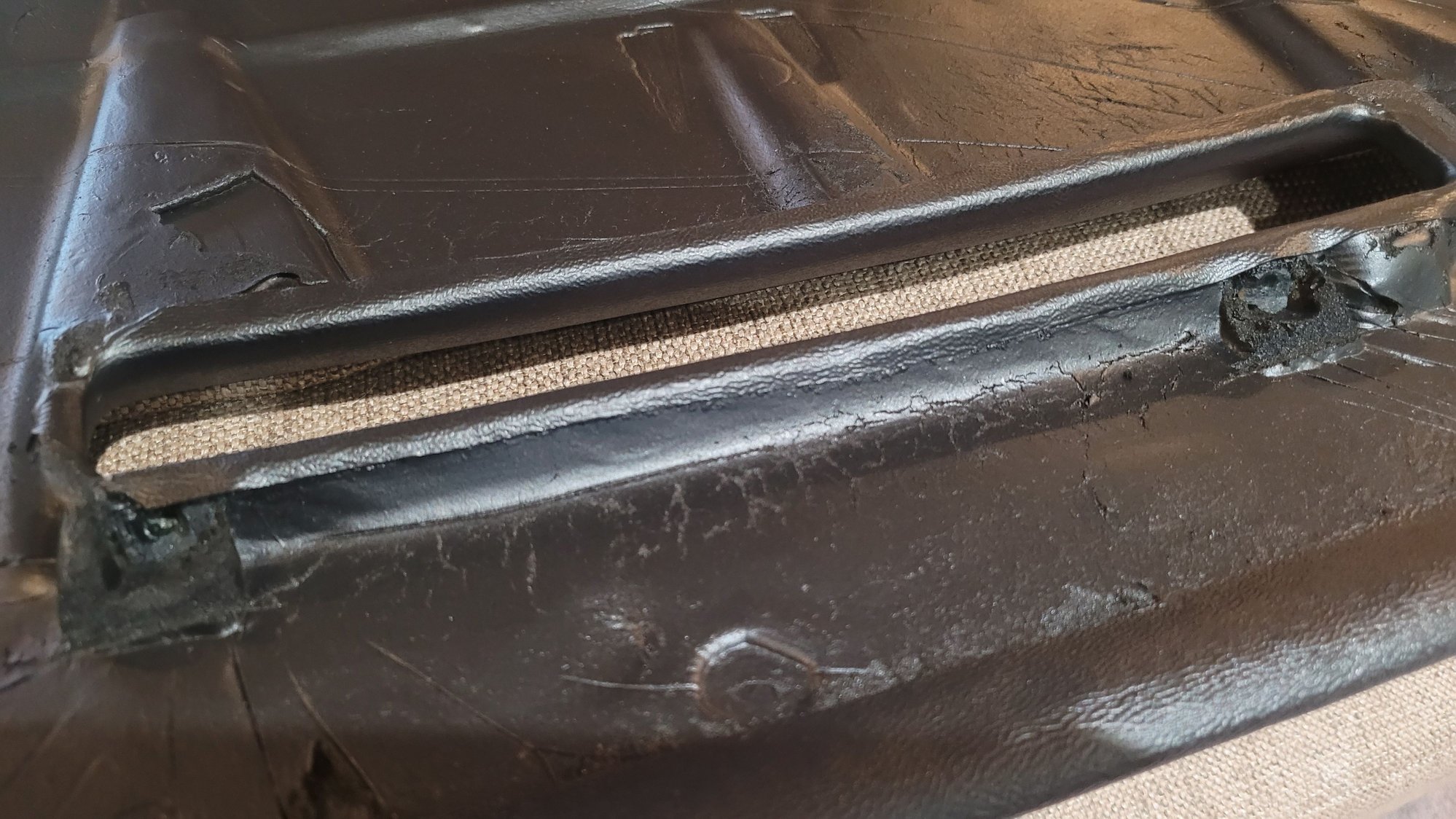

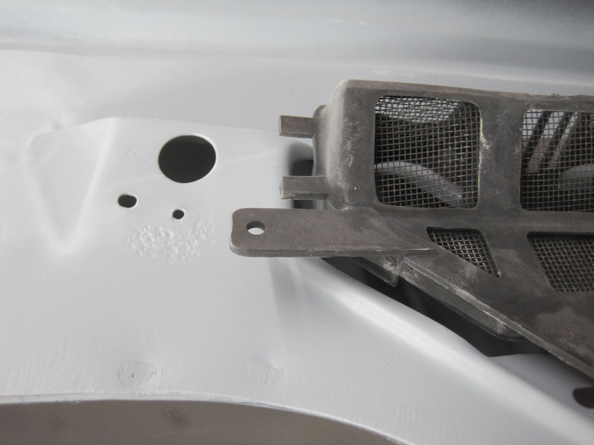

Dang, it’s been a while since I posted. I haven’t been working full-time on this lately. I’m still in the process of blocking out the panels before I shoot the final primer-surfacer.
I did start on the hood repair, which is new thing for me with it being SMC. Although most of you know what this is, you might find this detailed look interesting. Here is what I have learned about SMC, courtesy of AI and Wikipedia:
“Sheet Molding Compound (SMC) is a glass-fiber-reinforced, thermosetting plastic composite material used for compression molding high-strength, lightweight, and durable parts, especially in the automotive industry. The material consists of a resin paste, fiberglass, fillers, and other additives, which is formed into a continuous sheet that is then cut into "charges" for molding into complex shapes.
How It's Made
1. A resin paste is dispensed onto a plastic carrier film.
2. Chopped glass fibers are cut onto the resin.
3. Another carrier film is added on top, creating a "sandwich" with the fibers embedded in the resin.
4. This sheet is compacted and then matures, allowing the resin to thicken.
5. The carrier film is removed, and the sheet is cut into charges for compression molding.
The Molding Process
Compression Molding: The material charges are placed into a steel die, which is then heated under pressure to cure the composite and form the final product.
Finishing: Once cooled, the part is removed from the mold. Post-molding processes can include trimming, painting (including in-mold painting for efficiency), and other finishes to achieve desired surface quality and appearance.”
There are lots of videos showing this process in action.
So, as far as we are concerned with the repair of SMC, we can’t treat it like your typical fiberglass part. The only material that can be directly applied to SMC are epoxy products, hence my decision to apply epoxy primer to the hood first. If there is damage or deep gouges, pits, etc., an epoxy filler or adhesive should be used first to build up the material to its nominal shape, repair cracks, etc. After first blocking the bare hood, I realized that the damaged areas that were showing fiberglass fibers hadn’t deteriorated as much as I assumed. It still had its original shape and contours, so I was able to go directly with the epoxy primer then Featherfill.
However, after blocking the Featherfill, I discovered some deep pits. I could only assume those pits went into the SMC. To play it safe, I spot sanded the pits with 80 grit until I was into SMC and reached the bottom of them. I then applied the epoxy filler, (Polyvance #2020-T), into the sanded areas and sanded them level with the Featherfill.
During the initial blocking of the Featherfill I stopped blocking when I reached the SMC substrate. I applied epoxy primer to those areas first before shooting additional primers. I sanded those areas down a little so there will be less tendency to uncover bare SMC again.
Some of the low spots were deep enough to warrant using a skim coat of body filler. They were still within the depth of the Featherfill, so a traditional polyester filler worked here. The rest of the low spots were very shallow, (within the depth of the orange peel), so I just shot those with more Featherfill and then completely covered the hood with two more coats. The hardest areas to work were the edges around the scoops. Pretty much the entire perimeters were pitted and deteriorated. I had to be careful to get them rounded correctly.
It's now ready for primer-surfacer.

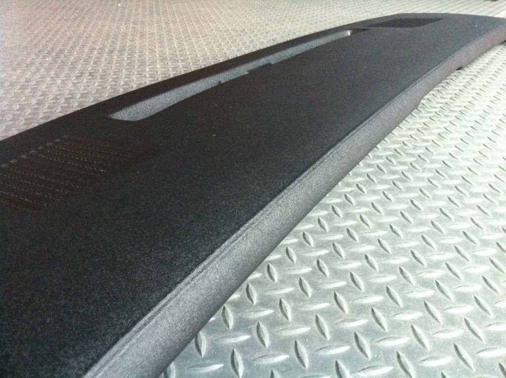

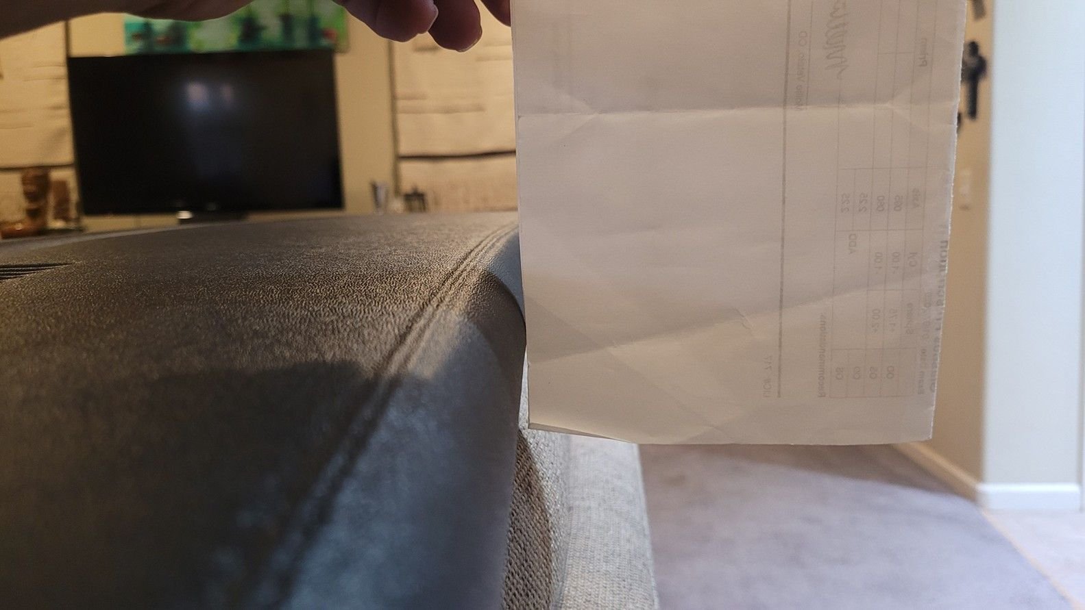

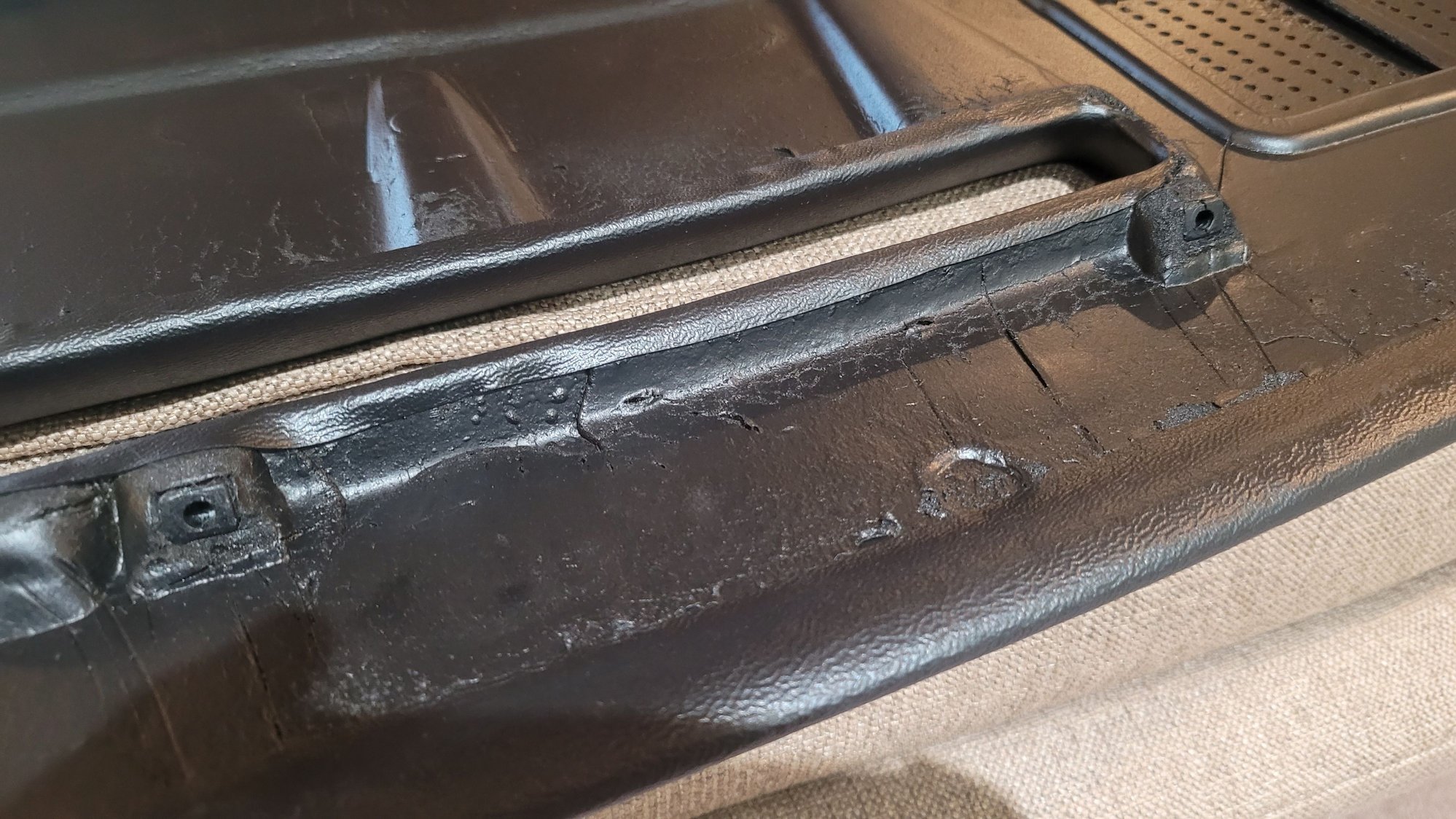

I just received the rebuilt dash pad from “Just Dashes”.

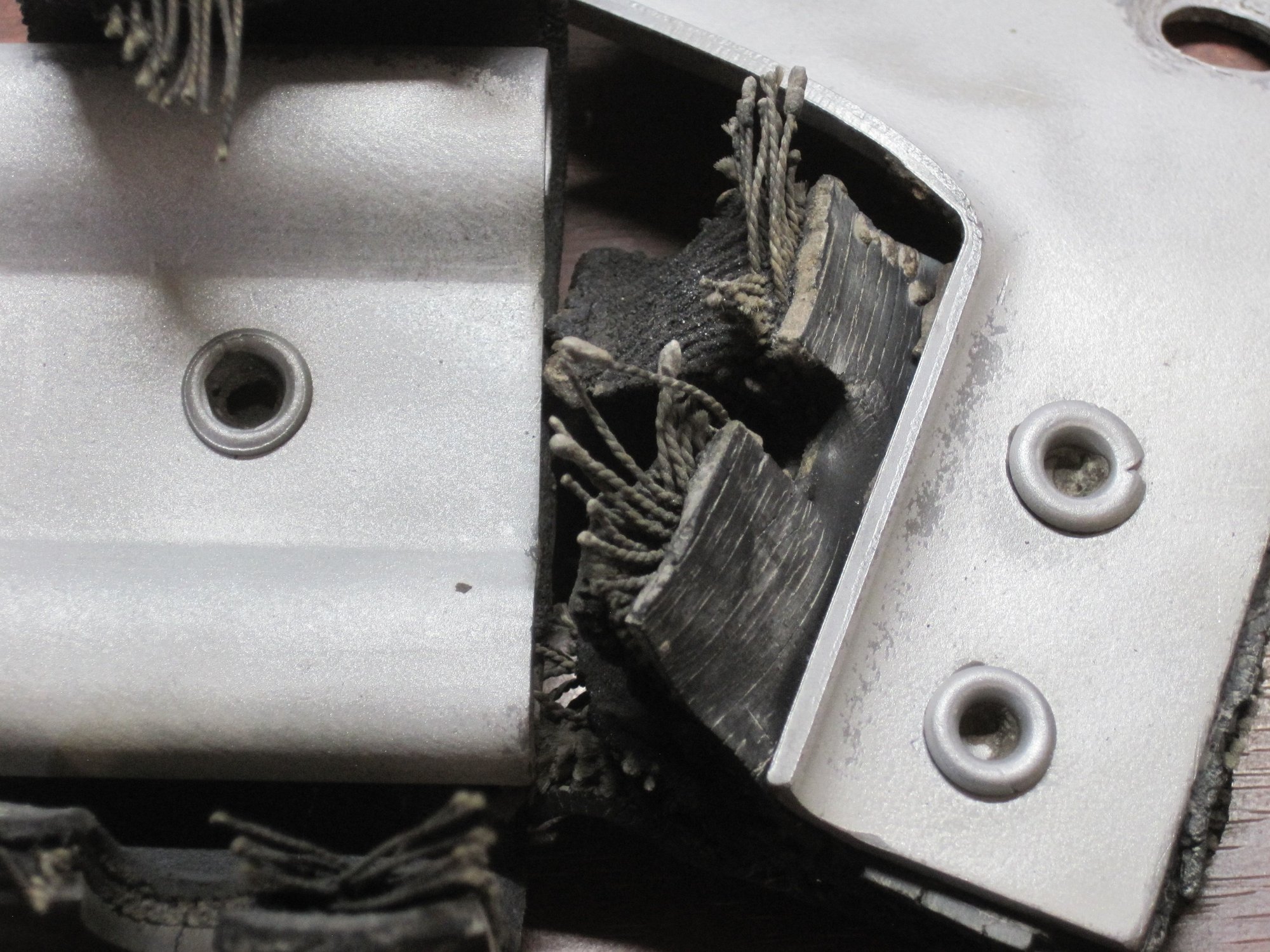

I don't know...The quality looks awesome. It looks very well built.
But, there are a couple of things I am concerned about. The shape of the pad is off. It's kinda close, but I can tell right away it's not correct. The rear edge on the new pad is not vertical. It is rounded and has a slight slope, approaching the slope of the 84 and up pads. The ribbing is also in the wrong location. It is on the top of the pad and about 1/4" from the edge. My original was on the very edge, just about on the corner. The defroster vents fit OK; I just need to trim a little on the edges of the vinyl.
I can't tell right now how well it will fit as the car is too far disassembled. Unless it is too thick, it should fit since it should be my original structure. I wish I would have taken more detailed photos of the old pad.
I am going to reach out to them and see what their response is. BTW, there is another thread on this whole process I am going through here:
https://www.thirdgen.org/forums/inte...tion-just.html
In the meantime, can I ask everyone a favor?

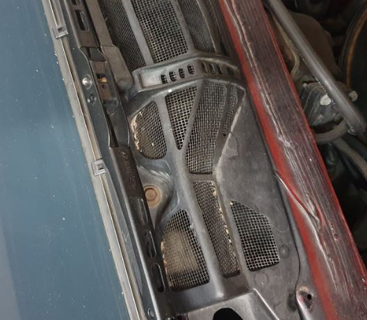

If anyone has time, could you post some pics of the rear edge of your 82-83 pad? One showing a straight edge against it would be great too.

I just got off the phone with Andy at Just Dashes after he called me to address my issues.
They are going to make it right. They will send me a free shipping label to ship the dash back to the them. They will also take care of the return shipping.
I told him how this is being discussed here and that I was hopeful they would take care of me. He made it clear that they take customer service seriously, and so far, I believe it. I am giving them an A+ for the time being. Let's just see if they can get the contours right this time.
Now, I wonder if the repair will be worse than the defect. I would imagine to do it right, they will need to completely strip off the vinyl and foam. I'm sure the vinyl can't be removed without destroying the foam. I hope they don't cut corners and try to reuse the foam.

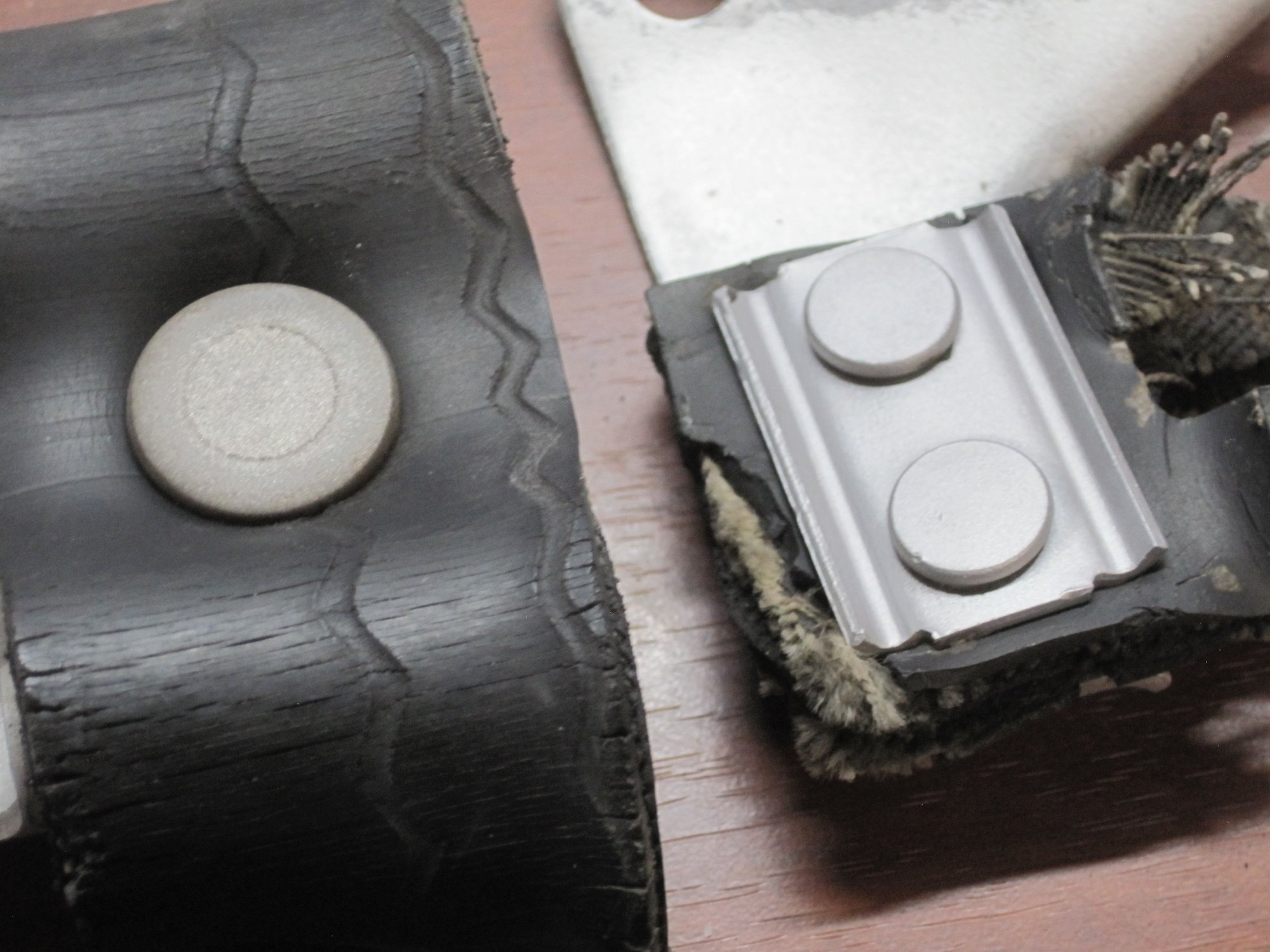

I also noticed that on the underside where the forward mounting screw holes are located, on one side there are two inserts/pads of some sort, the other has none. He said those pads are part of the structure and the broken ones were missed by the estimator. Normally, they would have charged to repair those missing pads but he said they will waive the charges.

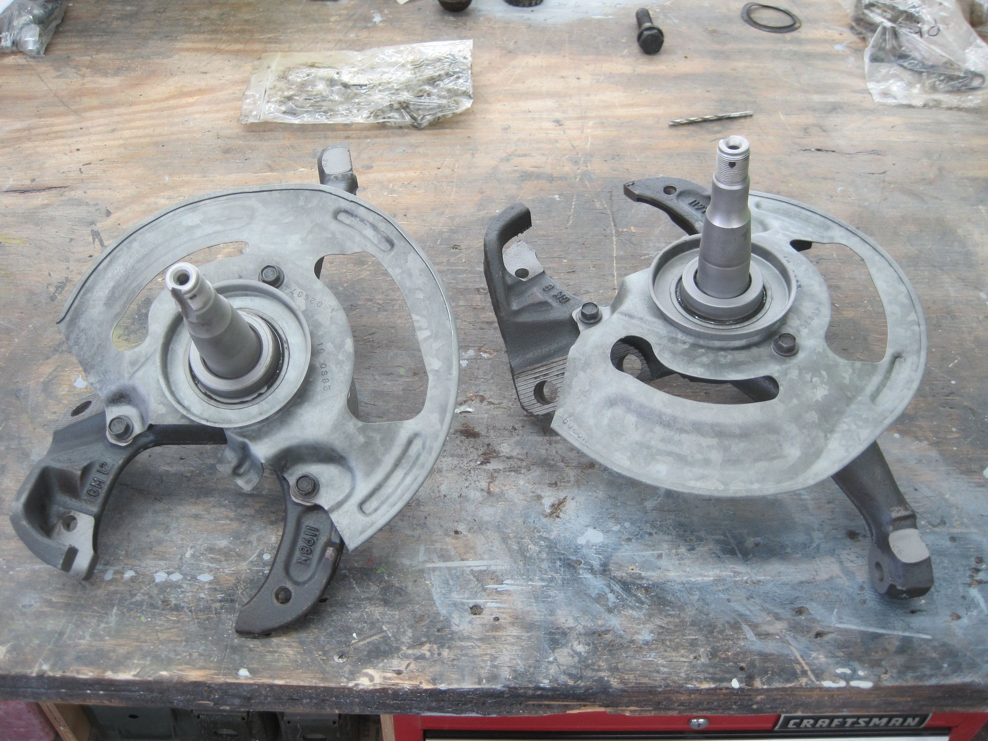

I haven't gotten around to shooting the primer-surfacer on the body or stripping the hatch so I've been cleaning up the hardware. I started on the chassis. Doing the best I can at forensics on the finish, I just spray VHT "Flame Proof" flat black after glass beading them. Anything that appears to have had a zinc finish, I glass bead and shoot VHT satin clear.
Even though I am trying to duplicate the factory assemblies and finishes, I am not going to the extent of perfection. In the case of hardware, the general look is all I am after along with corrosion protection.
Here's a sample:

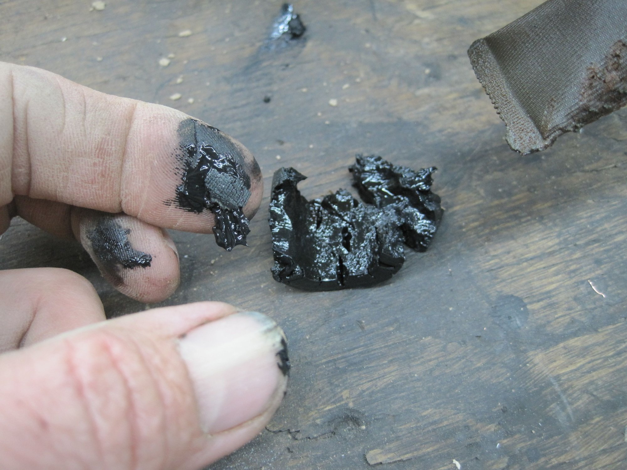

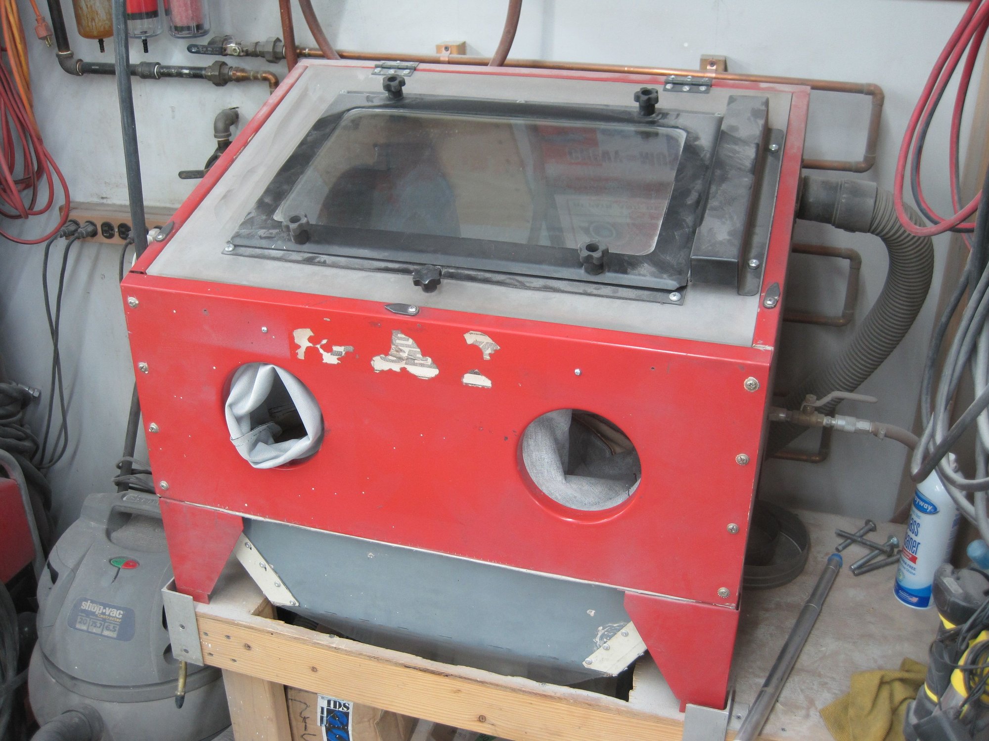

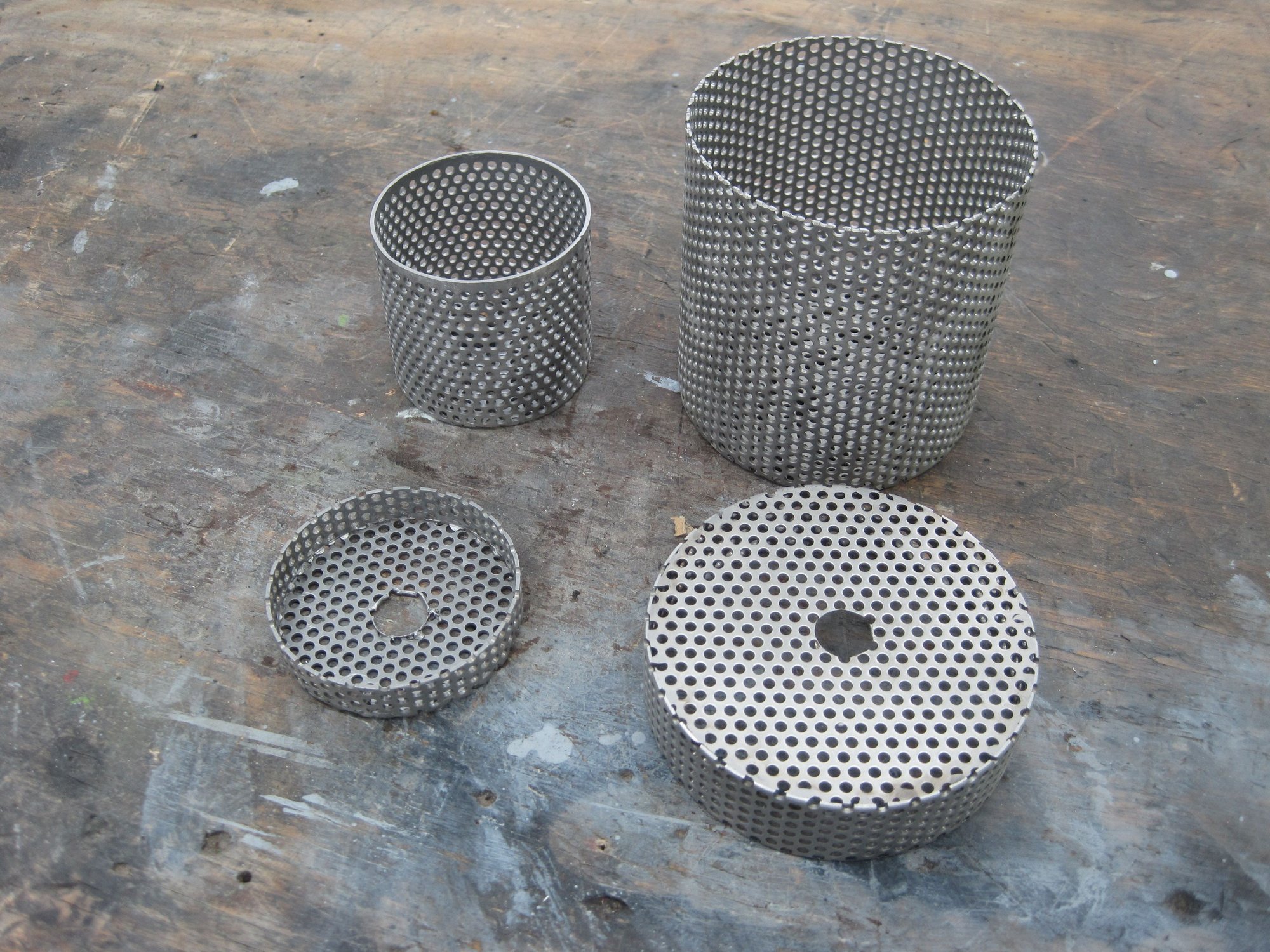

When I started to degrease the spindles I noticed a coating of some sort. It looks like dark gray phosphate, however, it's thick enough to chip. I don't think phosphate does that. I was reasonably careful so the coating survived the glass beading. I simply coated them with clear.
Same with the rotor shields. It looked like some sort of galvanized surface, so I cleared them too after blasting. I didn't have any decent shield seals, so I just applied a little Permatex #2. You can see it squishing out around between the shields and spindles.

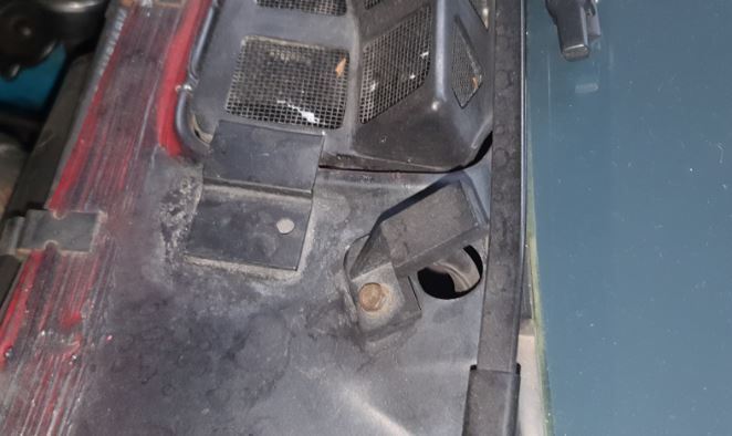

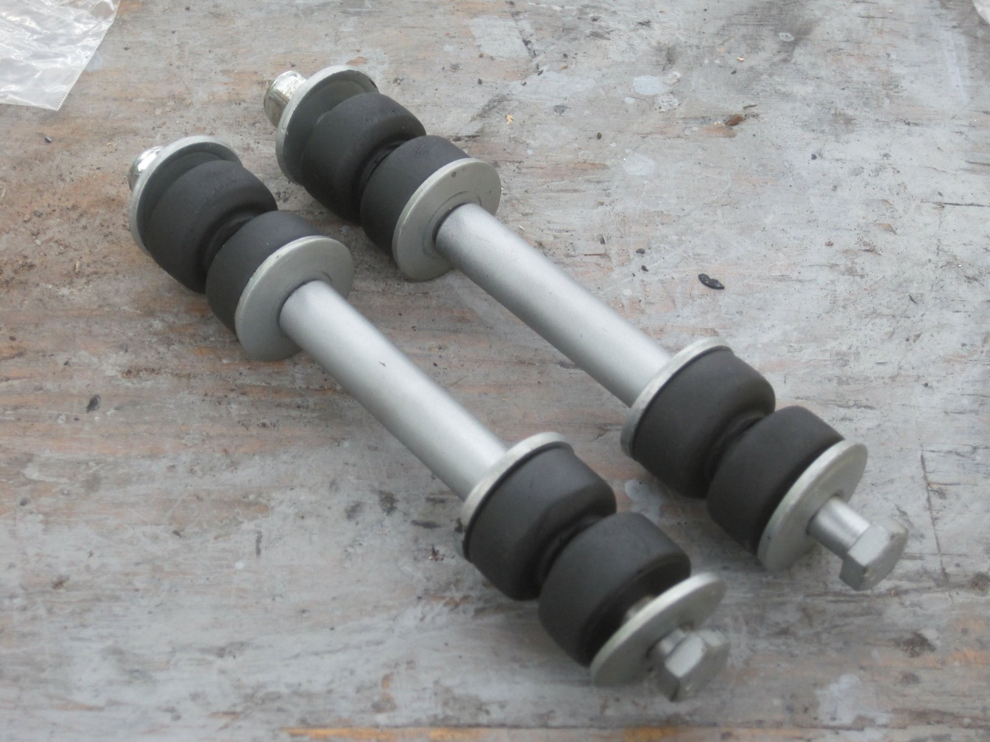

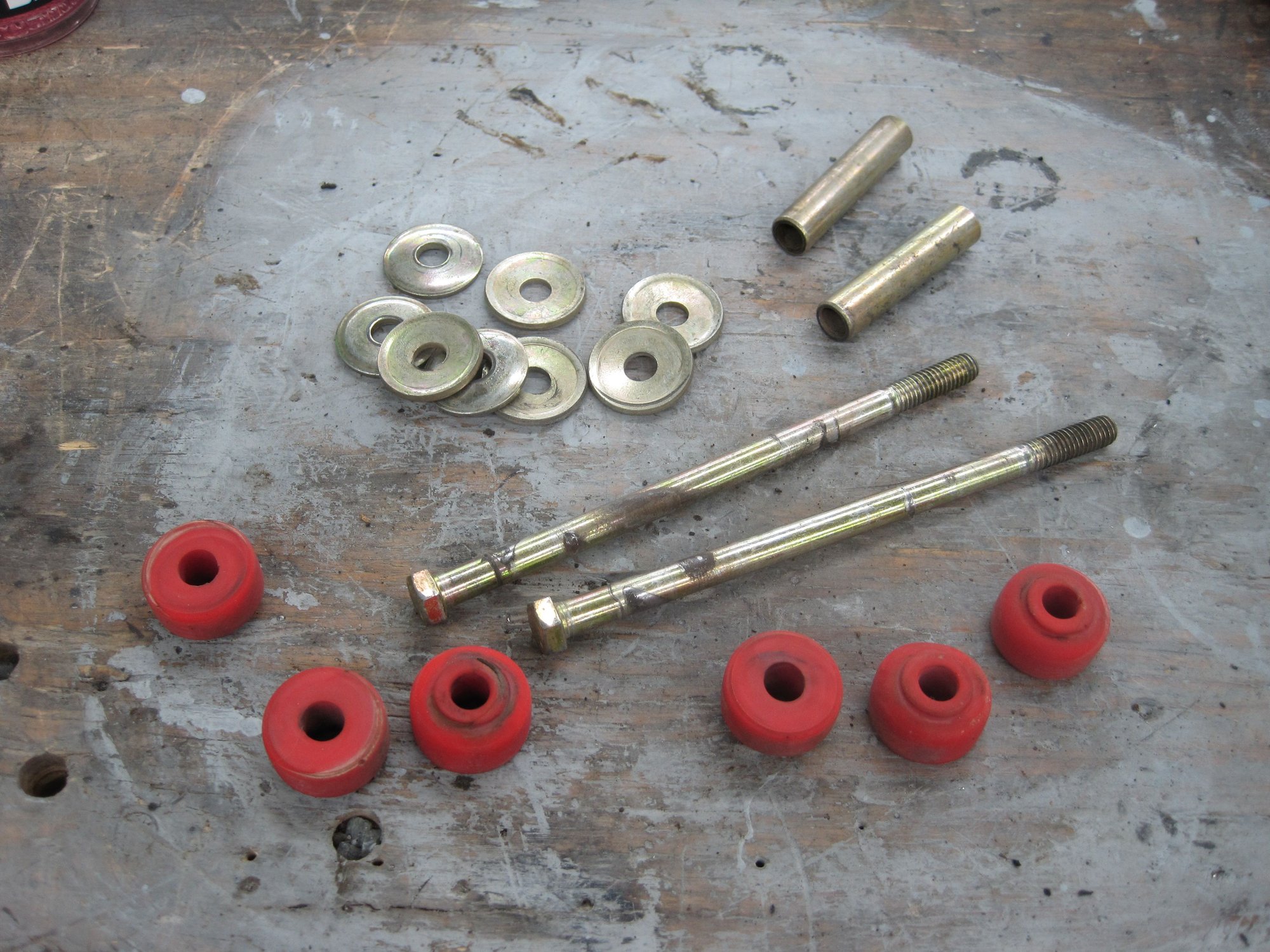

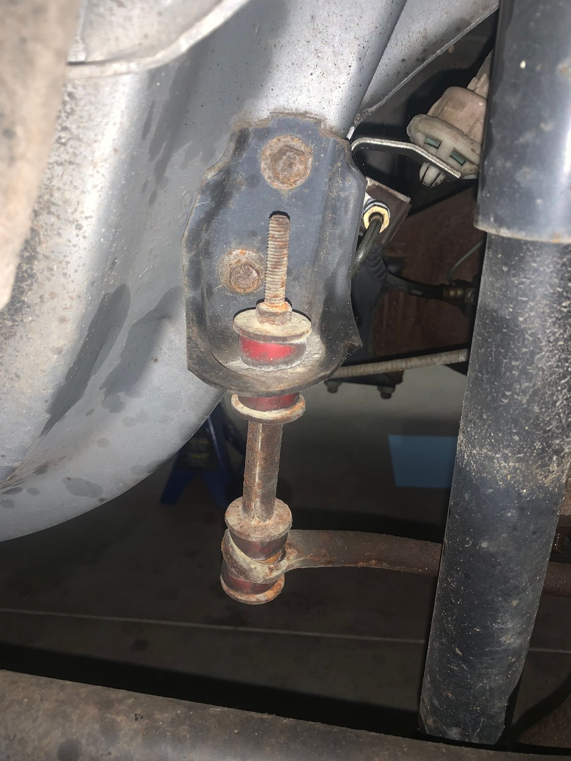

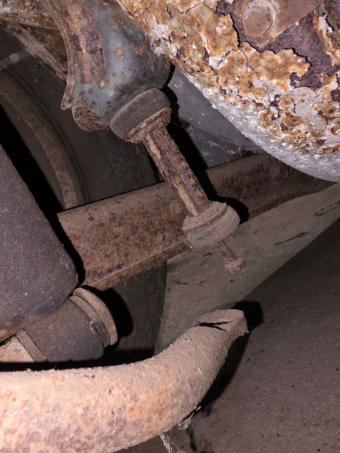

When I started to clean the rear sway bar links I noticed that the bushings and hardware looked like aftermarket poly items. I don't remember changing them. The fronts are still original but useless as the bushings are brittle and they break into pieces. I believe they used a harder compound of unknown material for the Z28's. They definitely weren't using rubber.
Does anybody still have the original rear sway bar link setup on their car? Could you snap a pic or describe what the bushings and hardware look like?
Here is a photo of the rear sway bar end links on my '84 Z28. I'm not the original owner, but these appear to be original. Yours definitely look aftermarket to me.

Yeah, I would have to agree. I just forgot I changed them out at some point. Red bushings and zinc dichromate bolts ain't factory.
Thanks!

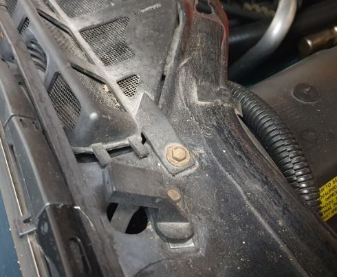

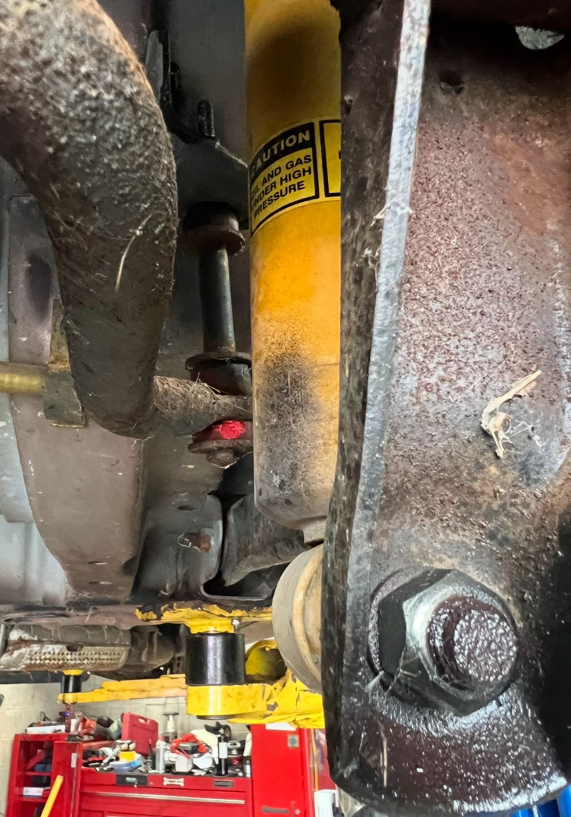

I believe this is the original set up in the1986 Firebird, for the end links.

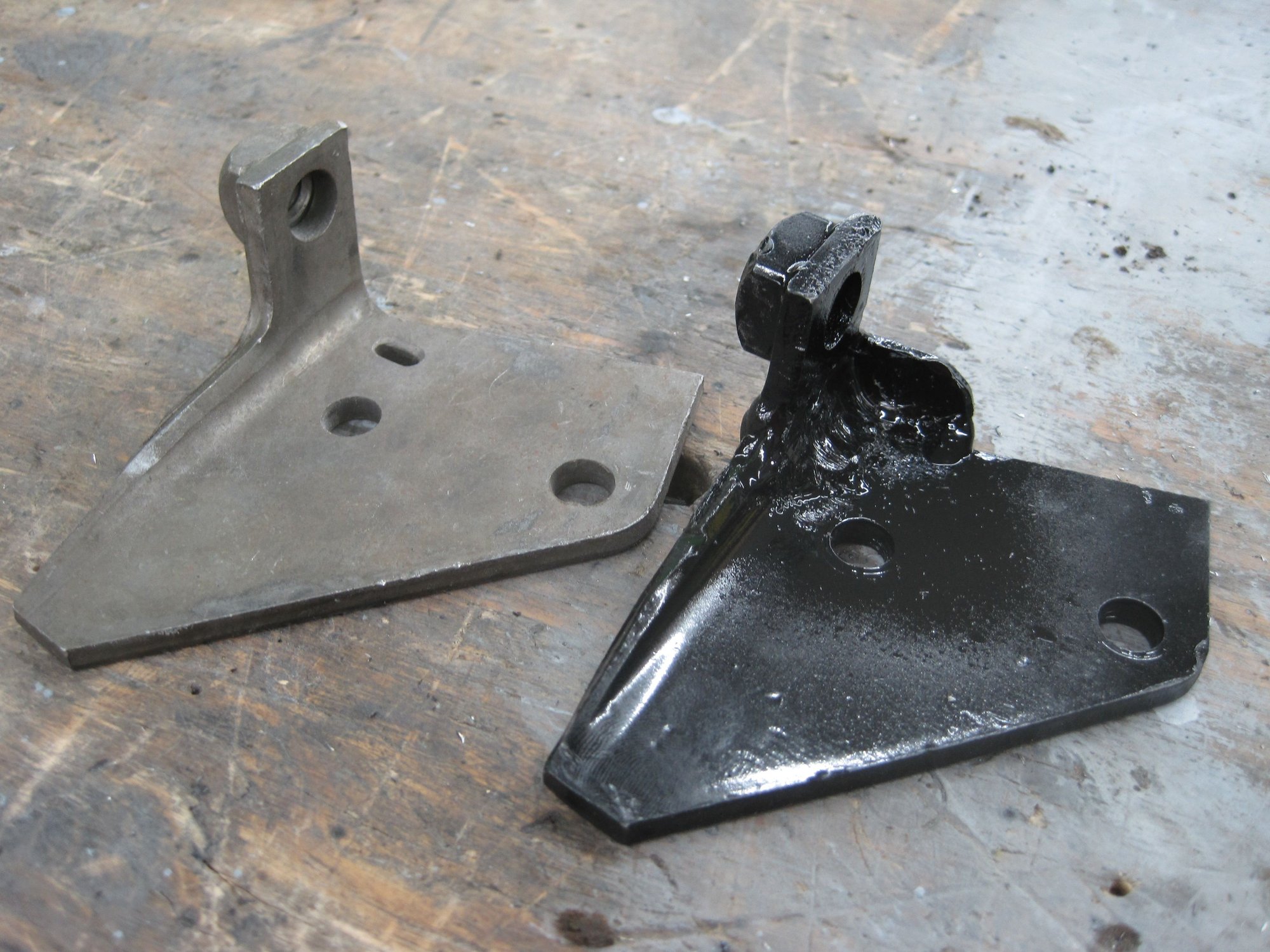

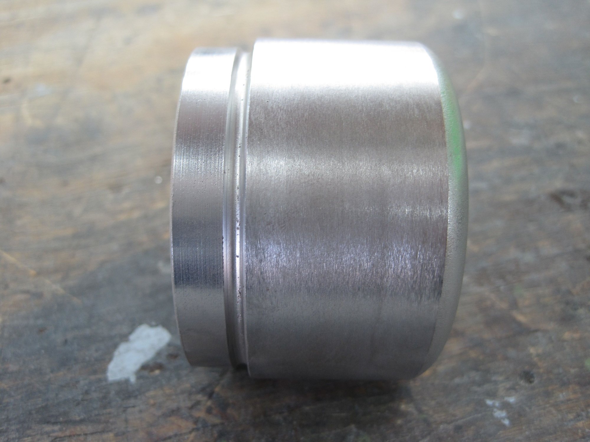

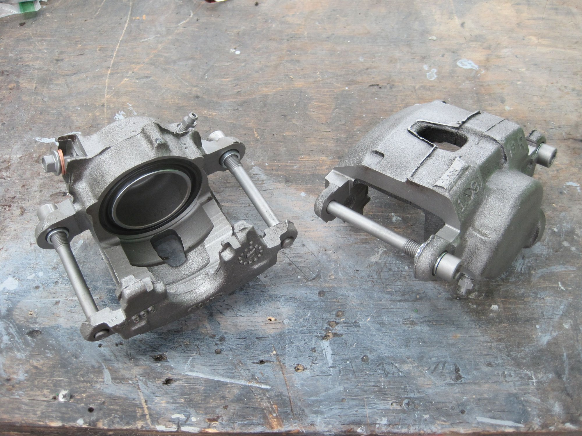

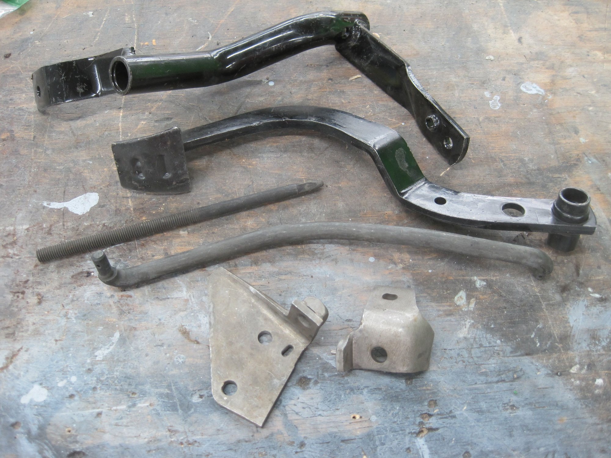

Brake calipers are done. Corrosion on the cylinders was minimal with typical minor pitting. The pistons were in excellent condition. After bead blasting, a little bit of light wire brushing got the seal surfaces very smooth. Using brake assembly lube, I assembled them and then shot a couple coats of clear. I did this after assembly so I wouldn’t have to worry about scratching or rubbing off the clear coat during assembly.

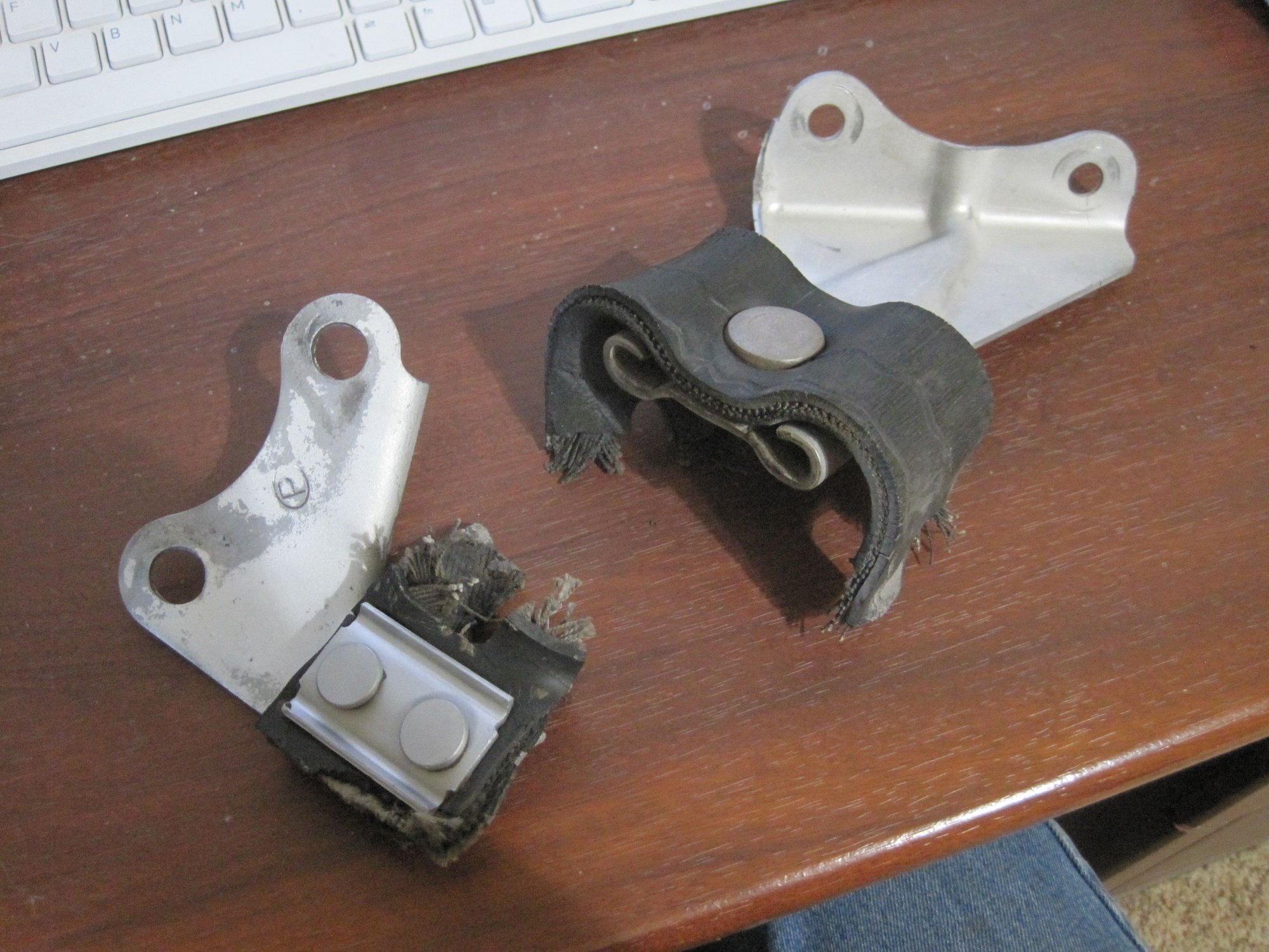

I also rebuilt the clutch Z-bar. Years ago, the tab that the Z-bar bolts to broke off the frame-mounted bracket. I rewelded it and added a small gusset to strengthen it.
I wasn’t sure if I welded the tab back on in the correct position, so a few years later, I found an almost complete NOS Z-bar assembly including the brackets and pedal to verify the repair and to use them in case my repair was off. The repair was good and it’s still holding up so I reused it. The welds are a little sloppy but they are strong. I also remember the rods and holes were wearing a little bit so welded them back to spec years ago. They still look good, so I was also able to reuse everything.
NOS Assembly
NOS Assembly
The rotors couldn't be saved, safely anyway, as they were just under the minimum thickness specs and grooves were wearing into the surface on top of that. I hated having to use aftermarket rotors because in the past, replacement rotors warped too easily. But I have had success so far with buying the best a brand has to offer.

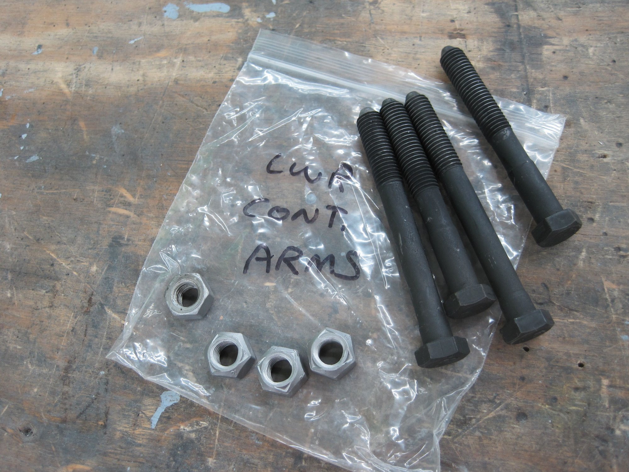

These are a 1985 IROC and 87 IROC both original cars
Those are 100% aftermarket. And the wrong length bolt too.

I bought this car from the original owner and he left the car all original. Maybe Firebird is different than Chevy or on anti sway bar diameters on different handling packages?
No, those are aftermarket sway bar links. And improperly matched hardware like I said before. They are not original GM.
I forgot to mention before, those weren't even tightened down enough for proper bushing "squish". Likely because the long bolts do not have enough threads and the nuts are bottomed out on the shoulder of the bolt.

Interesting. I will see him in the coming weeks and will ask him if he changed anything? I did notice the differential cover had been removed and siliconed back in place so maybe something has changed on the rear end. I thought he had just changed the gear oil.

Here is the possibly original rear links on my '85 and '86 project cars. Both need replacing. The hardware, particularly the washers appear to be identical between the two cars (notice the raised area of the stamping) and appear to be the same as ryguy's '84 and Z28cop's '85. Interestingly, my '86 car shown has brackets that seem to have been coated in a dove gray color, rather than black.
Old Nov 24, 2025 | 07:49 AM
  #224
69-er's Avatar
Joined: Oct 1999
Posts: 640
Likes: 187
From: Alamogordo, NM, USA
Re: 1983 Z28 H.O. Restoration Thread
As corroded those links are, I would agree those are probably original. I'm pretty much convinced, so far, that mine are replacements.
I guess I wasn't very consistent in keep original parts. I never found them in my collection.
I'm not going to go out of my way to find original or NOS links, but it would be nice. Certain things on my build will just have to be incorrect.

On my IROC, I just took them off, soaked them in EvapOrust and repainted the spacers and the bolts. Sometimes (like my 85) the metal
spacers were painted, mine were yellow. I assume from working there, this was done to identify different links for the different cars. A lot of parts had different paint colors to differentiate between models, like the 3 painted stripes in the middle of the drive shafts. Usually you can find a Testors bottle of paint to match many of the clolors.

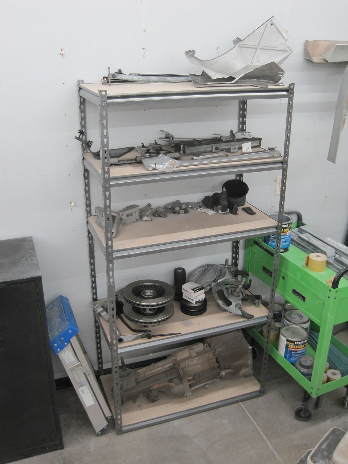

Parts/hardware cleaning and painting is still in progress. After discussing the rear sway bar links with other members, I decided to reuse the existing links since they are in very good condition. Just to make things look a little more factory, I blasted the hardware to remove the dichromate plating and cleared them. I even painted the bushings flat black. The paint doesn't scratch off either.
Here is one storage bin’s worth of body items. Shooting flat spray paint is nice because it dries fast and I can move through the cleaning and paint process quickly. I lay the partially dried items on the parts bag to keep track of them while they dry overnight. The chassis parts are complete.

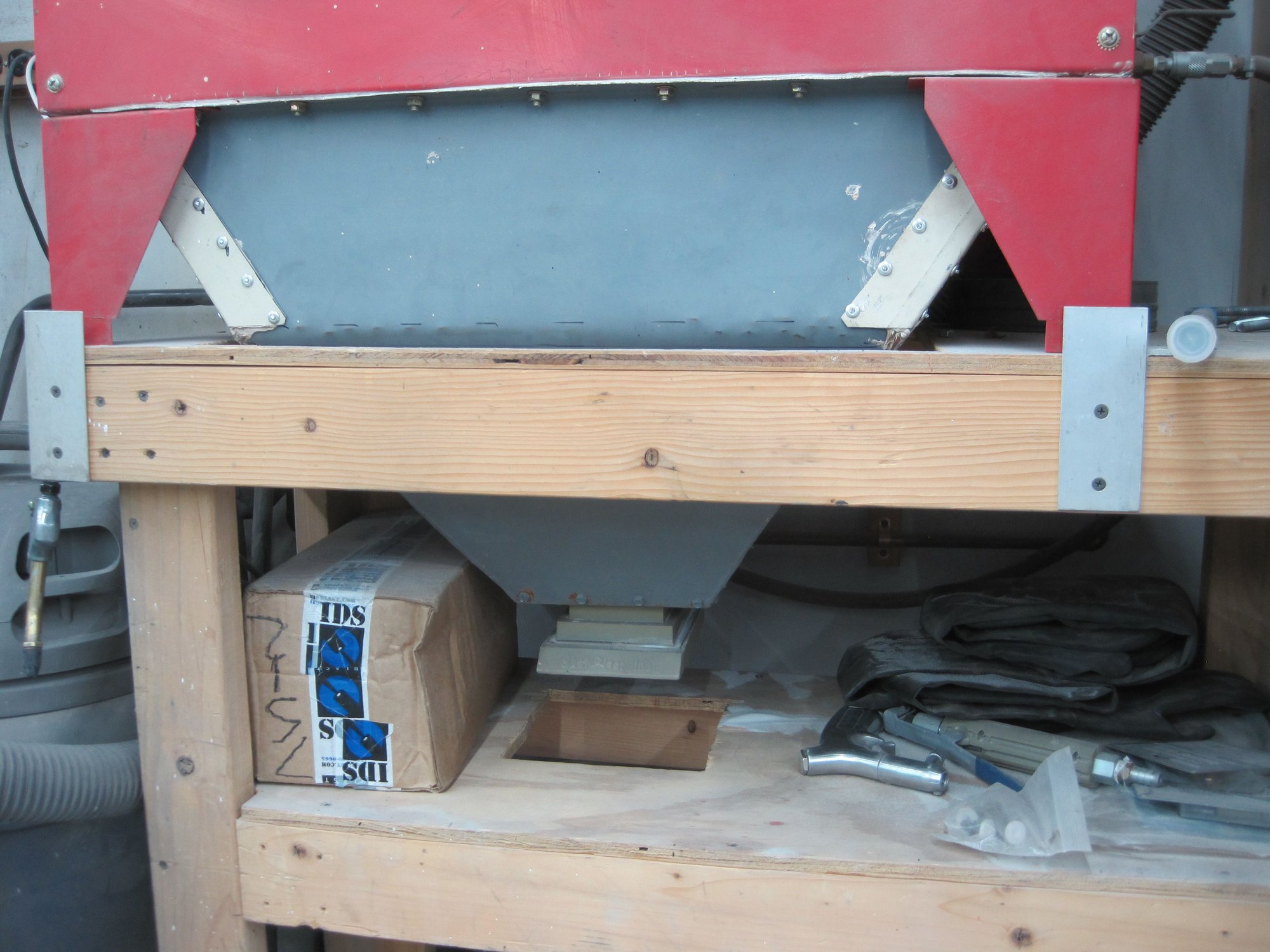

Today, I am back on cleaning and refinishing the various bits and pieces of hardware, brackets, etc.

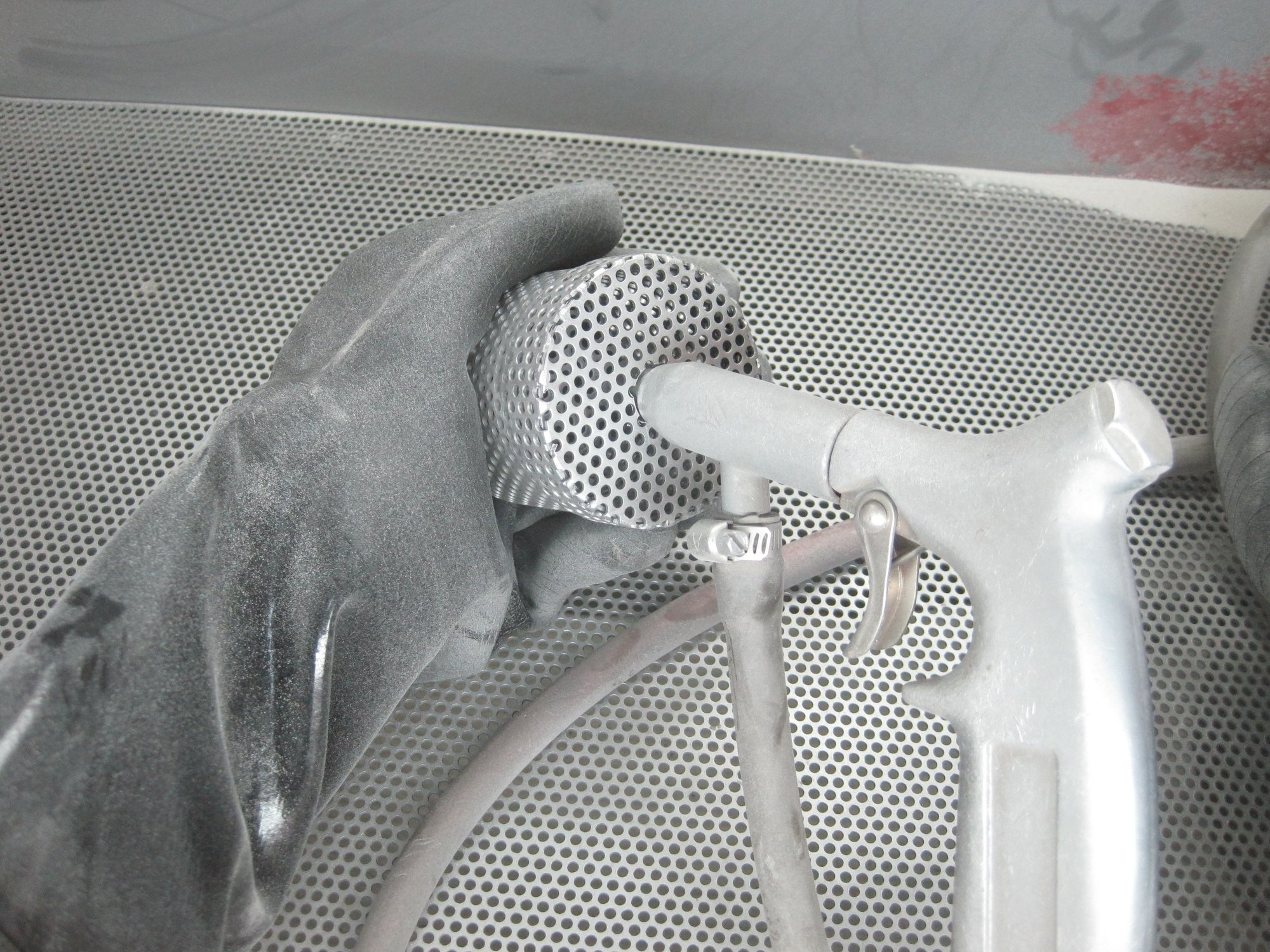

For years, I have struggled with holding small fasteners with the bulky blasting gloves. I knew there were such things as blasting baskets/cages, but I never thought the designs would work all that great. Some were just an open basket, (parts flying everywhere), while some were enclosed. Plus, $30-$100 was too expensive to me IMO.
So I made my own. A few years back, I replaced the lightweight screen floor in my cabinet with perforated metal. It’s about a 20ga with 1/8” holes. I used the leftover material to make my baskets. My modification to the typical designs I saw was to add a hole just large enough to insert the gun’s nozzle. I simply shake the basket for about 30 seconds which usually works for mildly corroded fasteners. I made two sizes. A 2.5” and 4” dia.

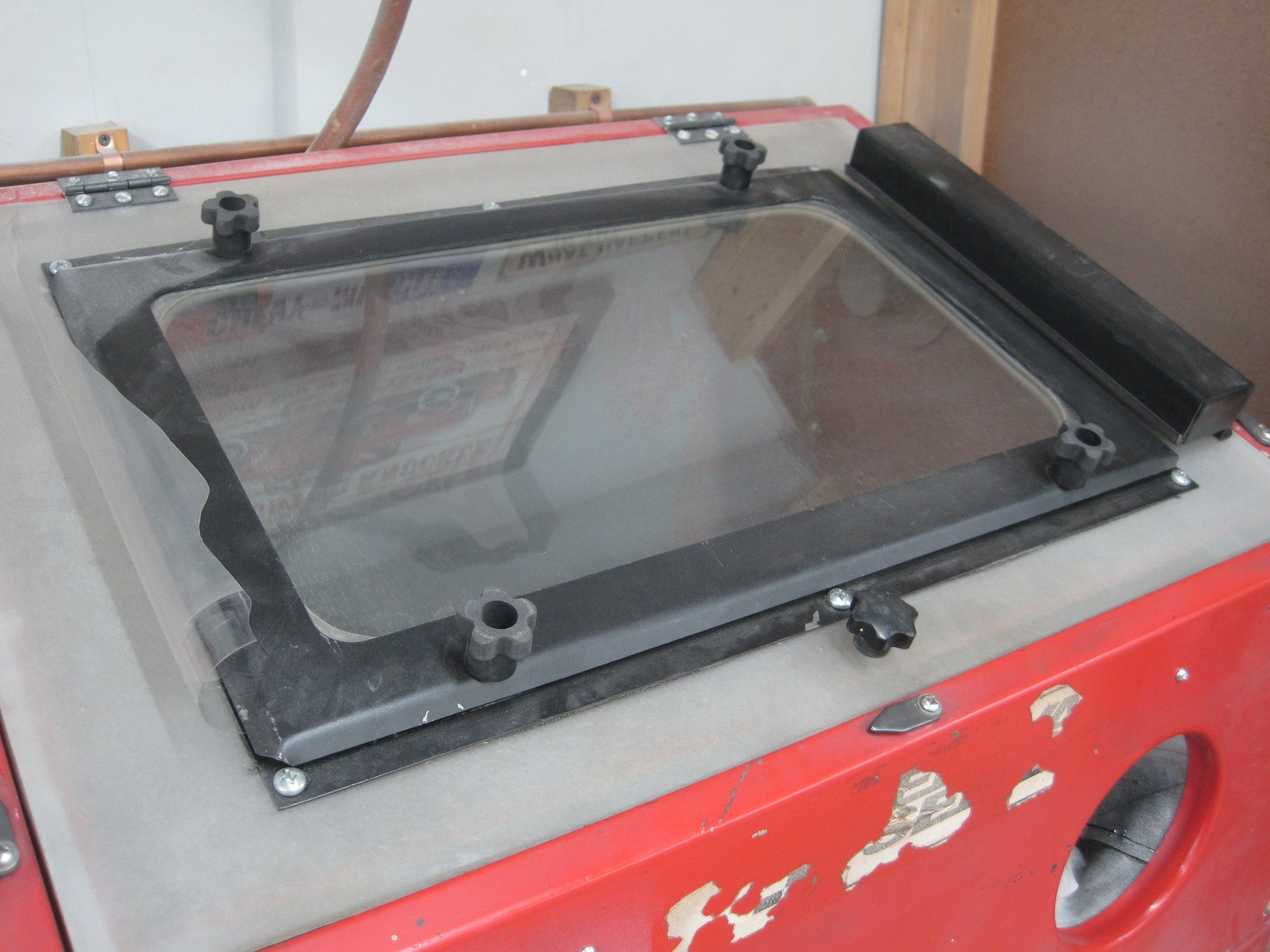

Speaking of blasting cabinets, my cabinet is an old, used benchtop unit similar to an old Harbor Freight design. The hopper wasn’t a very good design as it wasn’t deep enough and too shallow of an angle to allow the media to settle to the bottom where the siphon could pick it up. I built a deeper one with a spring-loaded trap door.
I also went to “Blast-it-All” and got one of their window conversion kits. It’s so much easier now to just pull the mylar underlay from a dispenser instead of taping a new sheet to the window pane.

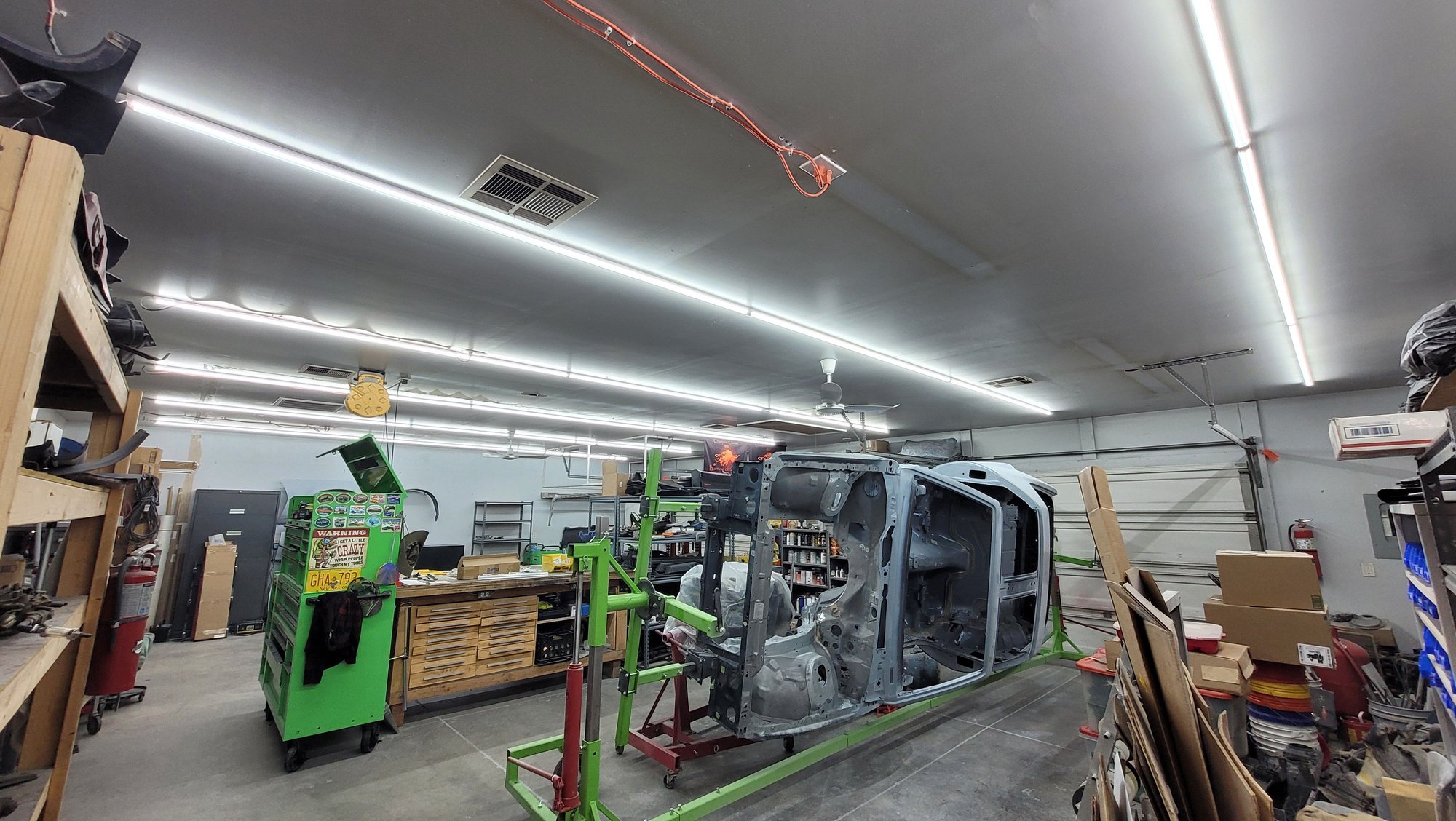

I also upgraded the lighting. It originally came with a fluorescent tube fixture which wasn’t very bright. I tried different variations of LED strip lighting. That worked OK until the silicone covering the LEDs got blasted into a brown, almost opaque surface.
I now have a couple of 24” “Barrina” brand LED fixtures. Waaay better. I left on the thin, protective plastic covering the lens, hoping it will take the brunt of the blasting effects. When that gets too frosted, I’ll try some Saran wrap or the sticky version of it. We’ll see how far this setup will last.
They are the same lights I recently installed in my shop, except they are 8’ long. When I first built the shop 18 years ago, the 4500K fluorescent lights seemed like daylight! When those seemed to dim, I went with 6500K. Even better! Then those seemed not to be white/bright enough. I guess my eyes aren’t what they used to be...

What we found that worked best was to cut a hole in the cabinet and slide a piece of plexiglass over the hole, then place the fixtures on the outside where it's clean. When the plexiglass gets pitted simply slide a new piece in and you don't waste light fixtures. That's if you have enough room in the top. We used this method on a welding booth.

Yeah, I thought about doing that but, like you said, space is at a premium. Maybe one day I'll just bite the bullet and get "Real" cabinet!

I have an older harbor freight blasting cabinet that has worked well enough but i did have to upgrade the lighting to LED also. I've found using walnut shells does a good job of cleaning parts without striping the original finish.

Here’s a quick question. I noticed this years ago:
The cowl screen has three screw holes to secure it to the body. Mine only had one screw in the middle. The two on the ends were never installed and drilled into the sheet metal. It has Christmas tree fasteners to help hold it down, so it never really was a problem. The passenger side wouldn't be to able lay flat very well because of the ridge around the perimeter of the hole. The driver's side has a jog in it to conform to the shape of the rim.
How are the screens secured on everyone’s cars?

On my 82 TA there is one screw on the passenger side and one in the middle. the drivers side does not have a screw.

I've seen a screw in the passenger side cowl screen tang on some '82 F-bodies but they were Norwood built cars. My Van
Nuys '82 and '84 cars only have the one screw in the center.
GM eventually removed the right tang on the cowl screen in the late 80's. It might have been around the time the windshield
sprayers moved from the the cowl to the wiper arm.

Ah, forgot about the possible differences between the two plants. Mine's a Van Nuys.

1984 Norwood Built One Screw In Center Only

Once again, so much for my theories of factory assembly differences!

Not much to report… All the hardware is pretty much cleaned and painted. Now cleaning larger parts.

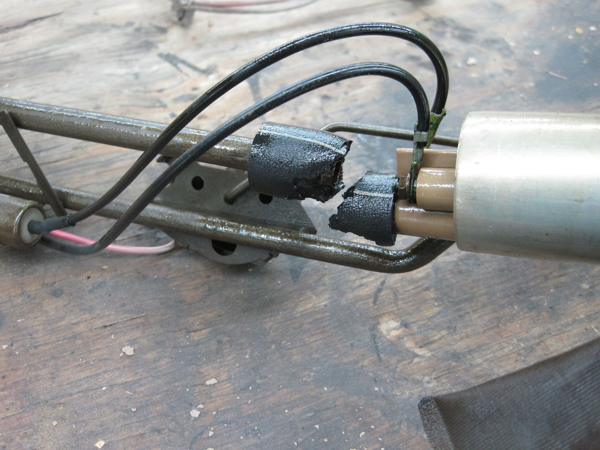

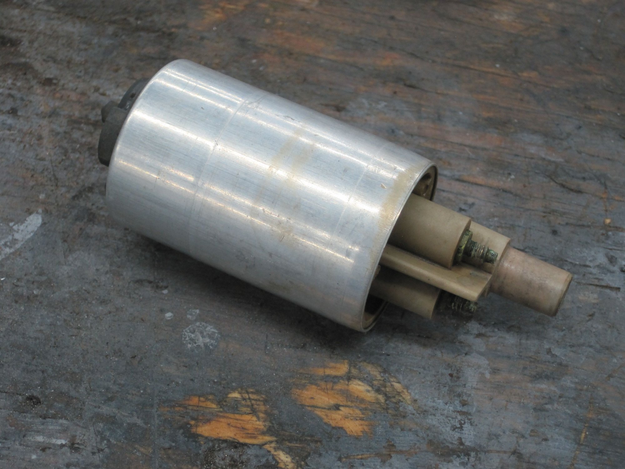

At the moment, I am cleaning up the fuel pickup/sender. The gas gauge was working when the car was running so the sender should be good enough. I might see if I can find a basic assembly with a 90 ohm sender and install just the sender just for a peace of mind. The short rubber hose that connects the fuel pump to the tubing and the sock was wasted away. Modern fuels for ya.
This car had the fuel percolation bulletin installed. However, the fuel pump is inop. Since the car’s wiring for the bulletin is still intact along with the pickup assembly, I figured I might as well keep everything operating as designed. A little pressure in the supply line can’t hurt to help with any possible vapor lock problems that might occur.
Trouble is, the pump is inop. I’m not having any luck in finding a replacement pump or even something similar. The number stamped on the case is A1774.
Any ideas?

Found one! I just stumbled across this on eBay, even after searching for it earlier. Just have to use the right search terms.

Now, I need to figure out how to repair one of the exhaust pipe hangers. This is the one that mounts to the catalytic converter. I never could quite figure out why it broke. The system has been hanging just fine for years using the remaining two hangers at the rear so it's not like it was under that much of a load. I think the heat may have weakened the rubber over time.
I found a company that provides fabric-reinforced rubber. They don't have all the correct widths, so I'll just use my band saw to cut them to size. If that makes too rough of a cut, I suppose a sharp blade will do the trick. (All four of the reproduction hangers on my 69 broke after just 2 years and 4,000 miles. I got enough to repair those too).
Now, I just have to find suitable hollow rivets. I'm having trouble finding a 5/16" rivet with a ~15/16" diameter head.
