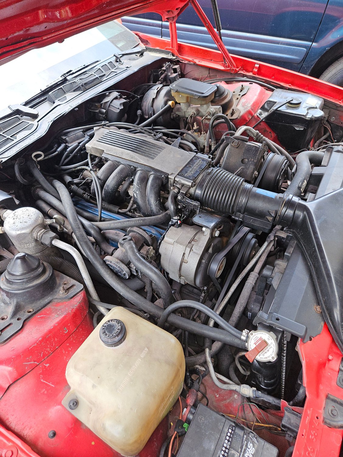

1985-86 type alternator on that engine.

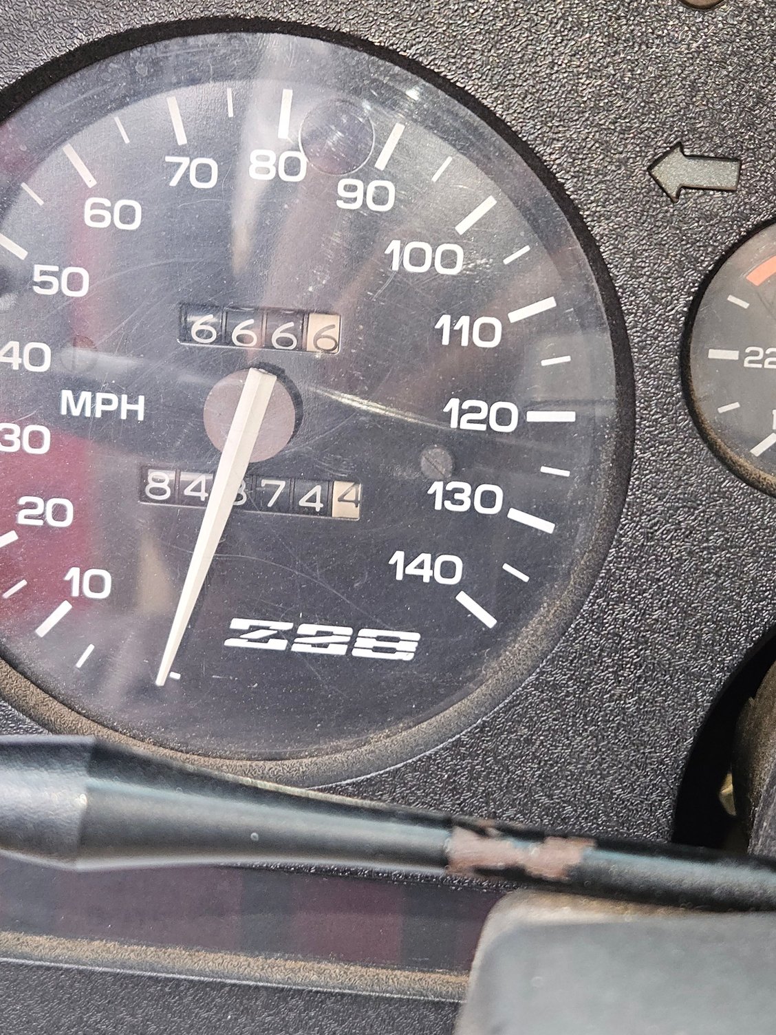

That's a dealer installed speedo.

That's not the original speedo, so mileage is suspect.

Definitely not the stock speedo.

That is the earlier version of the "off road"140 speedo.Hard to say what the engine is at this point in time.Car is certainly not "investment grade"example,but does look pretty decent for something that has been messed with a little Look for hidden rust or hard accident damage.

pretty sure it's stock speedo
IT'S NOT.
It's a "dealer installed" package. The car DID NOT come from the factory that way (would have been illegal that year), butt was a package that could be ordered and the stealership could install, for applications such as police use. All it is, is the speedo scale. All the mechanical stuff is the same; the # of degrees of pointer movement from, say, 0 to 70, is the same as stock; just, it doesn't have a stop to keep the pointer from going past 85, and has more numbers printed on it. Can be swapped out in less than 10 minutes. Pop the cluster bezel off, 2 screws, reverse that, down the road.
Not that it makes a YYYYYUUUUUUUUUJJJJJJJJJJJE difference to the issue at hand; other than, absolute accuracy.

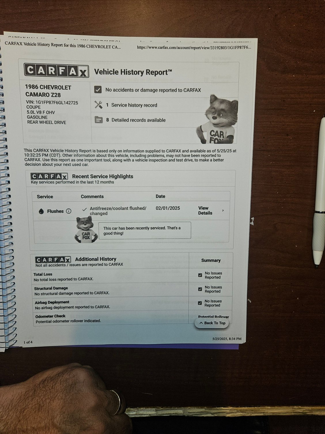

I was able to run a carfax report and car came back as 1986 Z28...What's that do to the car now.
Old May 27, 2025 | 08:10 PM
JohnFB's Avatar
Joined: Mar 2015
Posts: 123
Likes: 17
From: Somers, NY
Car: 1987 IROC-Z
Engine: 5.0L TPI LB9
Transmission: 5-speed manual (T5)
Axle/Gears: 3.45 POSI
Re: 1988 Camaro IROC
The VIN in the Carfax report doesn't match the RPO code decal you posted above. Does the VIN at the bottom of the windshield match the RPO code decal?

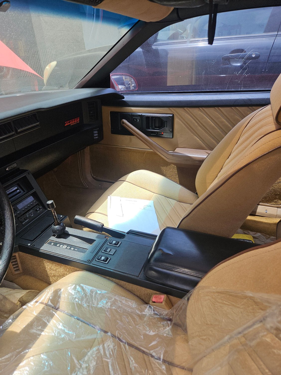

I didnt even notice that, they might have put a new console lid on this car. The vin I ran was on the windshield..Do you know if this is even the correct motor for car?
Old May 27, 2025 | 08:47 PM
chazman's Avatar
Posts: 9,941
Likes: 641
From: Chicagoland
Transmission: World Class T-5
Axle/Gears: BW 3.45
The interior you posted is an '87 only interior. The VIN on the Carfax has the 8th digit as "F" which means LB9. It seems this car has some secrets.

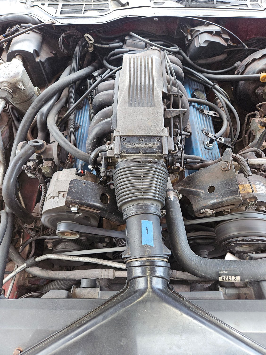

I suspected 86 because of the engine pictures: no heater control valve and type of alternator.
Centerbolt valve covers are 87+, but they could've been added to 86 heads with adapters, or the heads have been changed, or the engine has been swapped.
3rd brake light on the hatch is an 86-only feature. And the VIN you ran shows the engine type is correct: F. But the VIN on the SPID label also shows engine F.
People are saying it has an 87 interior, so maybe the SPID label belongs to the car that was used for the interior swap.
What's the VIN on the door jamb label?
There's a partial VIN on the front of the block atop the passenger side WP mount. And there's a partial VIN on the firewall half hidden by the AC box.

The washer pump is on the wiper motor cover, they moved to the solvent bottle in '88. You can also take the spart tire cover off and there should be a VIN sticker on the quarter panel closer to the front, but still visible with a flashlight. There's one on the other side to but is a bit tricker to get to. There should be a VIN sticker on the underside of the hatch as well.
