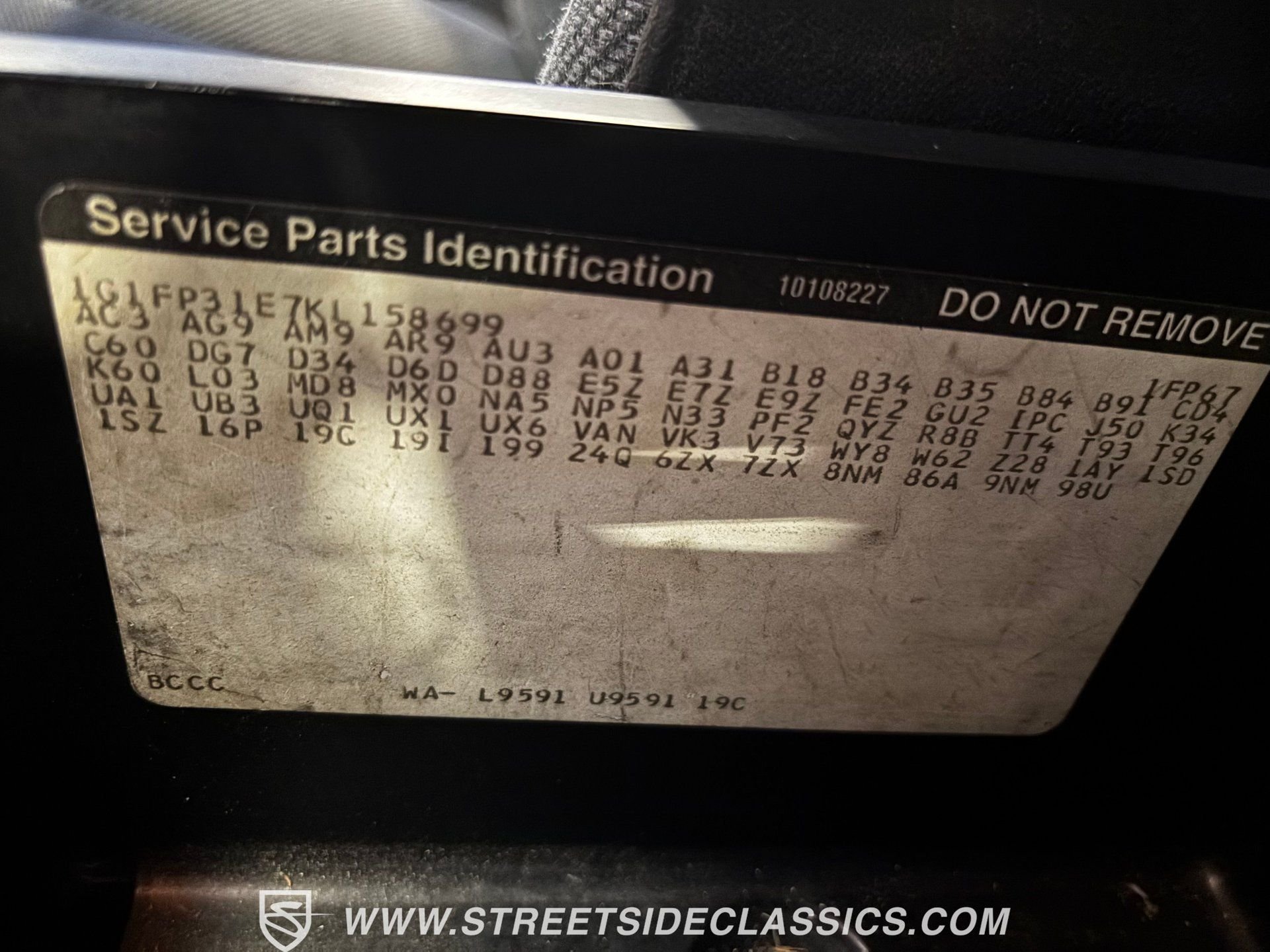

Here is the SPID for this Iroc from their website.

It's a real IROC, with a horrible repaint, decals in the wrong locations, things like steering wheel, shifter, etc, are not original. It also has the worst powertrain possible for the year - L03 and auto. If it at least it were a 5 speed, you'd have that and 3.08 gears.
I might be interested at 10-12K.

I'm surprised at some of these responses calling this a non-IROC and whatever. So it looks like we need to go over some of the basics again.
All Z28s from 1988-1990 model years have the IROC-Z suspension and appearance package
The IROC-Z is the top of the line 3rd gen Camaro. Especially in the 1985-1987 model years, as it was an optional package on top of the Z28.
*All* IROC-Zs have the Z28 RPO code. The 1985-'87 model years will require B4Z, otherwise, it's a Z28.
The Z28 didn't go away from 1988-1990 as ALL IROC-Z cars still require the Z28 RPO designation, and some badging still calls out Z28
The IROC-Z was available with the base LG4 in the early years and L03 in the later years.
The IROC-Z usually comes with 16" wheels, however, starting in 1988, 15" IROC-Z and standard Z28 wheels were available.
Problems with this car:
incorrect paint, nasty exhaust, incorrect door decal placement, not wrong, but a replacement steering wheel, cheap replacement emblems with incorrect font on exterior, cheap replacement parking lights/turn signals
